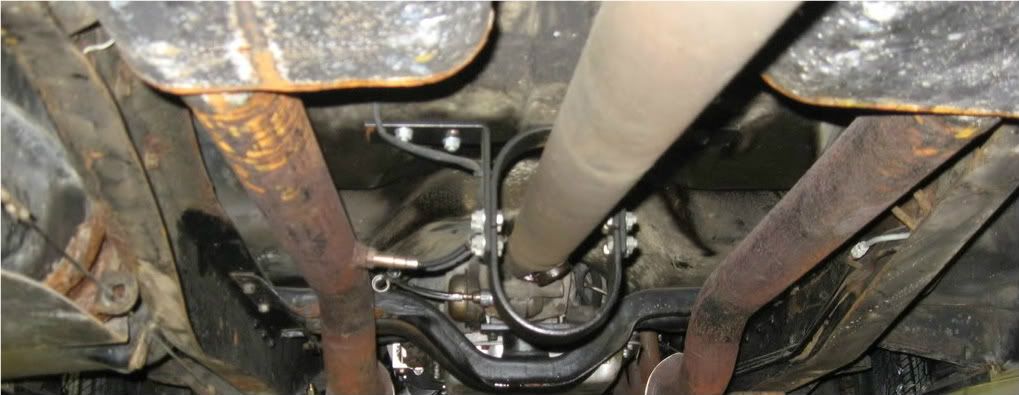

Not a custom part, but does the job. It's from an old ('73-'74) 1 ton. It was a creeper gear 4 speed truck. Lorne

Huh, something to look into, would definatly be strong enough.
I really like the driveshaft saftey loop. Guess you need it when your picking the front wheels up. HA love the avatar!
I was planning on putting one under there sometime soon, Your photo reminded me.
Dont plan on launching that hard, but I had a rear u-joint break on my Jeep just leaving a stop light and I thought it was going to come through the floor.
