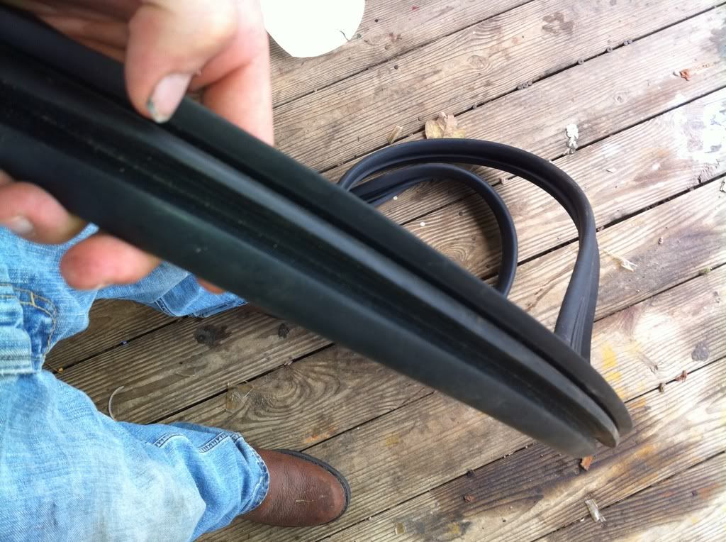

Ok I've had 5 different windshield seals sent to me and all of then wrong... Same part number from precision glass. I have an 83 cab with 77 windshield... The 77 had a regular plain seal and the 83 I'm not sure (no windshield when I bought it) I ordered a regular non strip lock seal but it looks nothing like what came off my truck and is about 5 " longer than the glass and cab (it overlaps by about 3" when u put it on the cab) anyone ran into this? I've been trying to put a windshield in it for 6 weeks now....

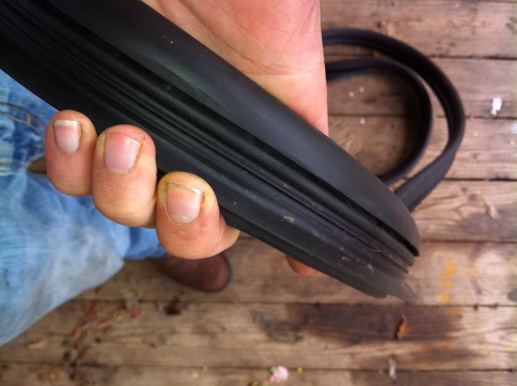

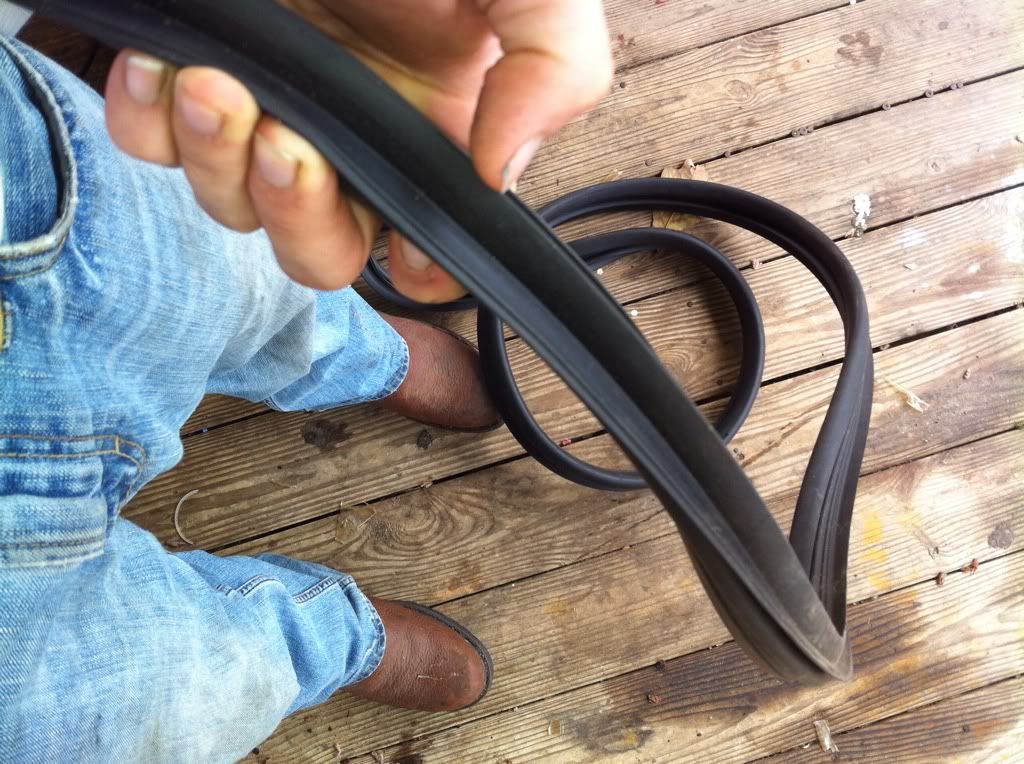

« Reply #4 on: October 14, 2012, 03:30:49 pm »
That's currently what I have to work with. Anyone used one like that?
