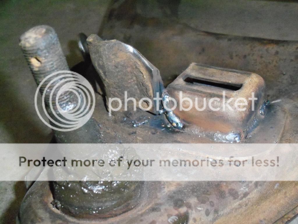

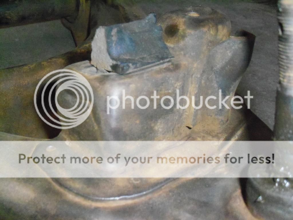

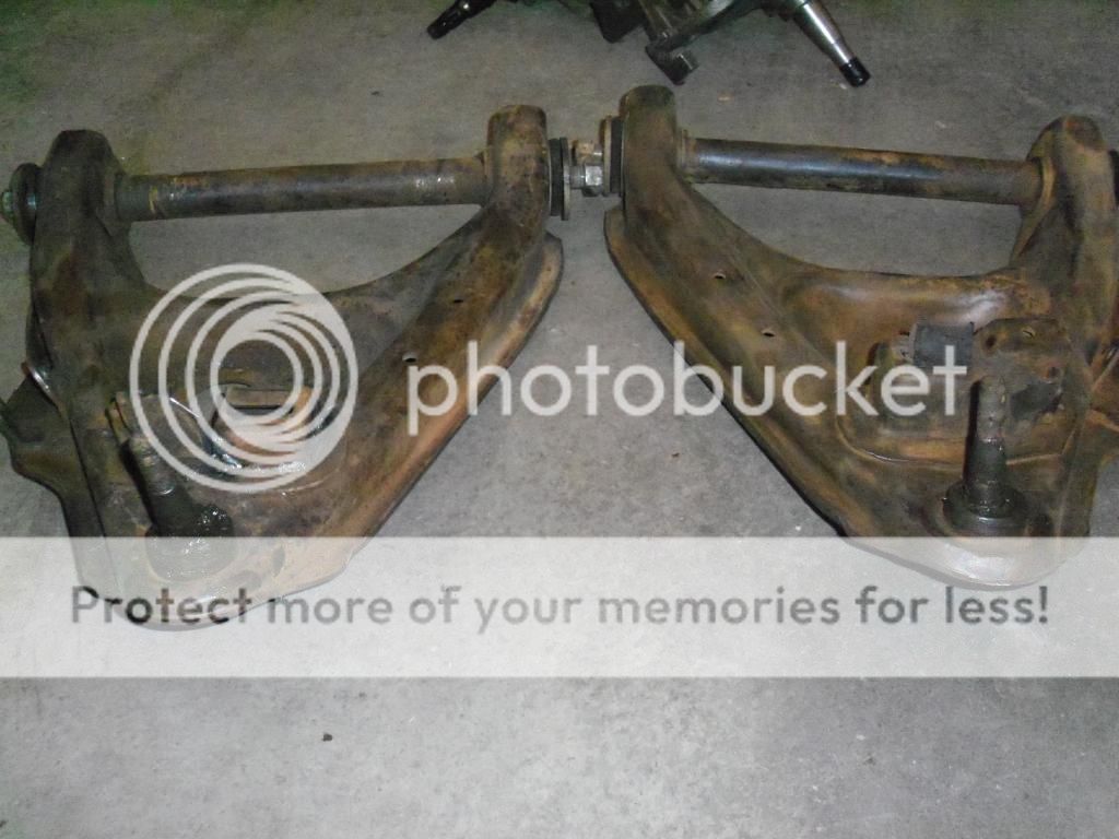

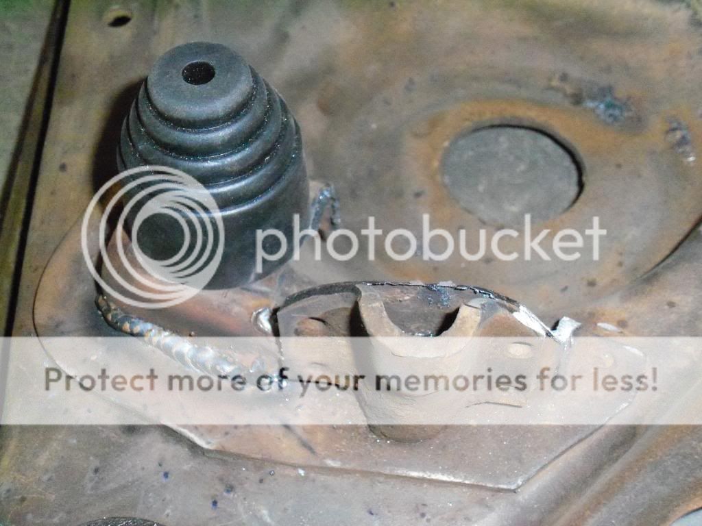

Okay, here's what I did today.
Knowing that in a last ditch effort, I could always just cut the entire factory bumpstop off, I decided to modify what was there first.  I went ahead and first cut around all but the factory steering stop portion, then tried to just screw on my studded bumpstop, but the steering stop was still the high spot.  I decided to build up a perch for the bumpstop using part of what I cut off.  I still need to notch the back of the steering stop slightly, but I doubt I'll have any interference.  I went ahead and mounted the LCA to the truck and the bumpstop right now is still hitting before the steering stop.  I think these will work.
Also, I can cut 1/4" sections off the bumpstops as needed now.  Let me know what you think!
Factory:

Side by side:
With bumpstop:
Re: 84 C10 lowering questions
« Reply #13 on: October 30, 2012, 09:52:46 pm »
That will work...  If it is too high, just mount it to the lower control arm directly.
