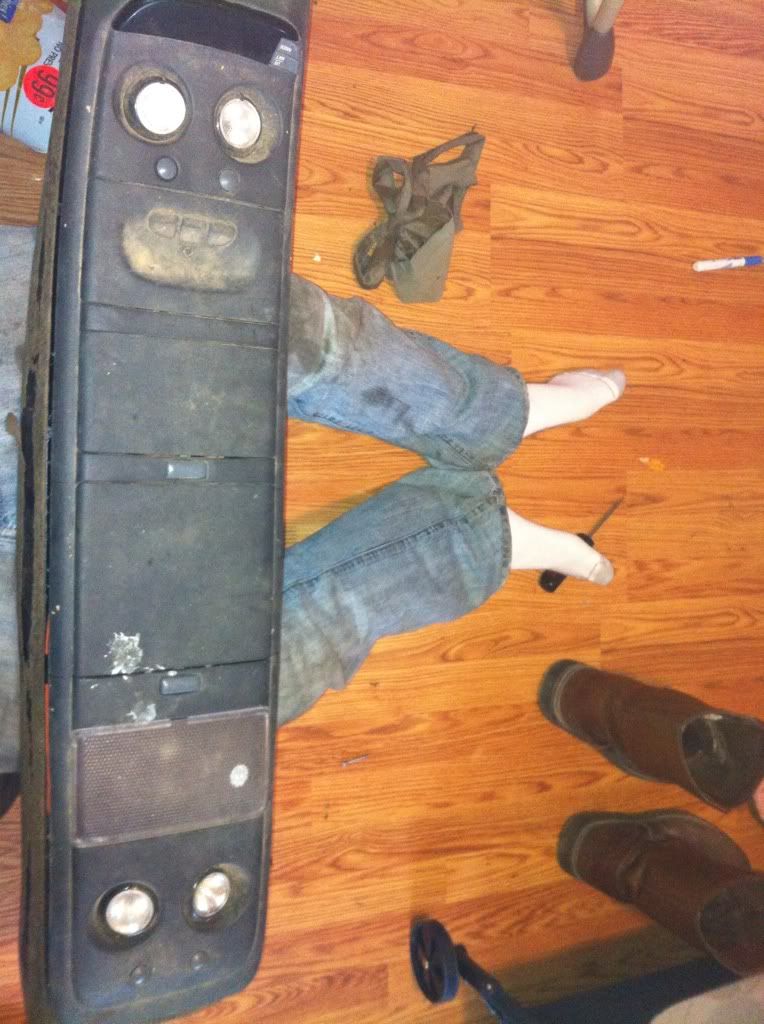

Going to attempt to put upper console out of a 98 blazer in my truck. Why? I like the lights and fancy temp and compass haha :) a buddy gave me the console so why not?
Got it home and figured out the wiring
It works!
Full size ( too long)

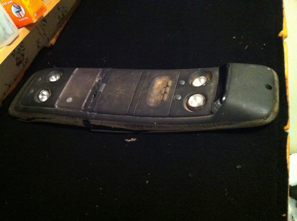

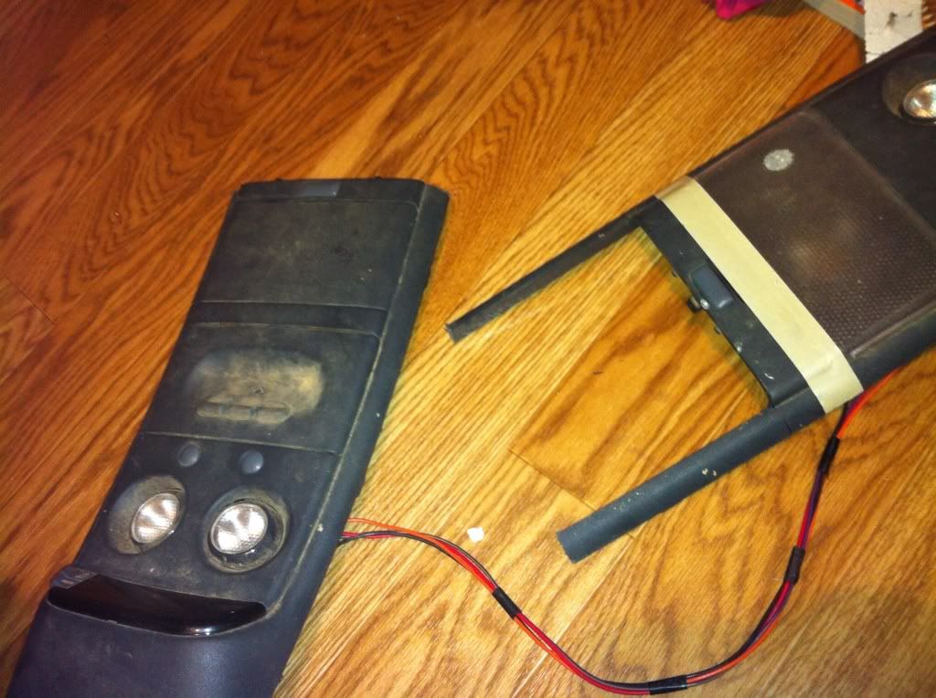

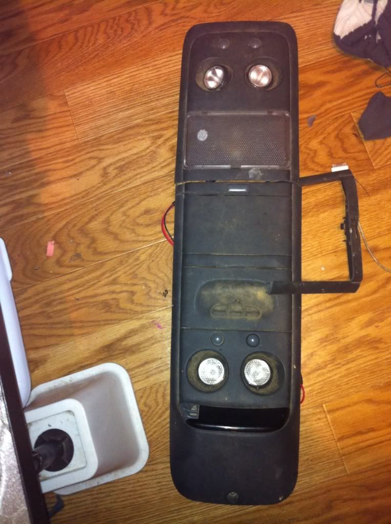

I like the look and lights on this one so I'm going to shorten it and use it.  Removing the cd holder part
Finished cutting out section on top panel, this is what it'll look like

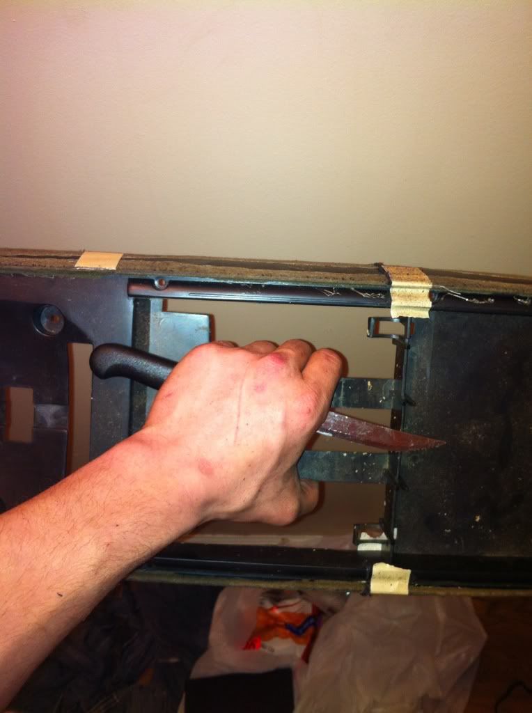

Getting bottom panel ready (wife's steak knife set helped out haha)

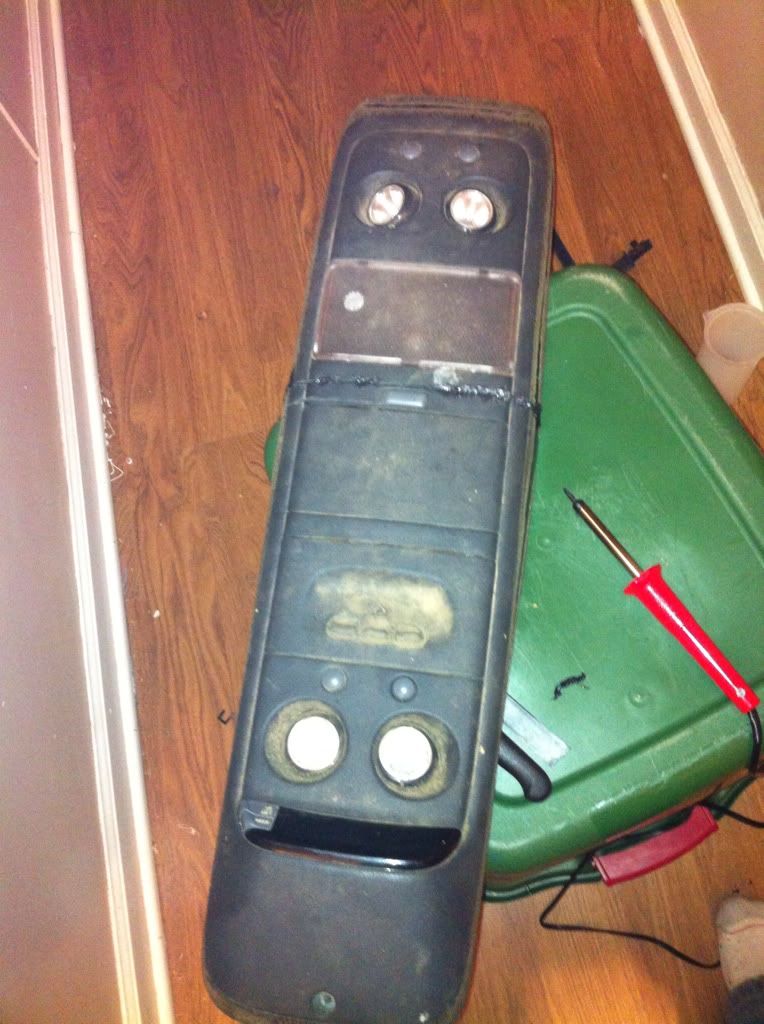

Everything welded back up
Sitting on console
Still need to sand down and paint it all and fit it to the head liner. Any tips would be helpfull have any questions or comments let me know, thanks for looking!

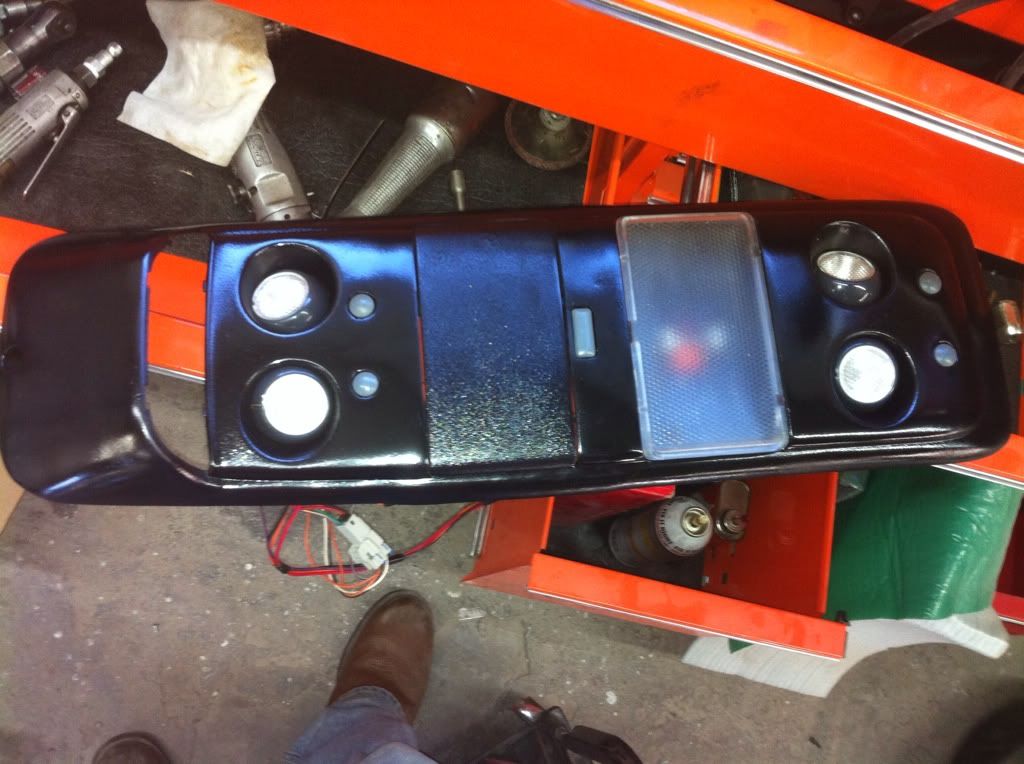

Wish I had lol! I had the lights in front and back plus the main one so it wouldn't even fit in the cab. I'm don't modifying it any ways now lol.
Ended up shortening it by over a foot

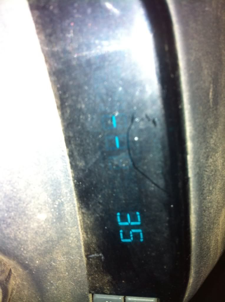

Blahhhhhh........  Hooked it all up.... Everything works but after about 45 seconds the temp goes to -- anyone had this happen or have any ideas?
Offline kalbert
  • Posts: 5
Re: 98 blazer console adapting for my 83
« Reply #4 on: December 04, 2012, 10:09:29 am »
Probably a dumb question but you did grab the temp sensor too right?
Offline winky
  • Posts: 509
« Reply #5 on: January 13, 2013, 11:13:11 am »
yup, sorry not trying to grave digg here. haven't been on in a while. just wanted to say that on the newer consoles and the one ones with the fuel trim etc you need the signal from the ecu to tell it how often to update,if you dont it defaults to that one direction and the temp goes blank. hopefully this will help any one else that ever trys this
