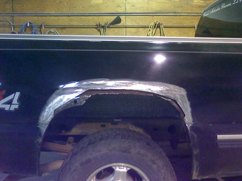

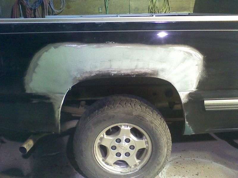

Rear quarter wheel arch repair. Quicky for inspection, but wanted a step above spray foam and filler!
The inside panel I just made three pieces. Plug welded them to the outside panel, and rivited them to what was left of the inner wheel arch. Going to seam seal it up, and rubberized under coat it. Should last for a couple years. They are planning on trading it in two years or less. They just bought a new Camaro two years ago, and he got a new truck last year. They want to get them paid down or off before adding another payment.
Cancer cut out.
Patch panel marked for trimming.

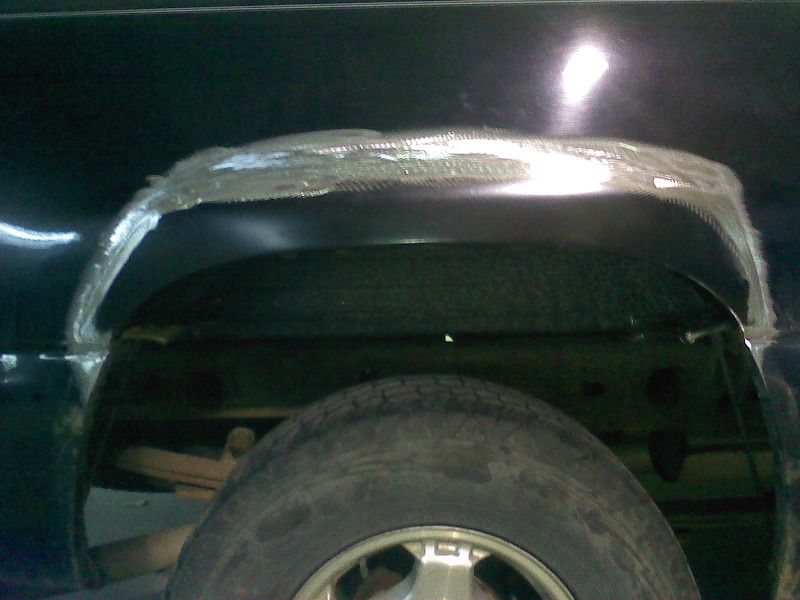

Panel clamped in place to check fit.
All cut to size, and prepped for welding.
Nice tight fit to the old panel. Just have to put a touch of pressure on it when tack welding it in place.

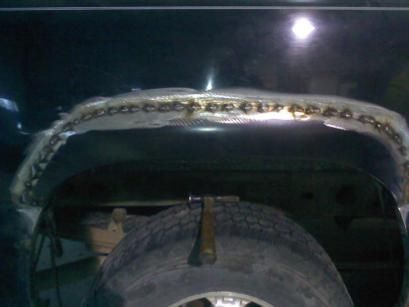

Tacked in place. ( I forgot to take one finish welded and the welds dressed up ).

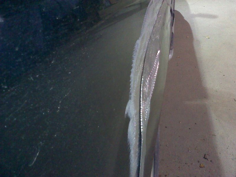

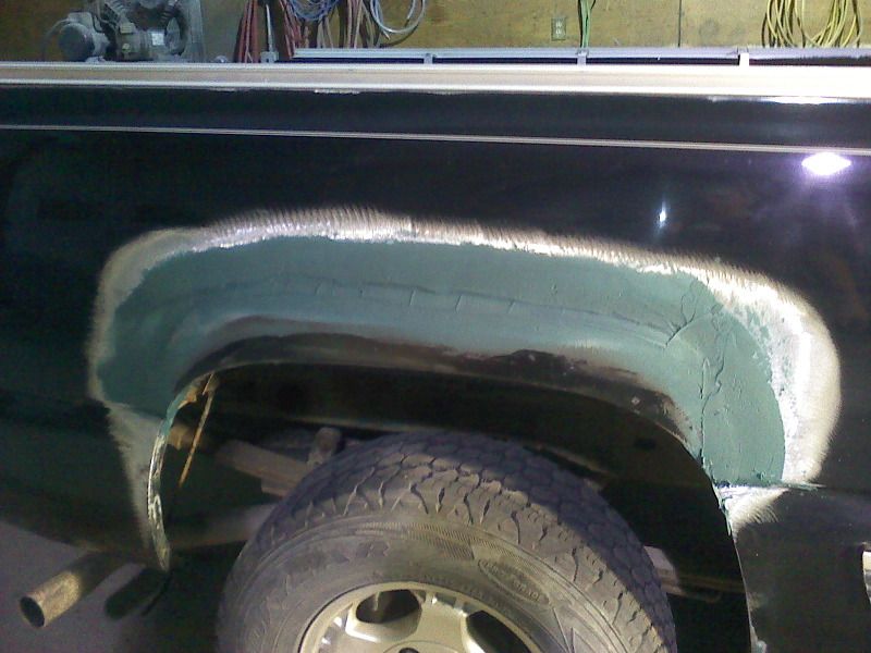

A coat of short strand fiber glass filler.

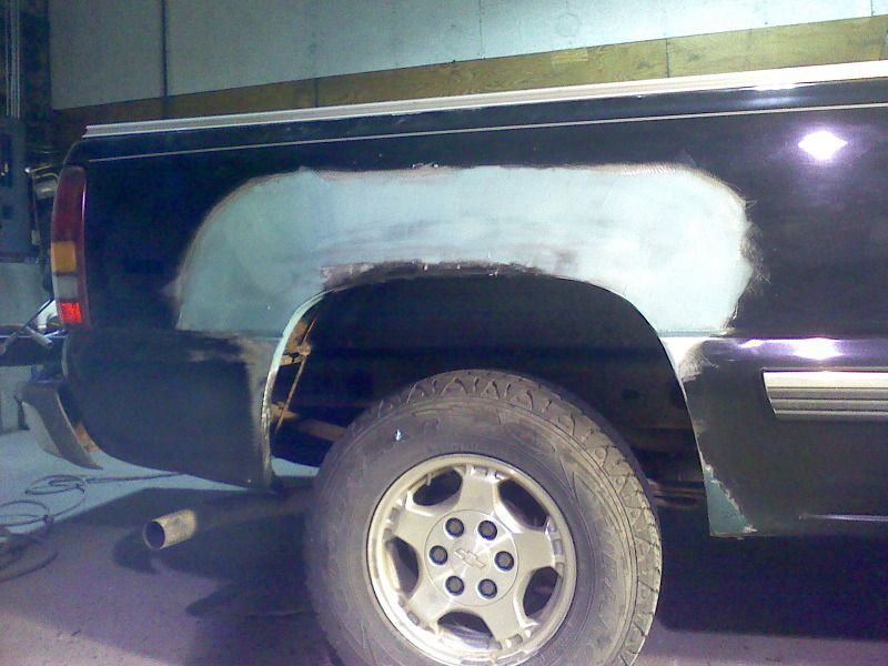

First coat of regular body filler.
Sanded ready for a second coat.
This job took a third skim coat of filler to get some 36 grit sand scratches, and pinholes filled in. I mix some fiber glass resin in with my filler before I add the cream hardener to losen it up for my last coat. It spreads like warm butter on toast this way. You can keep it very thin, and it fills small inperfections nicely.
Thats where it is now, I will add some more pics tomorrow when I finish it up.

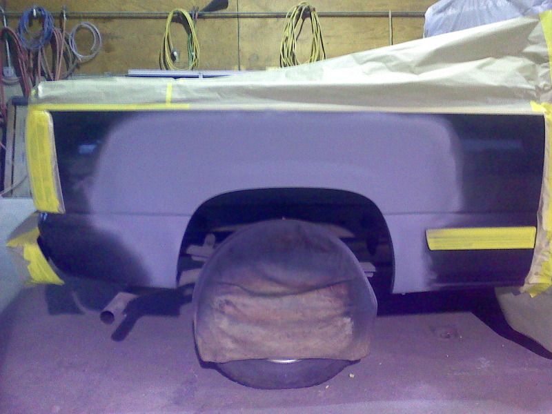

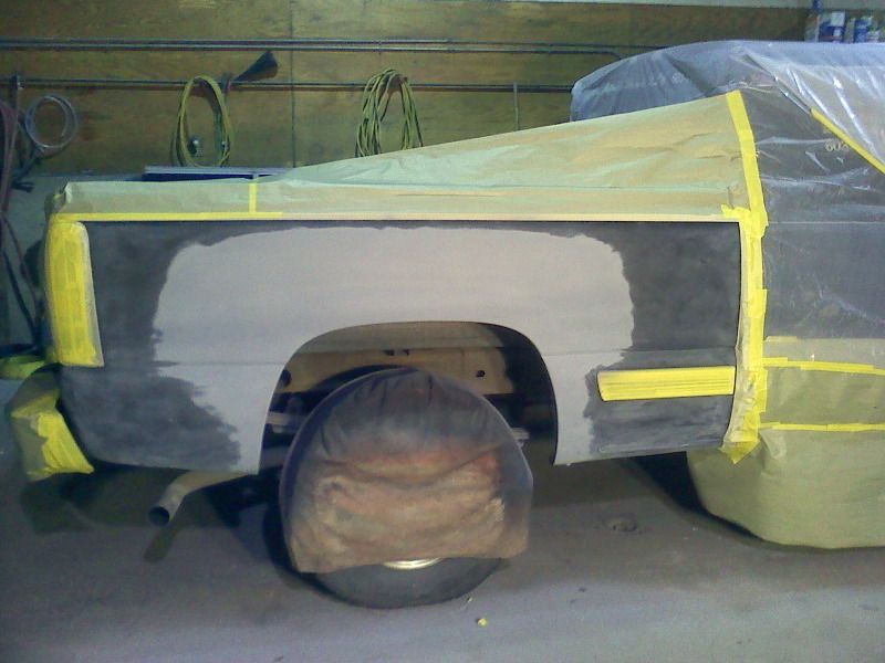

Done sanding the filler with 80 grit. All the grind marks and sand scratches are feather edged out of the paint with 80, 180, and 320 paper on the DA at this point.
First, or second coat of high build urethane primer.
Third, or fourth coat of primer.
Entire panel sanded with 320, and around the edges with a maroon scuffy pad.

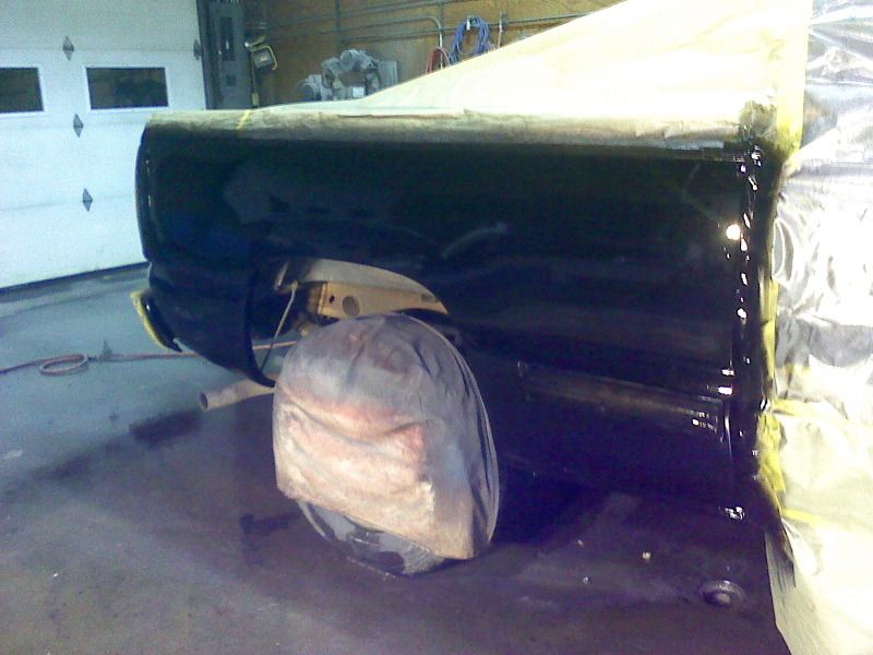

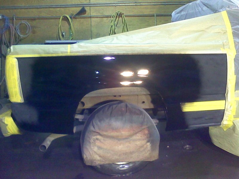

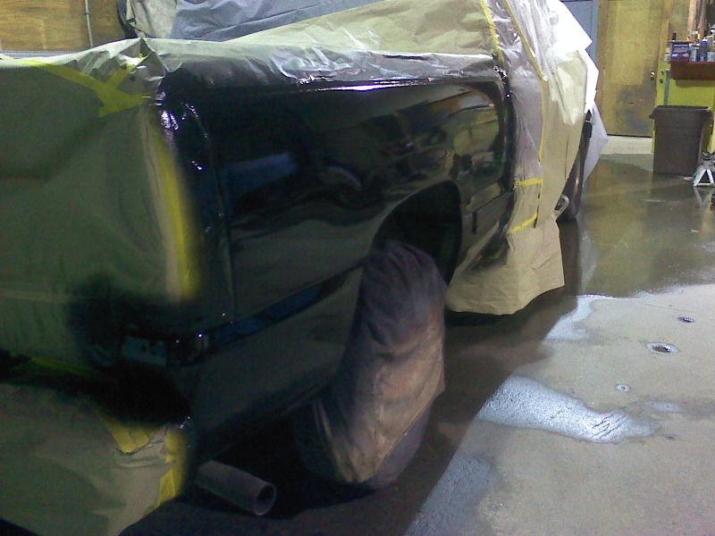

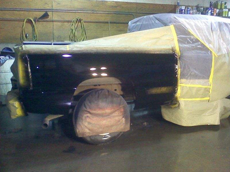

First coat of single stage urethane paint over primer area only. Useually I just spray the repair area the first few coats to acheive hidding. In this case it was black so it hid well with one coat of paint.
3 coats of paint over the entire panel after I acheived hiding.
