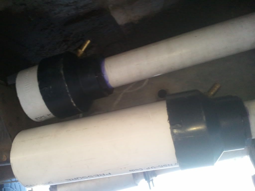

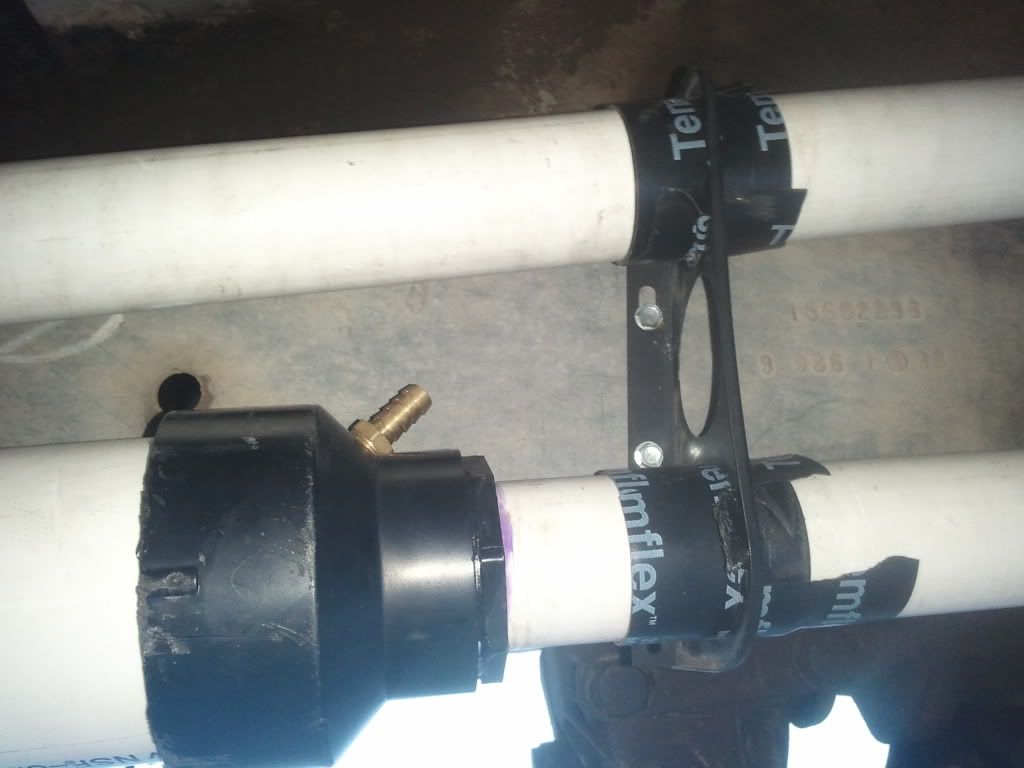

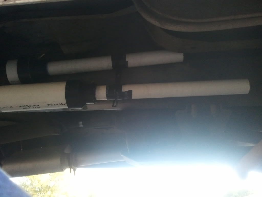

so, i watch a lot of youtube train horn videos and wanted one. But the cost is outrageous. So i went with a 30 dollar budget build.
2 - 2' sticks of 1 1/2" pvc
2 - 1 1/2" to 2" bushing
2 - 2" to 3" couplings
1 - 2' stick of 3" pvc
2 - 3/8's npt to 1/2 barb
1 - car tire innertube(any size)
Put it all together and i made 2 fully functional, very loud air horns. And i mounted them on the suburban. Just gotta run the hoses, get a valve, and get a compressor. I already have an air tank. I shot 120psi through them and it shock my chest and tickled my eardrums.

Interesting how long are they over all

Yea that just looks cool............where gonna need more specs, pictures etc your defiantly on to something!

Im going to build a pair for my buddy so when i do ill make a tutorial. I had to use a highlift jack to compress the whole thing together because i used the innertube as a diaphram which makes the sound.
