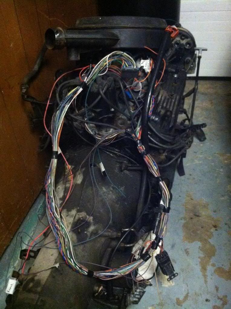

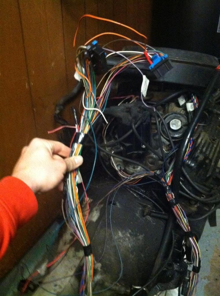

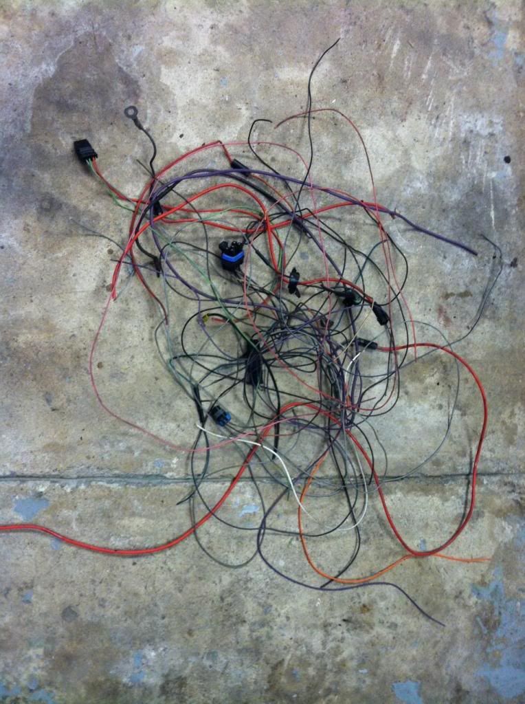

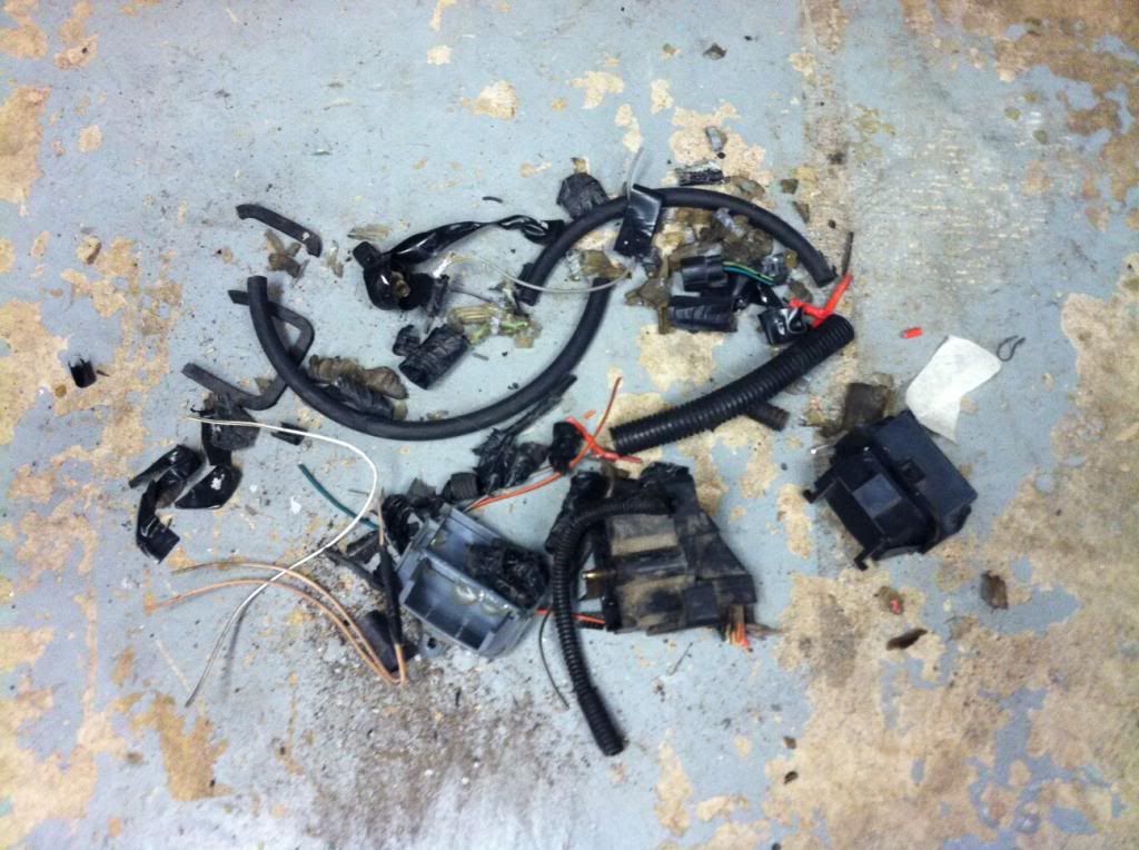

Well I got some more done today. I started on the wiring harness its almost done now. I stopped working on it after i ran out of time which was about 3-3.5hrs into it. I have pretty much the entire harness figured, I also needed to clarify a few things on it. Here eare some pics of what I have now.

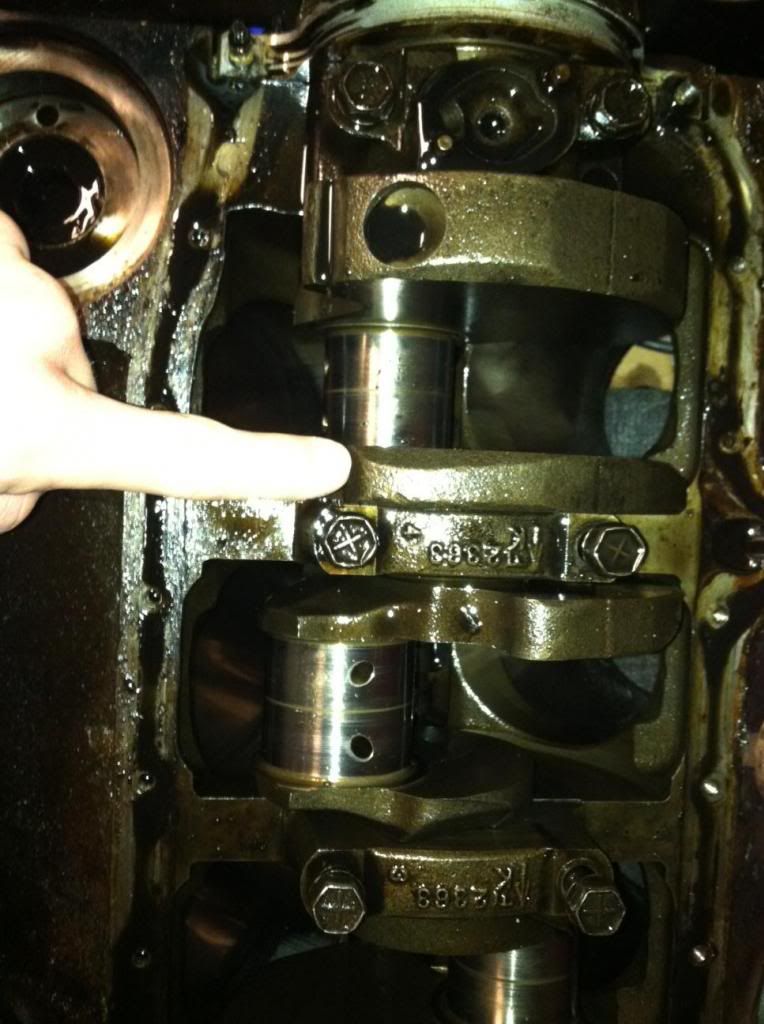

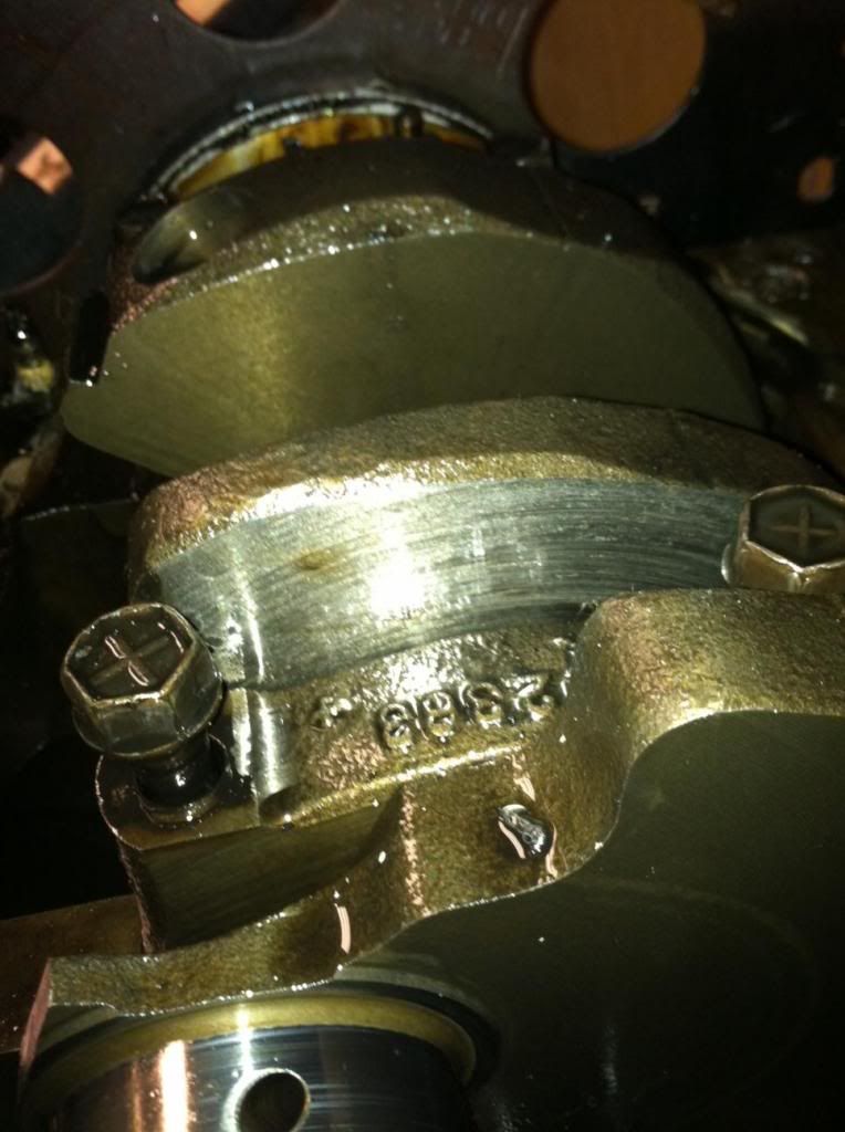

Bad news I tore into my block and the end play was way out, so bad the crank got into the block a very very small amount so I beleive I will need a new crank.

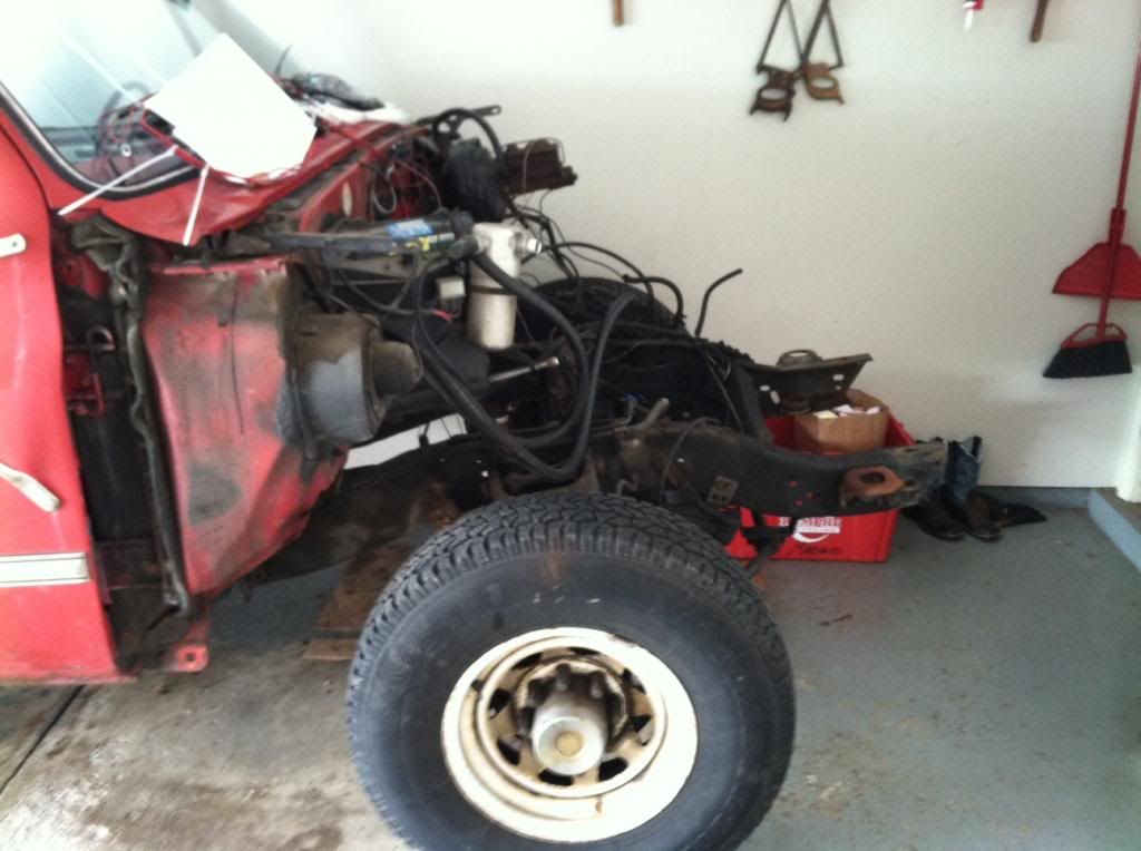

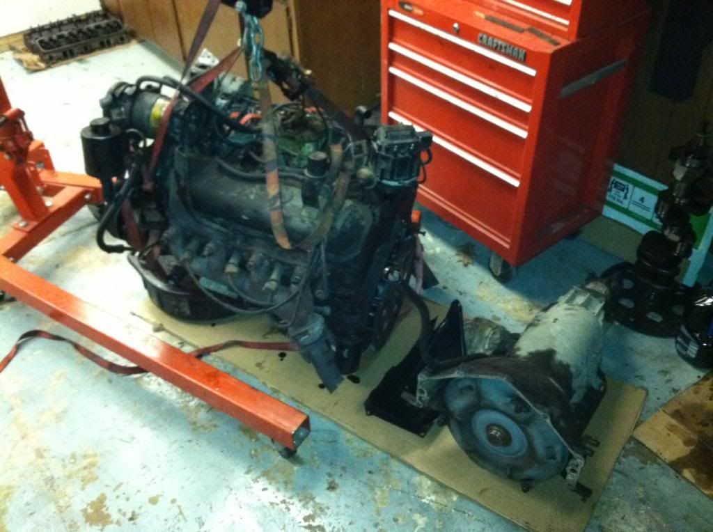

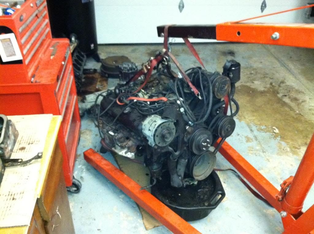

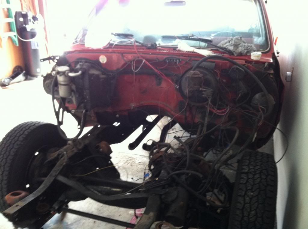

Well its all finally happening. The 454 is out of the Truck and Ill be getting the rest of the money for it tonight. Ill be dropping my block, crank and pistons/rods off at the machine shop tomorrow and hopefully be able to get the heads there the first of the month.
This is what she looks like now. I have some cleaning and painting to do. I have some wires I need to get rid of and need to figure out where I'm running my the TBI harness through the firewall and where some of the stuff will be mounted inside the engine bay.

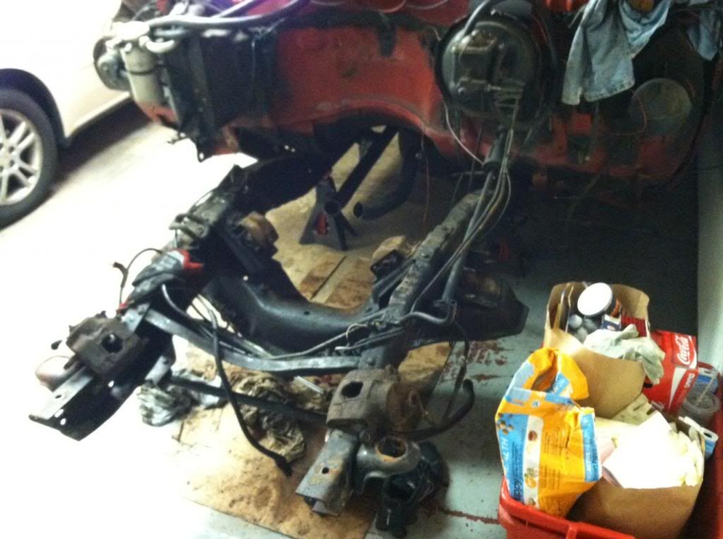

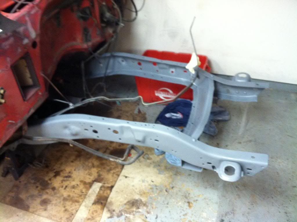

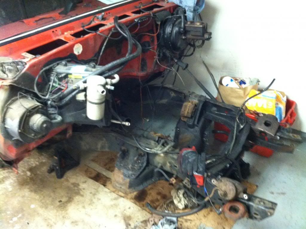

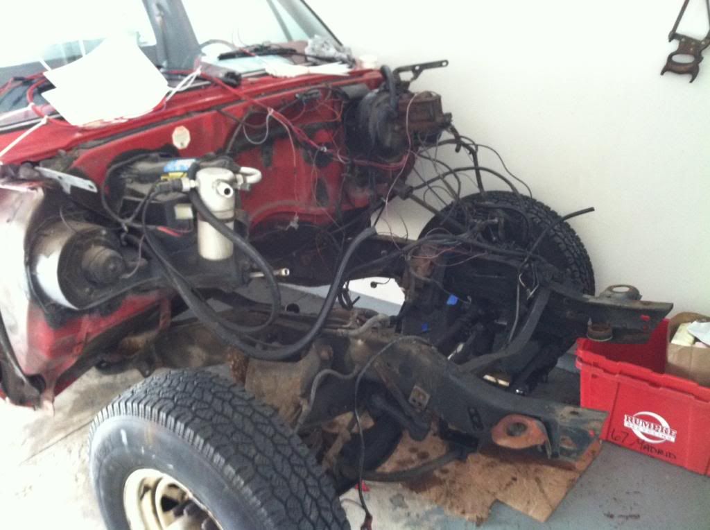

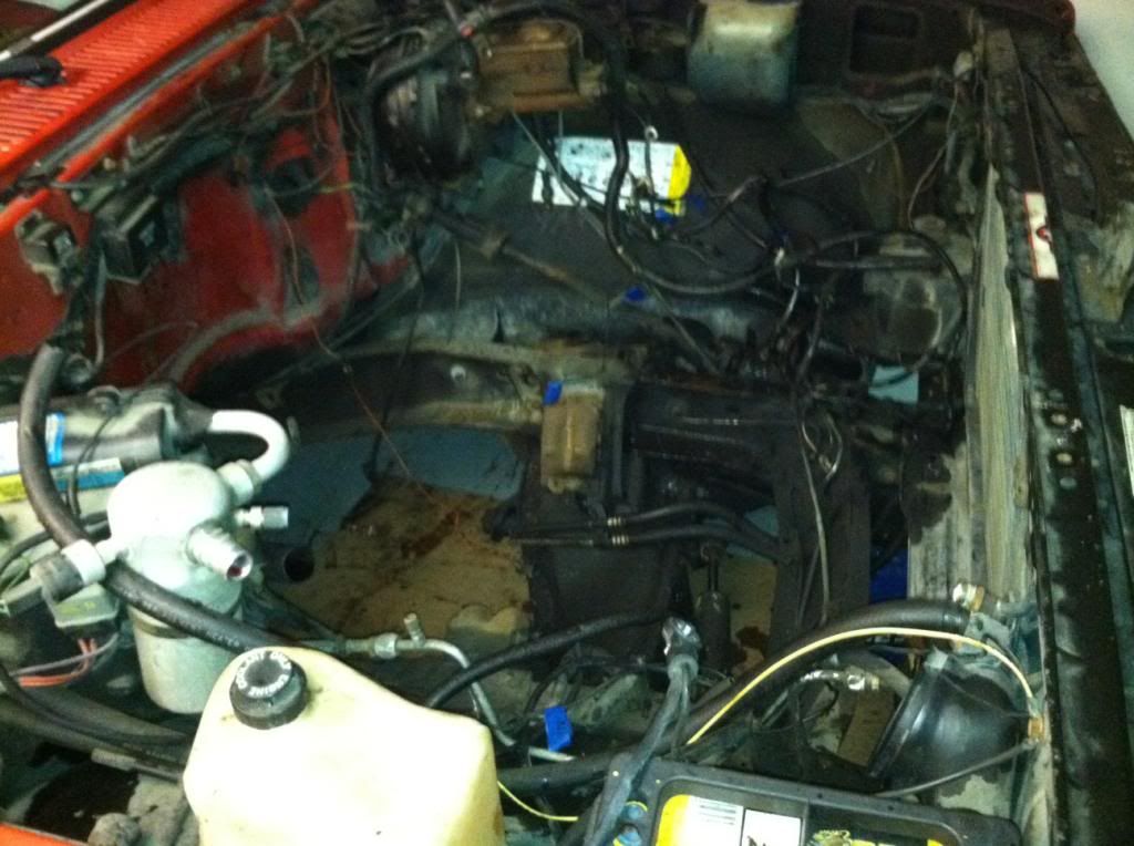

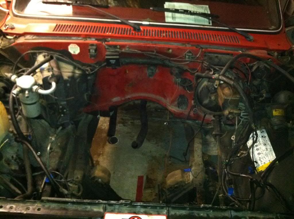

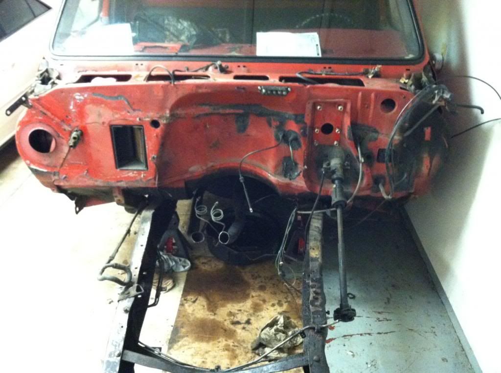

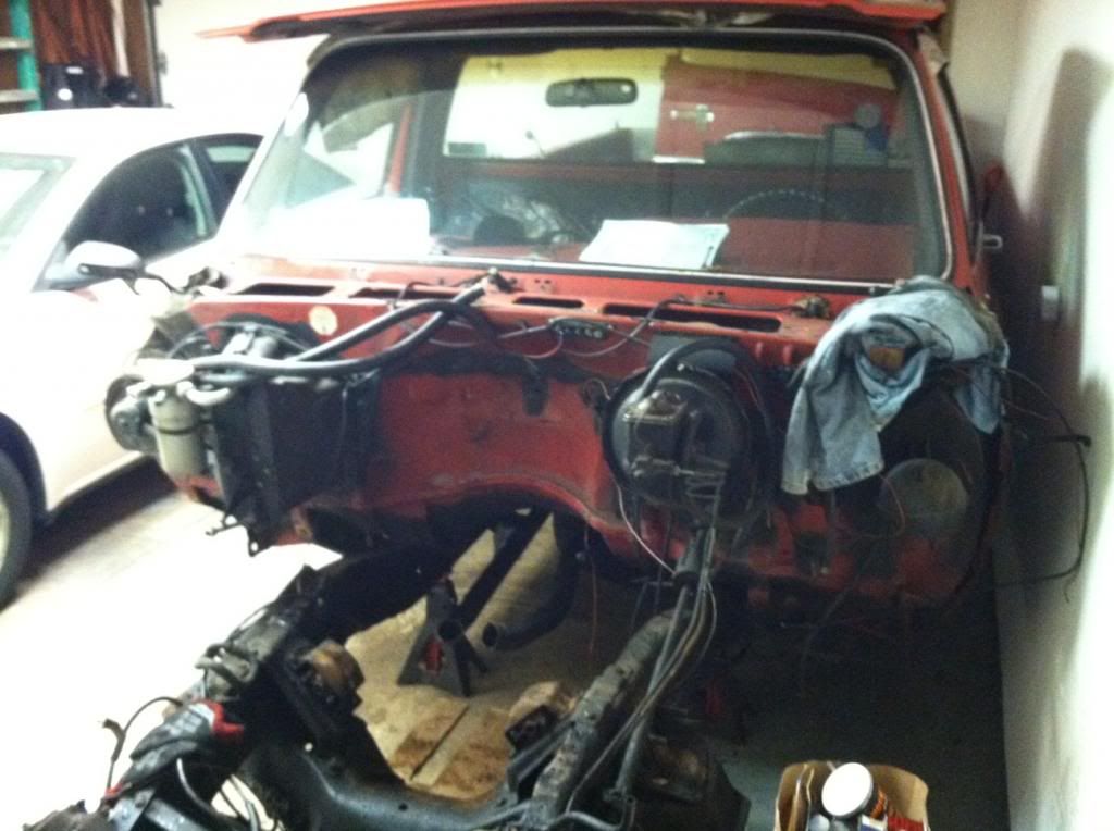

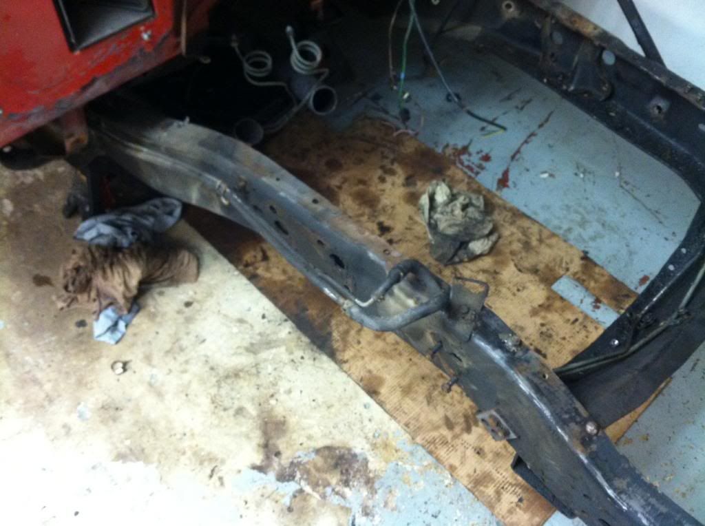

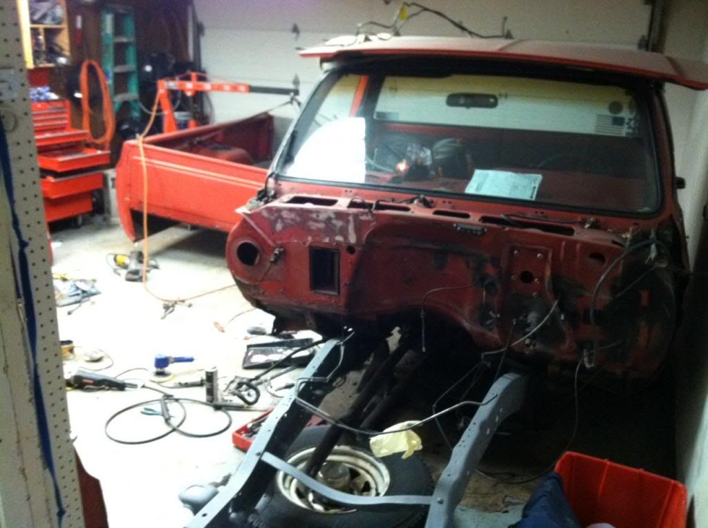

Well I pulled the front clip off of my truck today. I have a lot of cleaning and a few small spots of rust to cut out and burn back in on the inner fenders. I am planning on keeping this as cheap as possible so everything I can reuse, rebuild or repair will be reused, rebuilt or repaired. I do not plan on this truck being a show piece I just want something that is nice looking and nice to drive. All of the factory paint is still on the frame rails and no rust has formed so the plan is to go to Tractor supply and buy some black implement paint then clean and paint the frame rails. Here are some pictures of the progress as of today.

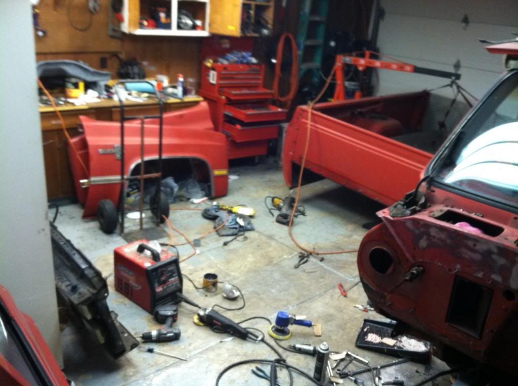

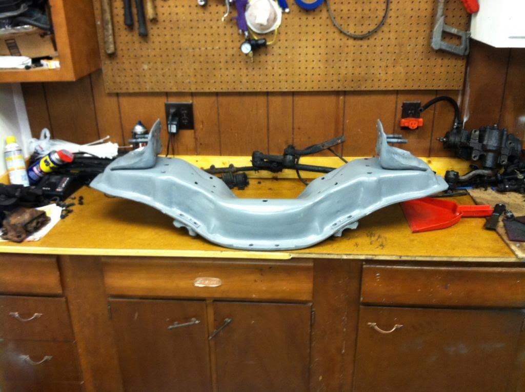

I have a few more things to add. I got the entire front end pulled apart, prepped and some of it in primer...

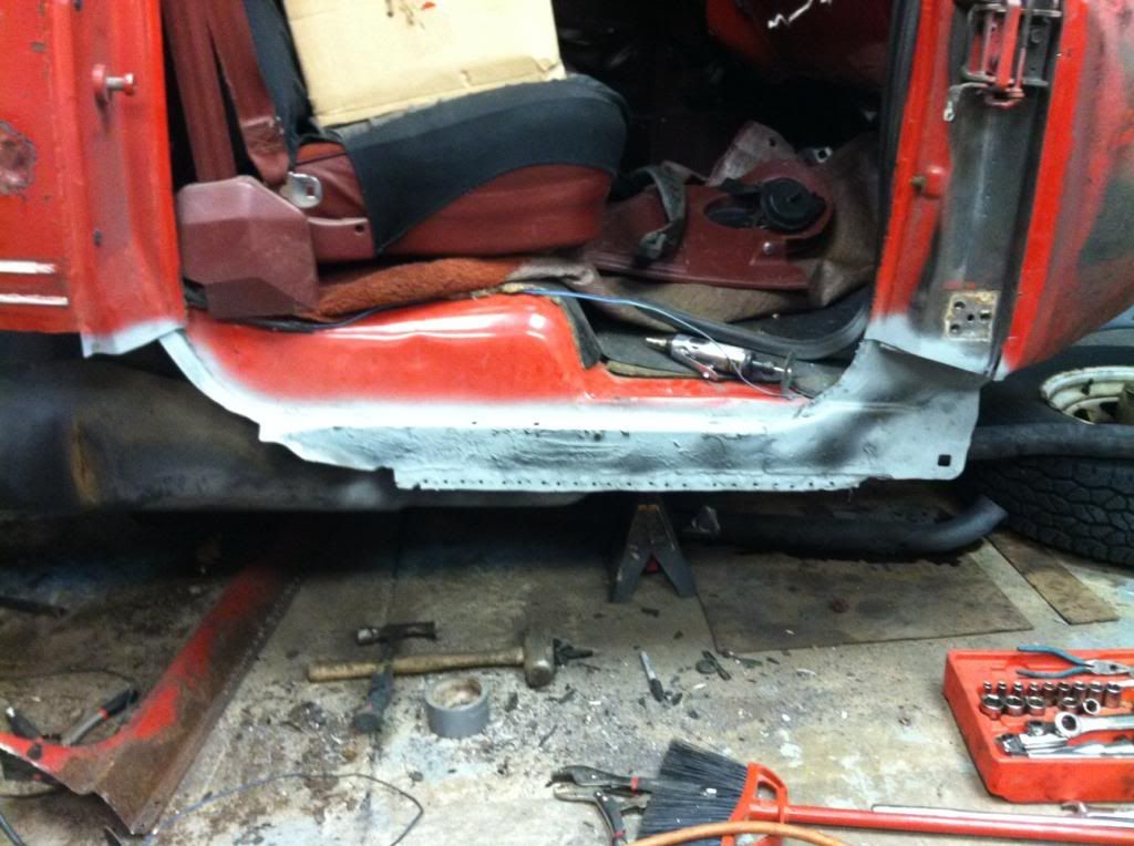

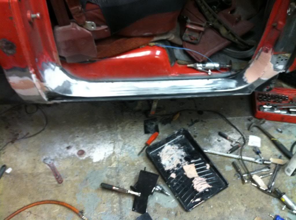

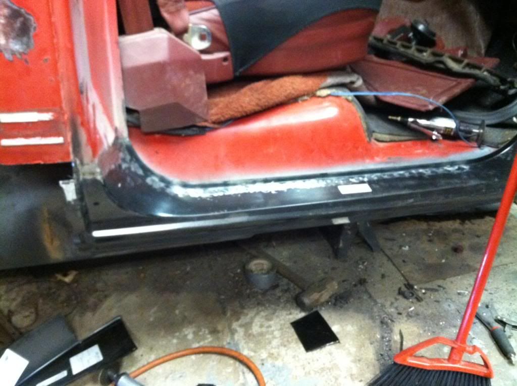

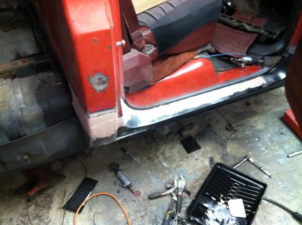

I had about 9hrs into the truck today, got a lot of little stuff done including my passenger cab corner and rocker

I'm trying. I really hate how these aftermarket panels fit. I've had to do a lot of fitting and cutting.
