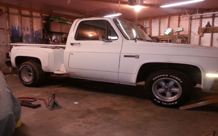

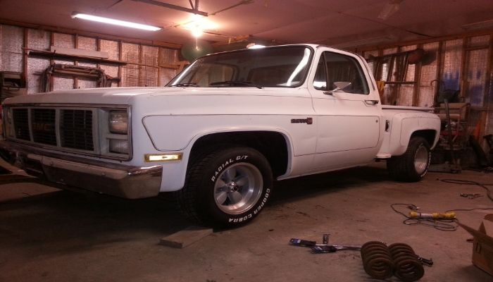

Well today I got the new front springs in and 2 inch drop shackles. So went out side and got every thing installed on the truck( Man do I love southern trucks) had front spring in and the back shackles done in like 2 hours. Really happy how the truck looks but still has the lean like inch higher on the pass side. So few way I think I could fix this
1 On the drop shackles drop one side 1 inch and the other side 2 inch
2 New springs (don't know if this will fix it)
3 I am buying them air bag helpers  so I could just but a little more air on one side.
What do you all think here are some photos now I can start the body work
Thanks Jay
Re: Truck lean
« Reply #5 on: February 21, 2013, 02:47:01 pm »
     Looks good.
