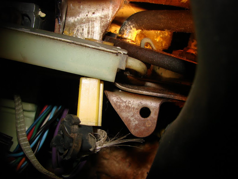

Bob, I posted this here just in case you or others need to access the photos or information.
The Clutch NSS switch is attached to the Clutch Release Arm (Clutch Pedal) and anchored to a dash bracket. The NSS switch snaps into the clutch arm and has a plastic bolt and nut threaded into the dash bracket.  I've attached photos of the wiring diagram from a 1978 Chevy Truck Manual and photos of the NSS as actually installed on a 1974 Chevy Truck.  The photo point is from directly below the clutch pedal looking up. If you have the tubing for the LH dash vent in place (i.e., an A/C equipped truck), it may be difficult to see.
View of Right Hand Instrument Panel wiring (1978 Chevy Truck)
Closeup of Right Hand Instrument Panel wiring (1978 Chevy Truck)
View from below of installed Clutch NSS switch as installed on 1974 Chevy Truck. The NSS is the white rectangular plastic part with the plastic arm that snaps into the clutch release arm. The portion of the NSS switch that bolts through the dash bracket is not seen, but when looking up should be apparent.  The white plug-in at a 90 degree to the NSS switch is the wiring harness.  This can be removed and jumpered if necessary to bypass the NSS.
