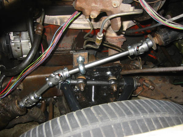

The crossmember isn't listed in the catalog because it is a custom piece I do for my custom shop, www.captkaoscustoms.com  It is $385 to chop one down + $75 core or a customer supplied crossmember + shipping.
This is what the piece will look like when completed:
This isn't a simple component replacement.  It requires A LOT of modification to the trucks steering components and tearing down the front suspension of the truck.
The engine MUST be removed, then the crossmember removed, then the components swapped over to the chopped one and then everything put back in place.  New steering shafts and joints must be purchased to go around the upper control arm.
