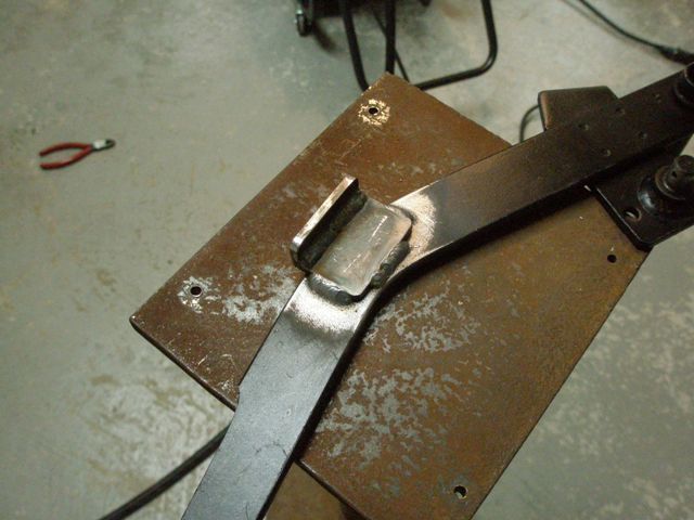

I also got my pedal assembly, which I have cleaned up a bit and started working on for a clutch pedal positive stop as required by the Tilton HRB.  I hope it works.  I basically welded on a nut at the factory rubber stop location.  But it seems I'll need to add a gusset to take out a bit of flex.  I'll chip away at it this week and post pics when I'm finished so you all can have good laugh.

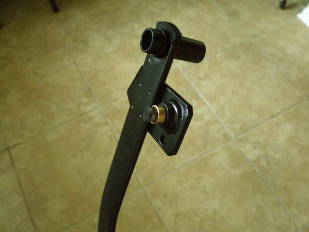

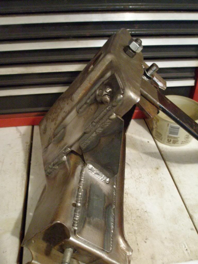

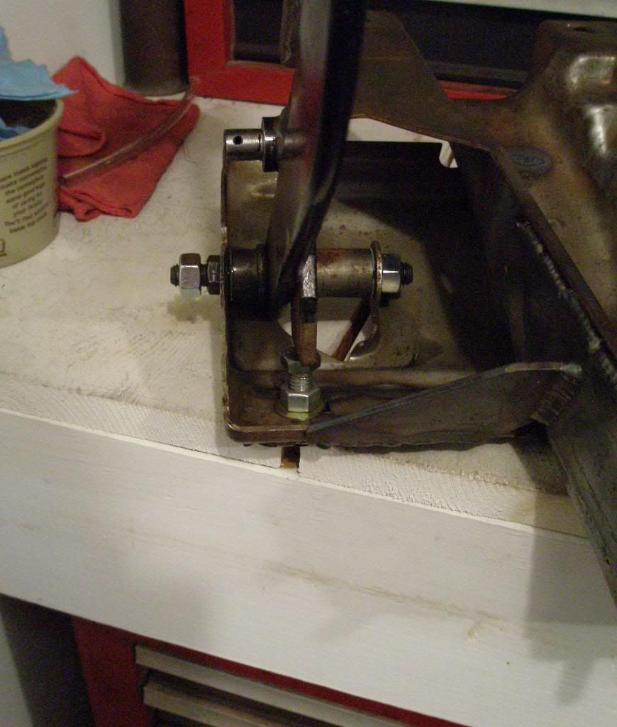

Pedal assembly modifications using the factory rubber bumper location for a adjustable stop.  Added gusset to remove some flex.  I'm still not satisfied as I will have a 6:1 leverage ratio on this location.
I welded up the typical groove worn in the pedal pin, filed it round again, and fitted it with a replaceable bronze sleeve.

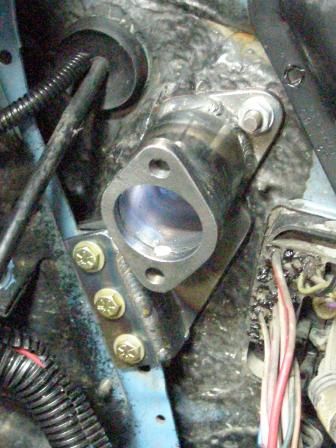

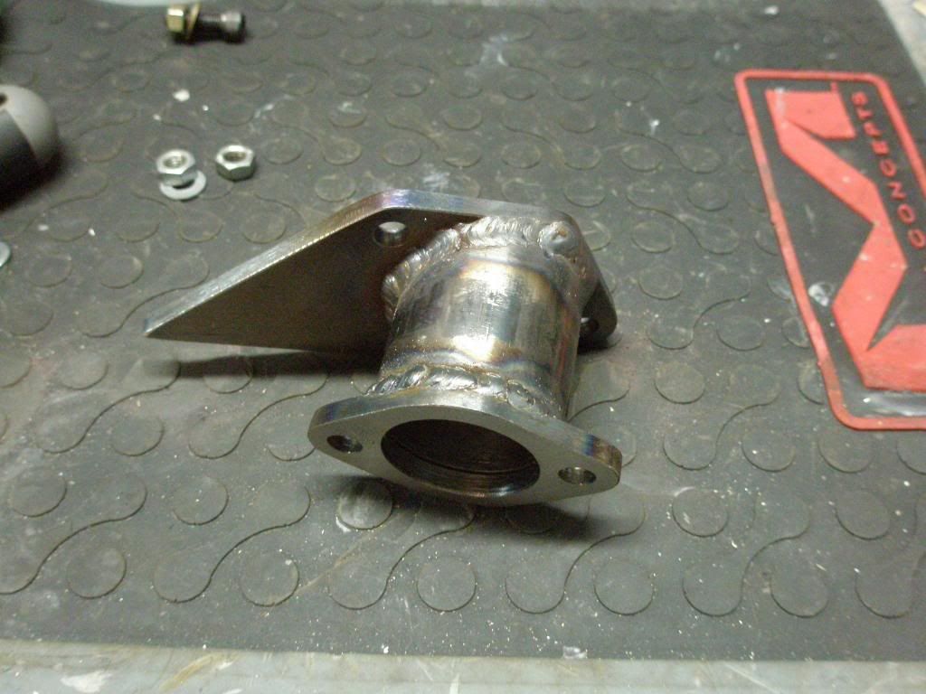

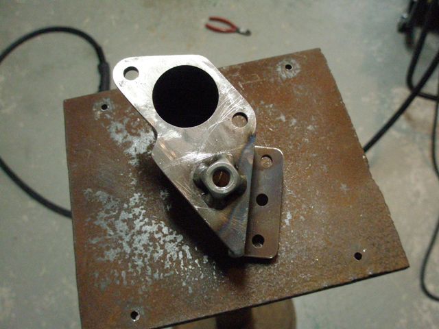

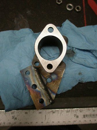

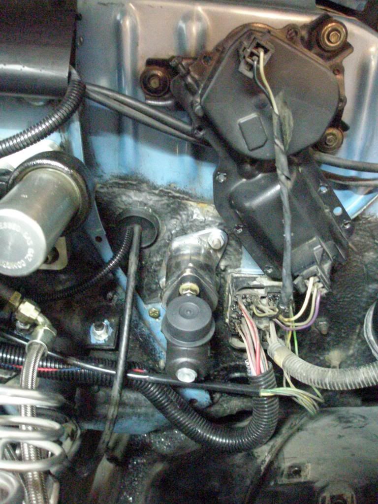

Here is the master cylinder adapter I made.  It places the master at a 15 degree downward angle.  It's oddly shaped because I want to tie into the thicker material nearby and because I am going to use the material just below the master to make another pedal stop.

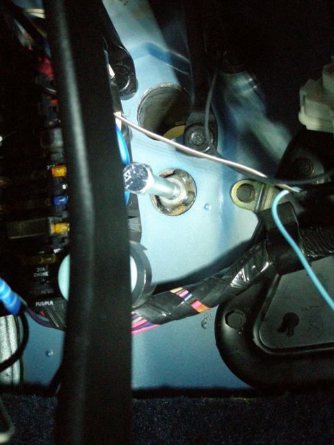

Here it is installed with master mounted.

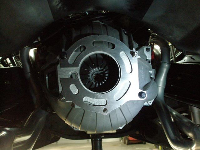

The Bellhousing: After initial mock-up I discovered my bellhousing was not square with crank.  I had my bell checked for parallelism between the two faces and it checked out, so that meant my block mounting surface was not square with the crank (no paint or obvious defects on this surface).  So I poked around and discovered that, while it is not an ideal solution, you can shim a bellhousing.  I used .015” under the top two bolts, .005” under the middle bolts on either side, and nothing under the bottom two.  I checked for a “soft-foot” and all was well.  Parallelism checked out at less than .002” indicated down from .010”.  Of course, correcting the out-of-parallel situation affected the run out readings.  Before shimming, I had .032” indicated meaning .014” offset dowels would be needed to get me within spec.  After shimming, I had .012” indicated meaning .007” offset dowels.  So a set of Lakewood 15907 dowels got me at about .002” indicated run out.
The HTB: After this, the I was ready to install the trans only to discover that my hydraulic throw-out bearing would not have the necessary clearance (there must be a .125” gap between the bearing face and clutch fingers when the bearing is fully collapsed and installed for the first time).  What to do?  I poked around again and found that there exists a .250” spacer for this very situation.  So after taking some measurements and speaking with a few knowledgeable folks, I ordered a Lakewood RM-197.  This corrected the situation and left just enough of the bearing support exposed to register in the bellhousing bore.

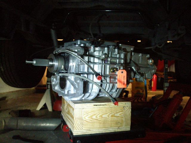

The Trans: At the outset of this project I decided I would go a bit spendy.  Not only would I be going with a brand spankin’ new trans.  I wanted a Liberty’s Gears modified TKO-600 – what I felt would be the ultimate 5-speed for my truck.  Well imagine my excitement when I took my truck out for the first time.  Man, would it be hard to respect the break-in period.  So, I did manage to drive it very gingerly for a about 50 or so miles.  Then I decided to gently run up third gear.  At about 3000 rpm, I heard the most awful sound from the trans.  I sounded a bit like stripped teeth and a bit like gear clash.  I was crushed.  Was it the shims, did I not tighten something, is it touching the floorboard?  I pulled it, checked everything, found nothing, and reinstalled.  Same result.  I drove it around a bit more and discovered that it only occurs in third gear and, to a much lesser extent, in fifth.  It shifts great and makes no noise in any other gears.  I had been in communication with Liberty’s and after another call they agreed to pay to take the trans back and send me a new one.  It would be over three weeks before I get a new unit to try, though.  So I got this new unit in and the moment of truth arrives.  That noise was either the fault of the trans or my installation.  After my first drive, I was ecstatic.  The trans was perfectly quiet, shifted even better than the last one (almost no synchro noise and resistance when downshifting), there were no strange vibrations, and my truck was a pleasure to drive again.

A few pics of the master cylinder bracket illustrating what I meant when I said I'd be tying it into the nearby thicker material and also my new pedal stop setup:

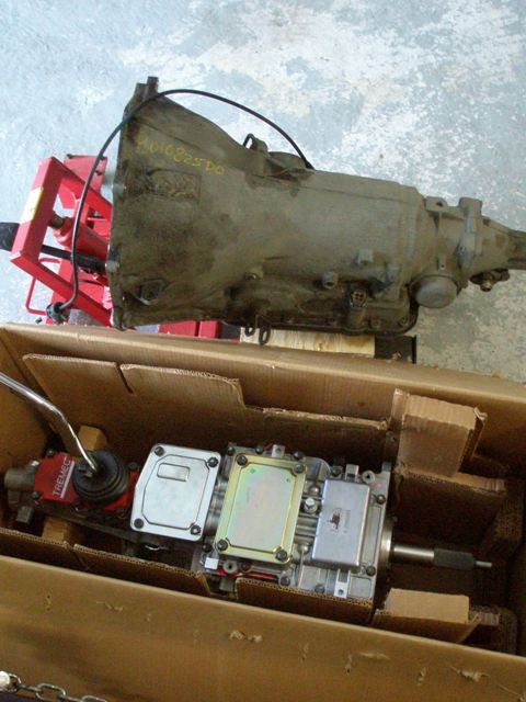

Old meets new:
Bellhousing w/ spacer:
Trans awaiting install:
