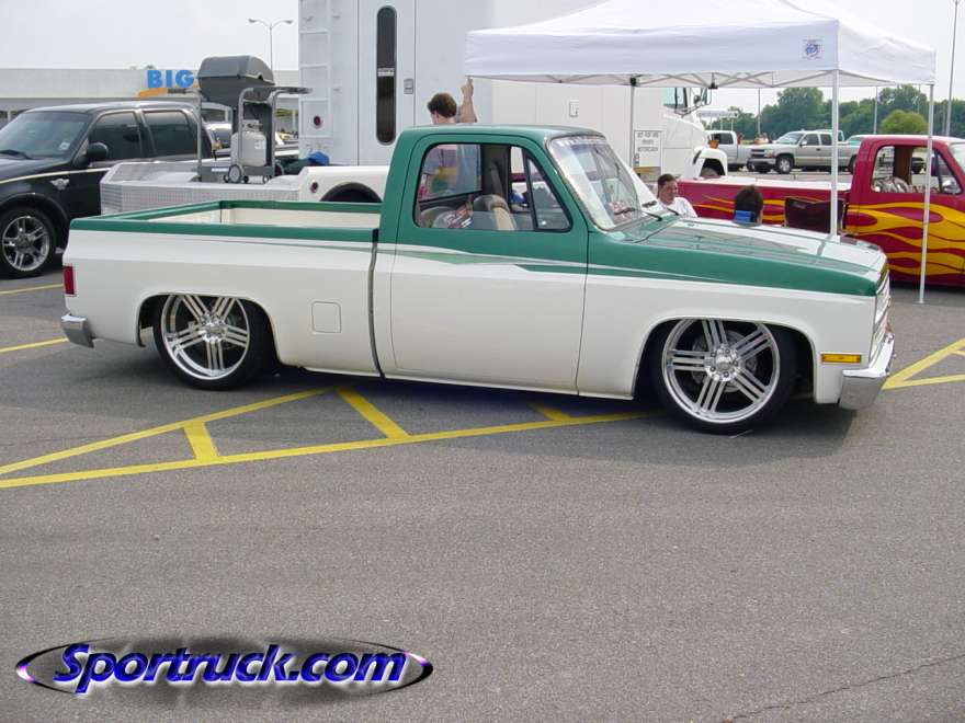

i'm looking at about this low img.sportruck.com/events/...05/450.jpg maybe an inch or 2 higher

The pic you linked was bagged or Body Dropped or both.

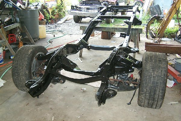

No, I am not saying they are no good.  That quote was a little out of context.  The original poster was complaining that spindles and springs lowered his truck so the control arms hit.  I am saying that lowered control arms have a lowered pocket, so they would be just as bad.
I ran lowered control arms on my truck for over 7 years and it is going back together with them on it again.
Here they are pictured before they were painted:
