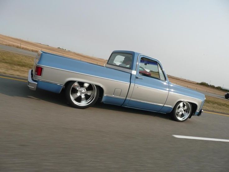

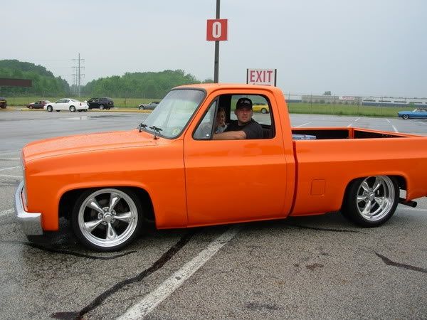

I apologize if these are someones trucks and posting your pic but, does anyone know if they are 4-link air setups or static drops and if so how low are they?
I am torn between Porterbuilt 4-link Extreme or Trailing arm setup, I know main difference is trailing arm limitation is the bed and that its much easier install.
I know the wheels on the blue truck are 20's & 22's but don't know anything about the suspension and love the setup, and appears to be the same on the orange.

A porterbuilt should sit lower than that if aired out.  This is a porterbuilt.
Those could be static or Ridetech, this is N2TRUX's Ridetech equipped truck, Air kit in front, Airbar in rear
