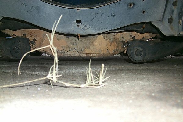

i need to trim for the front bags, and the spot it's at is kind of tricky. as you can see, the top of the bag rubs...
here is what a guy did to prevent that, you can see he cut out a much bigger hole
i wanna know if i would be ok to cut at the red line. i don't see how it would affect anything, as there is still the upper "rounded" piece. i will only be removing the 1/4 plate from the red line and what's to the right of it

My opinion, get rid of the cup and put a plate on it. Then you only have to drill holes and it won't be a problem.
You can however cut the hole out larger. It looks like you only need it on the outside though...

it won't lay with upper plates. i talked to a guy i know who works in a shop, and he said it should be fine if i reinforce it

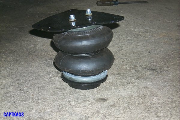

I disagree. It will put the lower control arms on the ground like that. Need proof?
Here is those exact brackest in a test truck, there are NO spindles on it either and tires are 28" tall..:

can you post pics of the bag when its laying out? are you running lower cups? how tall are they?
this guy had a 4" z and 3" spindles, he still didn't lay out. i layed it down without bags and measured, there's about 2" between where the plate would be and the lower cup is. the bags alone are 2.9" tall...

I will have to dig around and see if I have any pics with the bags. That is a REALLY old pic. The lower cups were "just" tall enough to not rub. I am thinking they were 1.1/2". I sold and sell the bag brackets, and they are ususally cut to height for whomever buys them, and I made those as low as possible. I can't get any pics of it now since I sell the brackets and the truck is now sitting on 2x4's as you can see here:

i was just told from a few people that it won't lay with upper plates. that guy also had a 4" z and it didn't lay. i cut my lower cups to 1" and it doesn't look like it would lay with plates. i have the upper cups already so i'm just gonna use them. but i will be doing probably a 2" z with a 2.5" sfbd along with a 1.5" channel to lay the doors on the ground.
