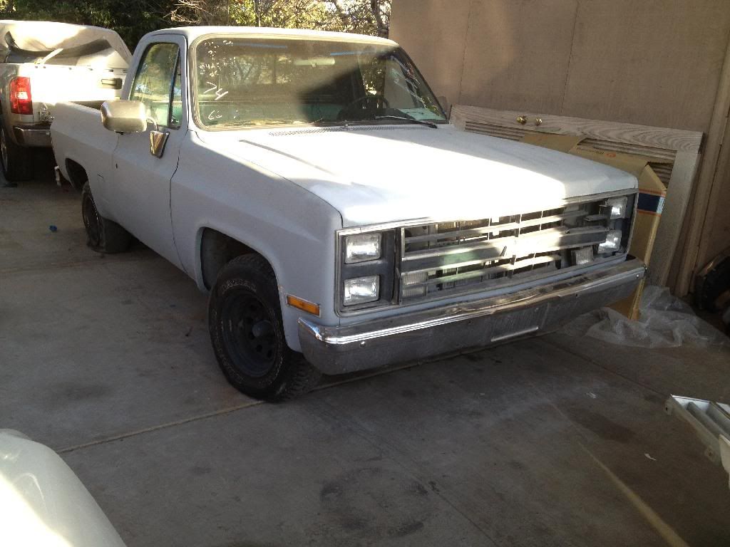

Hey everybody new from Az my names Gabriel, im starting a build thread for my 87 R10 Short bed.
My goal for it is to take it apart paint the frame, replace anything that needs to be replaced , bushing, mounts, tie rods, shocks etc.... It's got a 350 with an auto tranny. It sounds good, but I wanna put a 5.3 in it, I'm hoping to get it done pretty fast, my dad owns an upholstery shop so anything that needs to be done with the interior will be no problem, I do paint and body work on the side and know plenty of people who do great work and cheap if I don't have time to do it. I buy and sell cars so my plan is to buy a complete silverado with a 5.3 from a salvage auction I frequent. The only problem I for see is the wiring for the 5.3 so hopefully you guys can help... I'm going to start taking it apart this coming week.
Here's when I bought it from the auction
Haven't done anything to it yet besides buy a new grill for it, and finding out the frame is cracked at the steering box.
Interior needs to be completely redone.
