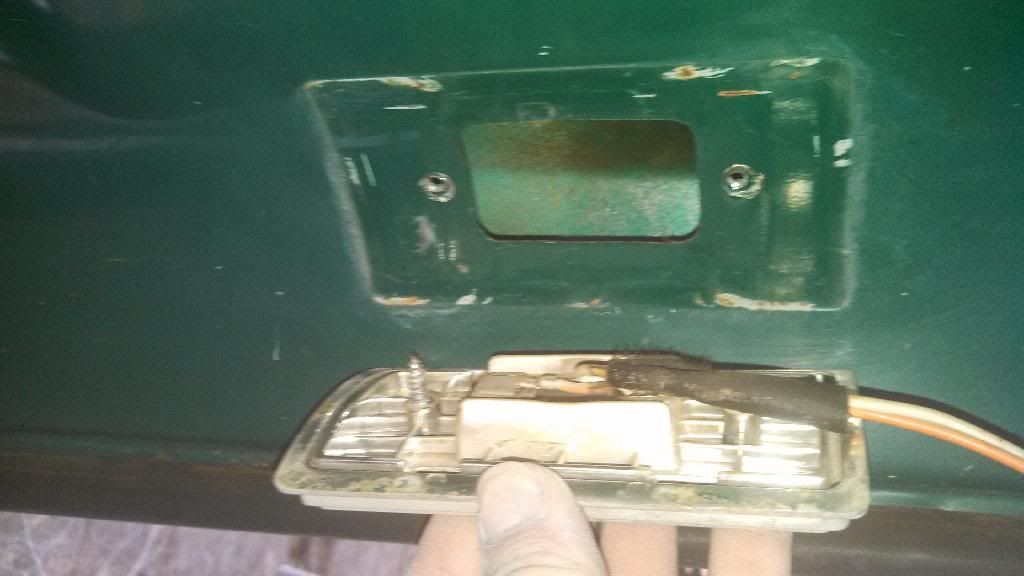

« Reply #16 on: February 19, 2014, 06:49:21 pm »
here you go! :)
held the light up so you can compare it to the hole. i would probably cut the hole just a little bit bigger then the recessed part of the light and then just use self tapping screws to attach it (make sure there not too long of course) if you need anything else let me know like i said i have a few of these trucks threw out the year models so i usually can get pics info etc hope this helps you out,

     75_chevy, the pic of your visor! I do not see any holes.  If you are wanting to mount a dome light, the first question should be is, do you plan or want to install a head liner in your truck ?
     Regardless you will have to get wires up to the light, that means going between the 2 pieces of roof metal or running behind headliner and door post moulding if equipped or installed.
     I am thinking of something like this,
     http://www.jcwhitney.com/dashtop-highliner-headliner/p2023838.jcwx
 It has a dome light built right into the middle.

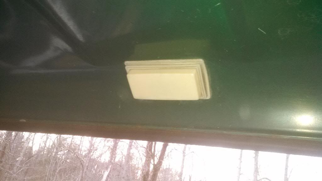

« Reply #19 on: February 20, 2014, 03:36:30 pm »
I would like to put one in in the future but for now I'm just going to drill some holes and mount this dome light I got.
here's some more pics of the holes above the visor

« Reply #20 on: February 20, 2014, 11:42:30 pm »
     On my 74 it has 3 holes there where the rear view mirror was mounted at one time.  I am not sure what those 2 holes would have been for.
