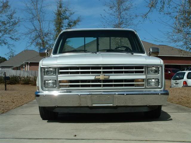

i114.photobucket.com/albu...mall-1.jpg
3" djm springs, 2" coils, djm rear flip kit
20x8.5 245/40/20 front
20x10 295/40/20 rear
Offline JAG66
  • Posts: 38
Re: drop
« Reply #8 on: February 10, 2007, 02:00:00 pm »
pcmcobra, Love your truck, lowered but otherwise stock appearing. What year is your truck and would you consider selling? Would like to see more pics. Jeff
Offline pcmcobra
  • Posts: 60
drop
« Reply #9 on: February 10, 2007, 03:48:00 pm »
it's an 86.
No way I'm selling it. Bought it off original owner in July. Looked long and hard for the right one. Had to fly to get it, and drive it home. :)
Had 106k miles, and almost mint condition. I love this truck and plan on keeping it for awhile. But thx for the interest.

Do you have any issue w/ the front tires hitting the fenders? I have 18's on my 82 and was afraid to use the drop springs. I thought it put the tires too close to the fenders. So I cut SB springs. Ended up w/ about 2.5" between the tire and the fender.
Offline pcmcobra
  • Posts: 60
Re: Lowering questions
« Reply #13 on: May 02, 2007, 07:38:16 pm »
Keeping my truck...keep looking :)
I have not had any issues with rubbing up front. I did get some more new wheels, same ones, just different backspace up front, so it will tuck when bagged.
As it sits now, if I went another inch lower up front it would rub, I am hoping this backspace will fix that.
