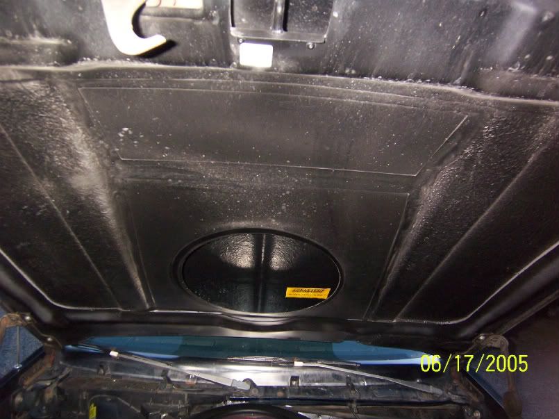

Sam, A couple things I'd like to add to this. They used the original shaped inner structure on the cowl hood you pictured...that's why it seems odd/in the way. With some creativity, average tools & skills, that could be made to look/be "more correct". Once mounted & the center point found above the carburetor, a hole approximately 15" would need cut. Through this hole pieces of metal (cut from patterns made) could be slide up on top of the structure & glued in place with metal patch adhesive...making a solid  "pan" sealing the scoop area off. Some fabrication will be needed to connect the structure around the hole for the air cleaner.
Here is a photo of a set-up I helped a friend make. Of course, the fiberglass hood was open so closing it in was easier than the one we are discussing. The air cleaner for this set-up is a large base from a 460 Ford turned around, a 14" top from a Camaro/Chevelle resto parts place & a piece of seal from McMaster-Carr.

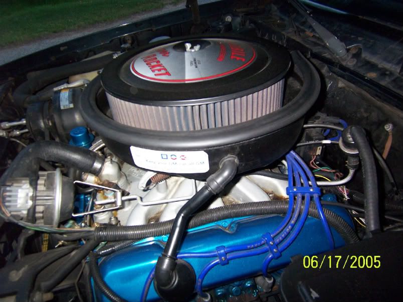

Since you mentioned a ramair set-up...here is a photo of the set-up I made. I have more money in the decals than the actual air cleaner. I made it from an original Oldsmobile air cleaner with 2 snorkels/hoses from the trucks into the original rad.support holes. No reason it can't be done with the original truck air cleaner...I just wanted the "correct" Olds part & to have the area correct for the decal on top. Dirt cheap & cool looks. Lorne

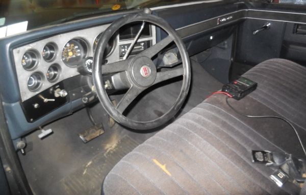

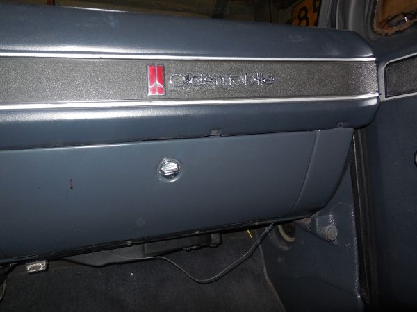

Ah, Chris...you ruined the fun ;) I was going to lead him on a bit more. Here's a couple interior photos & one more just for fun. For the record our truck was a 4.3 V6 GMC...No Diesel parts here. A note on the air cleaner...Last year @ the Olds Powered Nationals in Norwalk, Oh, a guy is looking around the truck, walks over & says: "I can't believe you have THAT air cleaner on that truck...I've been looking for 2 years for one of those...Do you know how much those are going for in that condition?" My wife told me I wasn't allowed to sell it!  ;) Lorne
