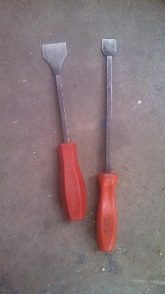

Gasket Scraper

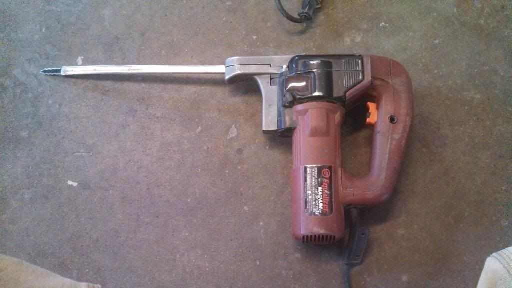

Equalizer

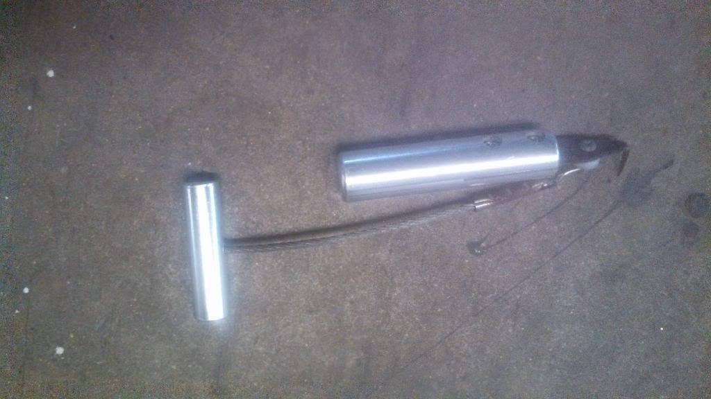

Razor Stick
[picture]

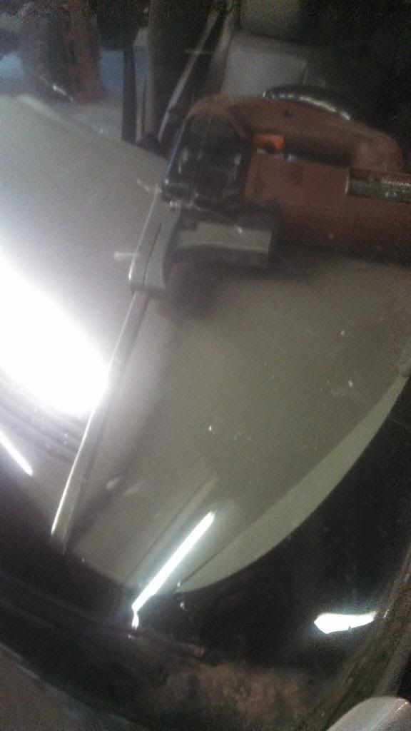

Urethane Gun
[picture]

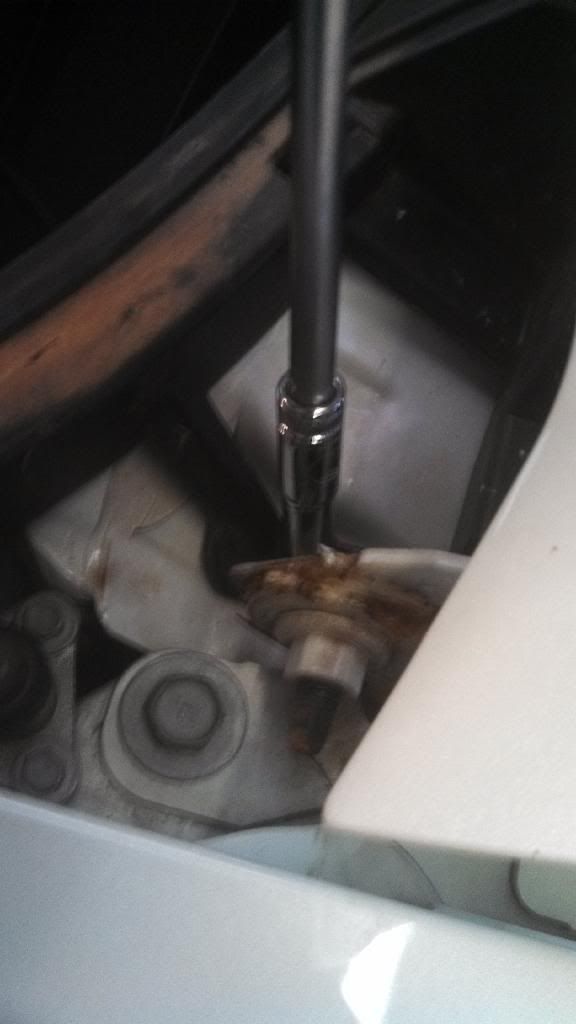

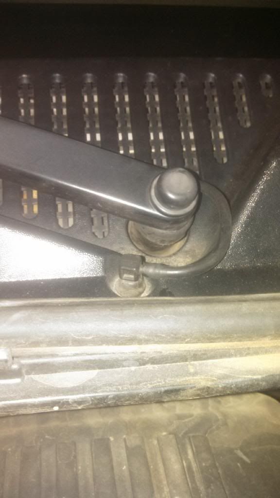

once you have removed both of those we need to remove the windshield wipers. they are usually a 15MM or a pull tab that releases them. I usually lift the wiper into the up position and rock it a little bit to make it come lose. (some wiper arms also have a washer line that will need to be unhooked, just twist and pull and it should come off)
(this is an 07' classic chevy, just pop the covers off with a clip tool and remove the [13mm] Bolts. You can see the washer line i referred to earlier)

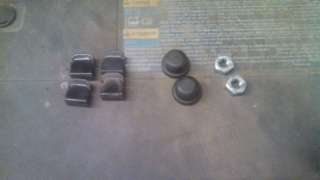

Now we are ready for the cowl to come off. first remove the 4 retaining clips on the front of the cowl (clip tool works well for this)
From left to right here are the (4) retaining clips, wiper caps, and the nuts for the wiper arm.

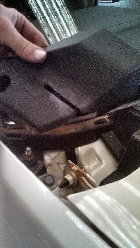

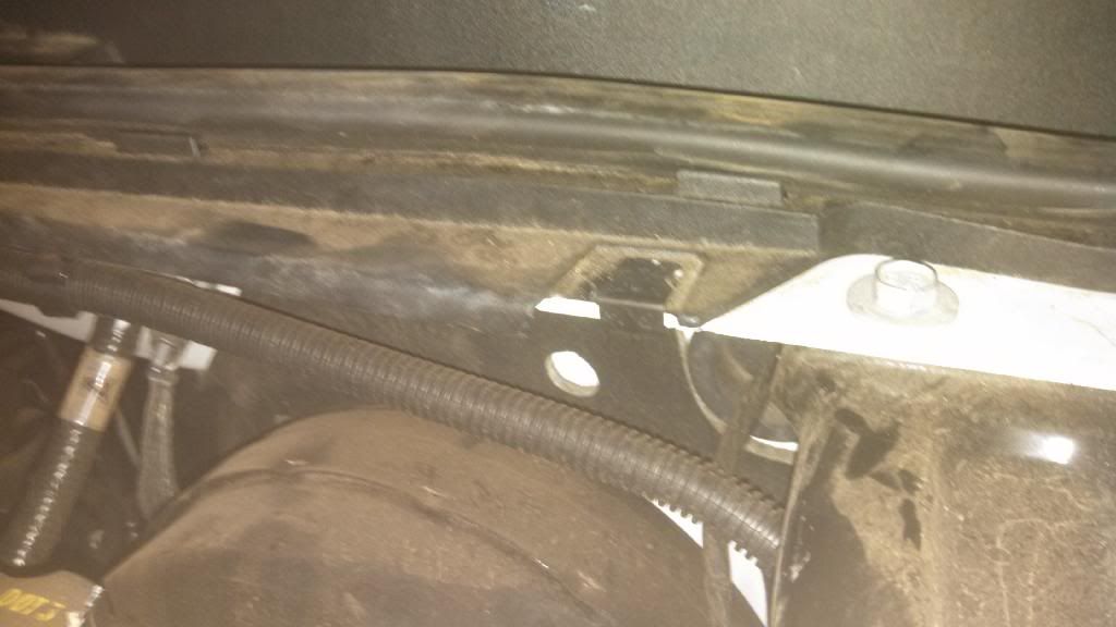

After the cowl is lose i normally pull it towards the front of the vehicle and remove it from the passenger side. There is a ground strap going to the hood that you can remove if it gets in your way (10MM nut). Removing the cowl can be aggravating sometimes so just be careful and take your time.

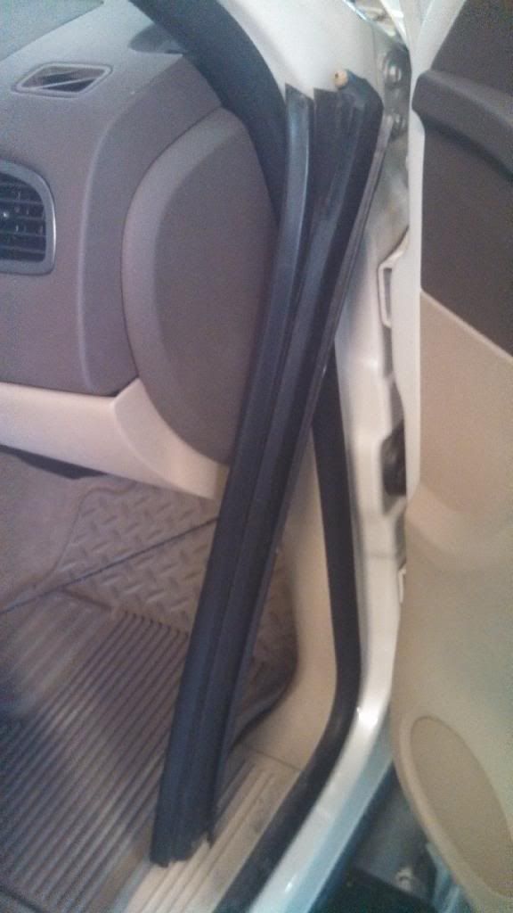

now we need to remove the side covers. Open the door and on the top of the cab running down the pillar you will notice a rubber molding, pull it up and it will come off.
Now you will have access to the torx bolts that are holding the side plate on. Remove all the screws except for the very bottom one. You should be able to just rotate it down and out of the way now.

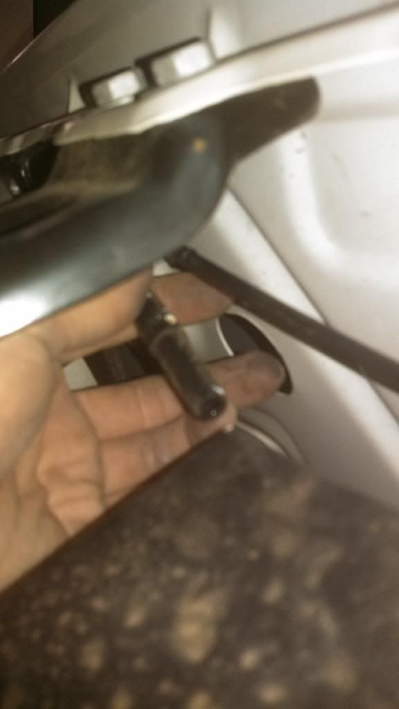

You need to remove your rear view mirror. there is one torx screw in the very bottom (t10 i believe) loosen it and the mirror should be able to slide up and off. Some vehicles have a wiring harness if so just press the release tab on the clip and remove it.

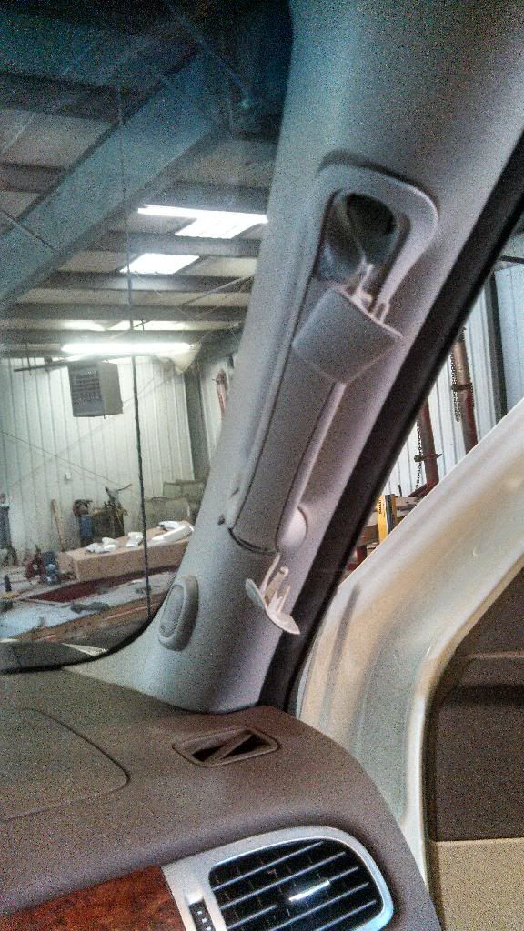

I normally will remove the inner pillar covers to prevent any mishaps. on this truck there will be a 7MM on the driver side and (2) 10MM on the passenger side. They are located behind two tabs.
Use a small pic or screw driver to pop the tabs off.

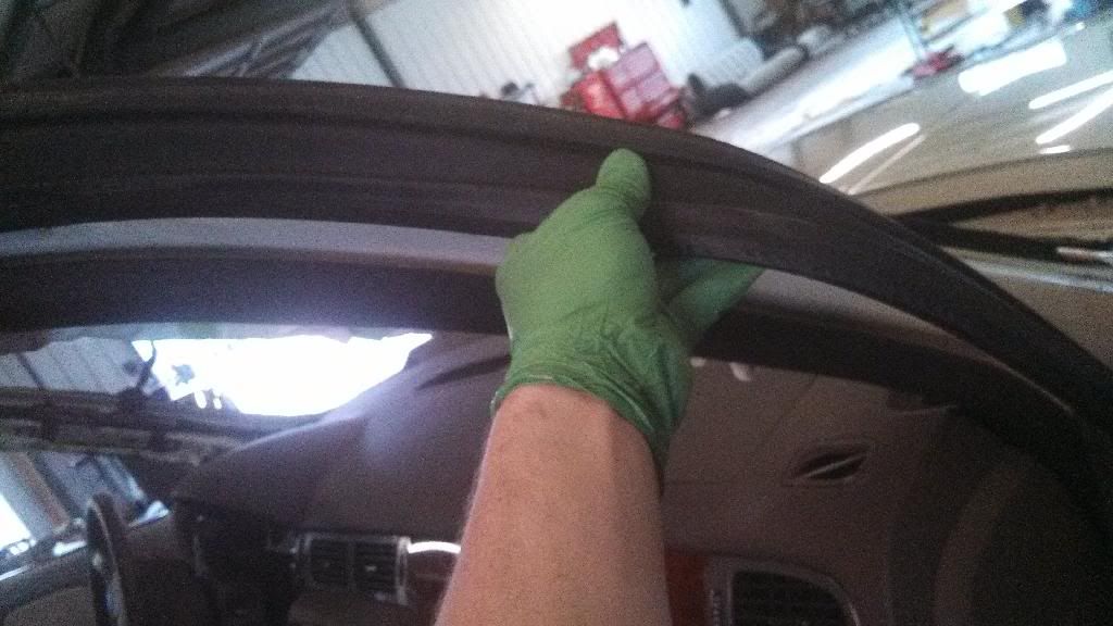

The first thing i usually do when getting ready to cut a glass out is remove any moldings that are made on the glass (if possible) On Chevrolet trucks there is usually just one on the top for the glass. normally if you can grab it with some needle nose pliers and then get regular pliers on it and pull up and back towards the rear of the vehicle you can remove it. If this does not work i take a razor and cut it as close to the glass as i can. This allows the cold knife to cut further into the urethane.

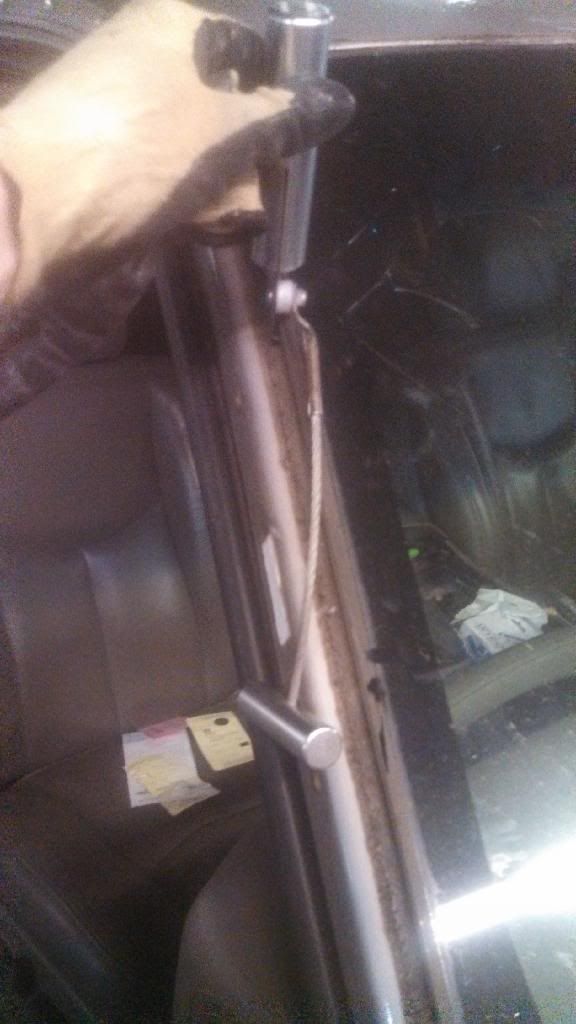

Now you are ready to try the cold knife, you want to holt the handle up straight in one and and push or pull the cable handle with the other. i would recommend watching a few videos on you tube on how to use it. You can mess the paint up pretty bad if you let this thing slip. you want to insert the blade of the cold knife in one corner and run it all the way down the side, then all the way across the top and other side. usually the cold knife will not get the bottom line of urethane.
(i pushed it in the top corner and just pulled it down the side. this does require some force.)
