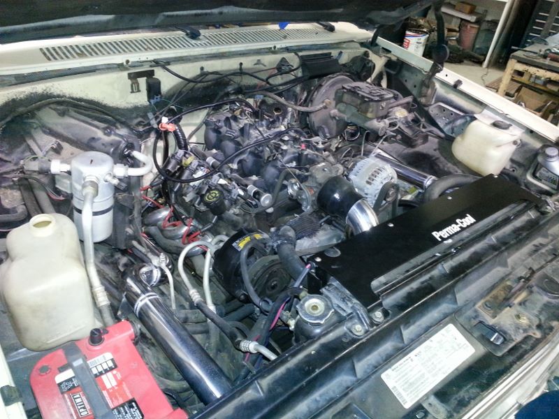

Re: Special A/C lines
« Reply #11 on: May 06, 2014, 09:21:50 pm »
This is the factory setup on my 1990 Suburban:
Same compressor and lines on my R10 with the LS conversion...
