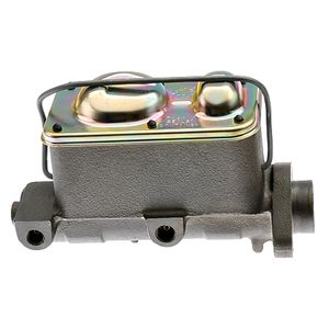

If your master cylinder looks like this then you have the JB1 (Manual brakes)

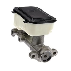

then you have
JB3, JB5, JD3 or JD5

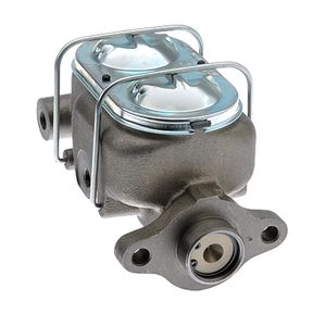

If your reservoir looks like this
then you have a JB6

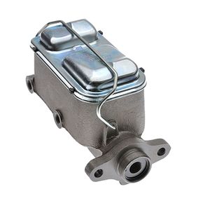

Then you have a JB7

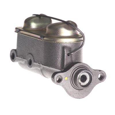

If you have a reservoir that looks like this
Then you can have a JB1, JB3, JB5 or JB6
JB1  plastic reservoir will have a bore diameter of 1.417"

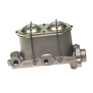

Then you have a JB7 or JD7
