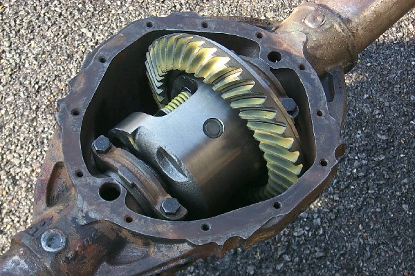

As to finding a rearend with a specific ratio it isn't a simple task.  The only sure way to know what ratio a 20 or so year old truck has is to pull the cover and check the gear set.  As for how to tell if it has a limited slip or not, you will be able to tell when you pull the cover.  A limited slip will have a spring or actuator of some type as a part of the carrier.  The factory 12 bolt Eaton's look like this:
An open diff will have no springs or anything in the opening of the differential.
If you are having problems with having enough power to spin 1 tire on an open diff, adding a limited slip will make is so it won't spin at all.   Sounds like you need to check the timing, mixture etc.
