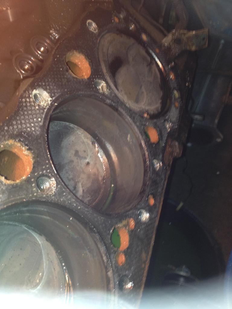

I am changing the heads on my 86 C10 just got the first one off and saw what i think is carbon buildup. If it is should i use some emery cloth and remove it or leave it alone. Of course i don't want to damage the cylinder walls or piston top.

That looks like carbon to me.
Inside the cylinders you should use a hone to clean it up. The pistons can be cleaned up with emery cloth, you have to make sure it does not fall down inside the engine though.

I was a little surprised that the piston stopped so far from the top of the cylinder. After i get it cleaned up and put back together is there any thing that i can do to help cut down on the carbon buildup?

Yes that's a little carbon, but nothing more than normal in a high mileage motor in my opinion. Yes probably could have been better kept up to this point with better fuel, but now we're here. IF you're tearing it totally down then use a ridge reamer to clean it up and then hone it out.....if you're just doing a head swap, I'd do little to nothing otherwise you'll get stuff in your rings and scratch the cylinders. And IF you insist on cleaning it with the pistons run a shop vac and just scratch it off with a screwdriver and Emory cloth LIGHTLY! Then run a long flat diamond hone (knife sharpener) over your head gasket surface, clean with brake cleaner, then (how I do it) coat your new head gaskets with copper coat from a spray can and reinstall the heads.

I do want to clean it up. I think that with the build up there now since i am replacing the heads i can clean it and then put more importance in to fuel system maintenance. I have had several people tell about the spray copper coat on the head gaskets i think i will use it.
