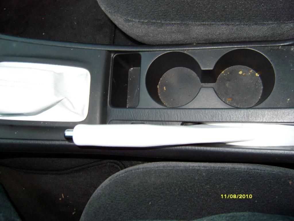

If your doing the door panel...I highly recommend dye. The dye will actually soak into the vinyl and plastic were as paint "sits" on top. With that part being were people grab to open and shut door, spin window crank, and rest arm...the paint would scratch and chip more.
Just remember with dye in aerosol....a lot of light coats so it has time to soak in between coats....you can make dye run very easy.
I did this 4 years ago, and it still looks brand new (sorry do not have pic from today) and I grab it prob at least 5 times a day if not more....never chipped, never cracked....looks like it came white from factory.

The other big thing people look over...is you have to make sure you clean them down good, because if it has ever been ArmorAlled then it is basically got grease all over it and the dye will not soak in (same goes for treated leather, I tried dying my original shift boot, but it was treated and failed....so I bought a white leather one).
I used dawn dish soap and a tooth brush at first....then used wax and grease remover after that, because I wanted to make sure it was clean.
