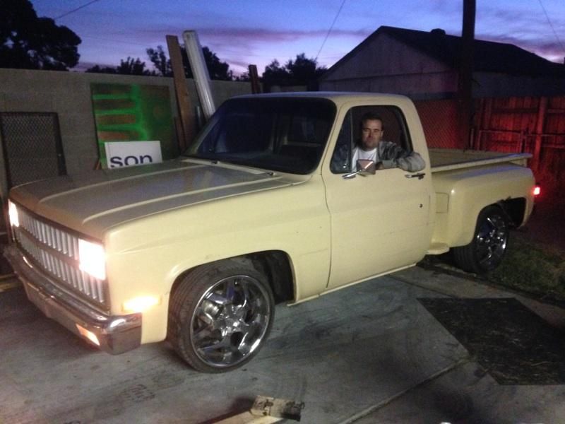

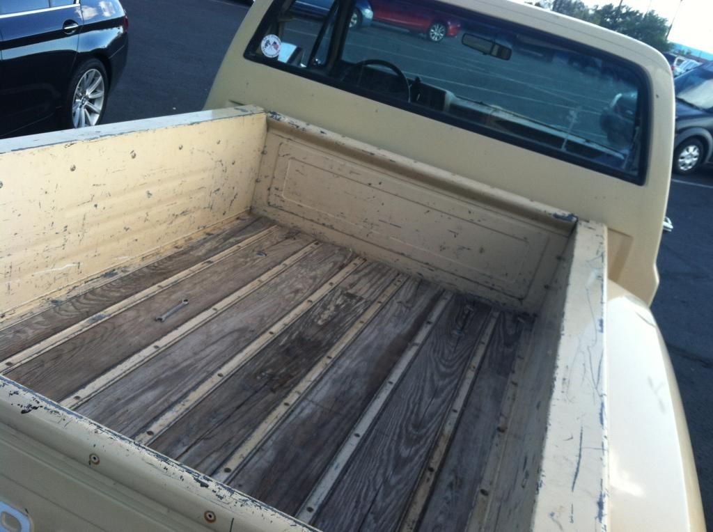

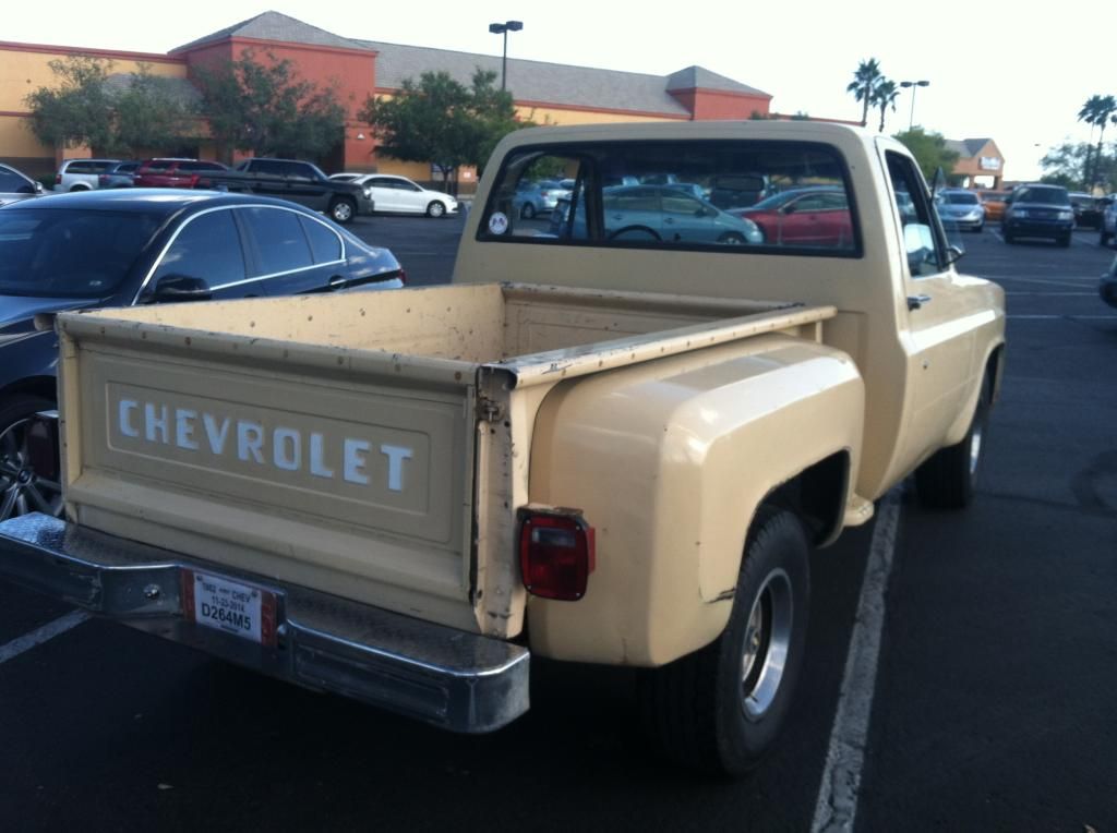

This is about my 6th old Chevy Truck, had quite a few Chevy muscle cars too...I like the squares best. My last was an 80 Shortbed, found a bent frame and dumped it. This one will be my last...I'm keeping it.

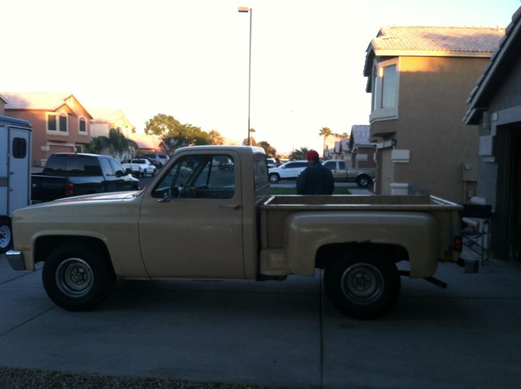

My buddy's uncle lost his marbles one day and never found them unfortunately, so this truck got parked. He was the original owner, 72k miles, AZ truck. 350/350(started out as a 6).

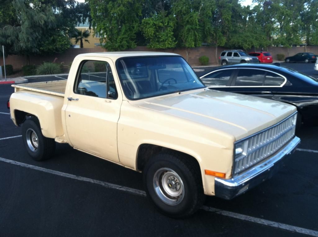

Anyways, I traded my homie for a pistol. We pulled it out after airing up the tires. He lives a few houses away. We put it on his lift, changed the oil/gas/battery...and it fired right up. Drove it 30 miles home, buffed it and put some tires on it.
(I'm on the left)
It cleaned up OK. The front passenger fender is the only real body damage. Shaved off the rain guard etc...
Got a set of dual exhaust from Summit, just passed emissions today...so I can tear all the smog off as it's being registered in a no smog county.
I've never been fond of stepsides, but it's growing on me. I think I'll cap the bed rail end and box the rear even with the tailgate...and put tail lights in there. I'm good with a welder, and grew up around a body shop.

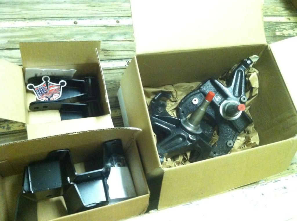

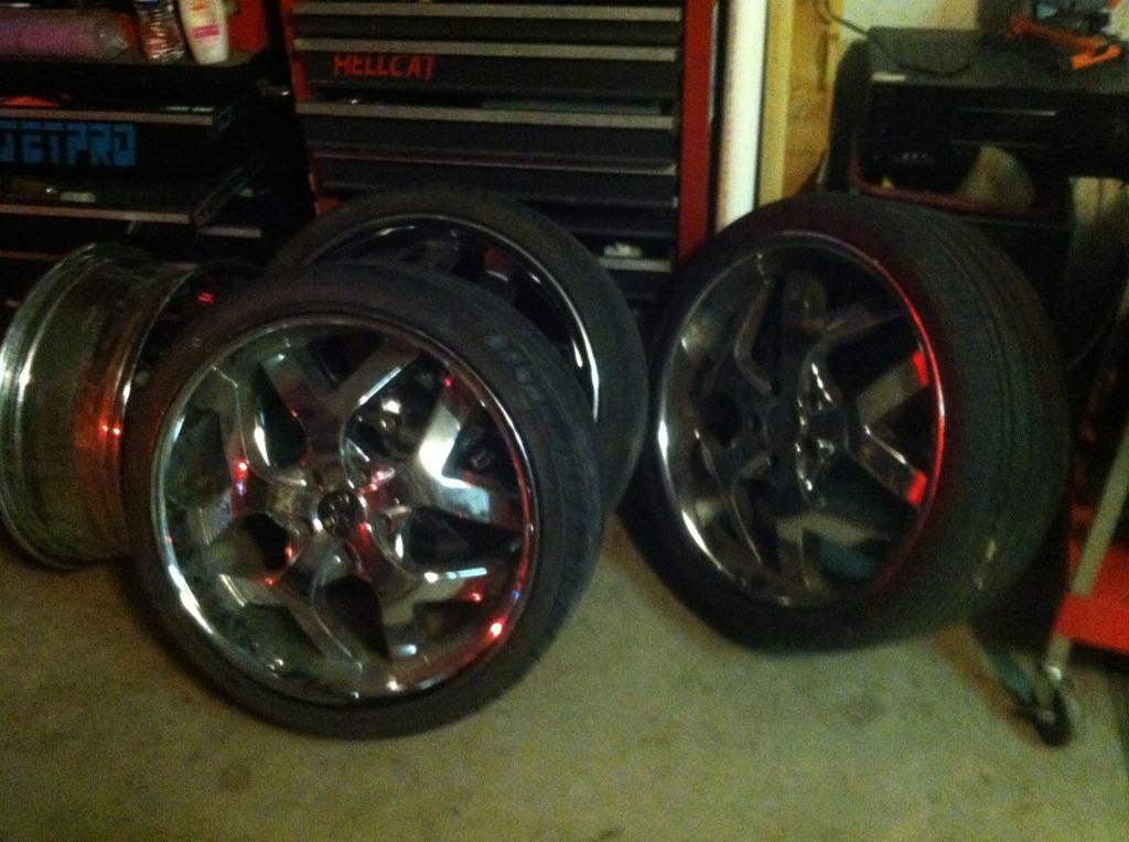

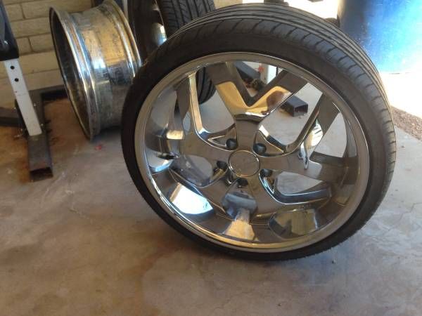

Got the drop kit today, and some 20x9 wheels with an acceptable offset.
Not real particular on the wheels, I know how to give them a brushed stainless look.
I'll put some taller/wider meat on them.

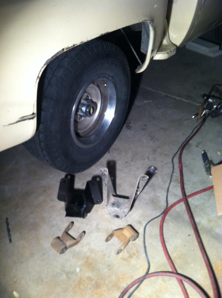

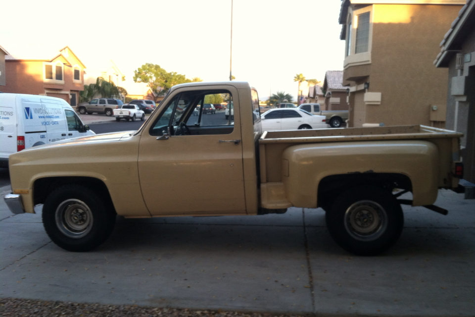

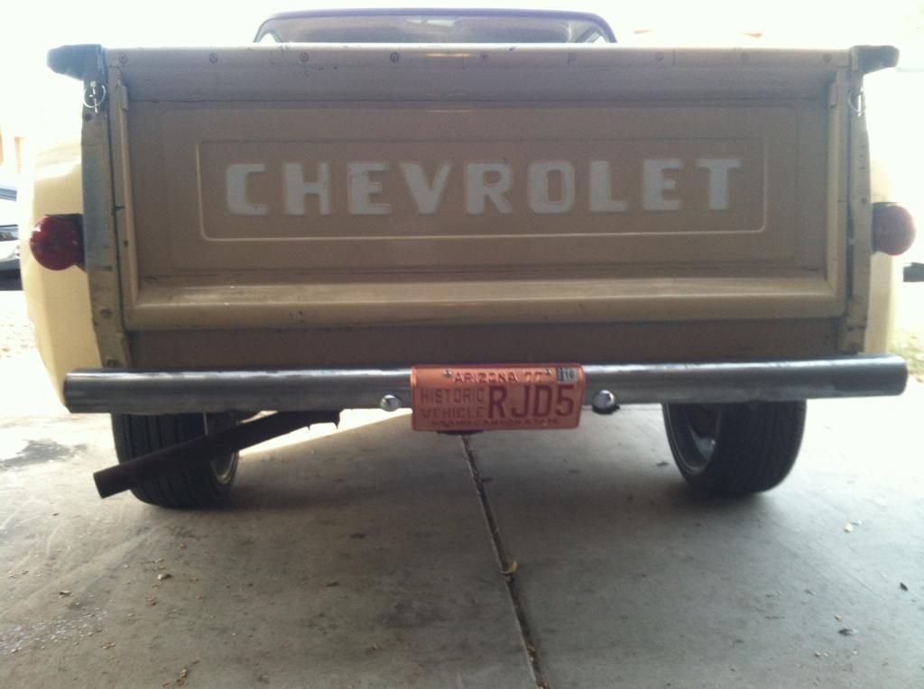

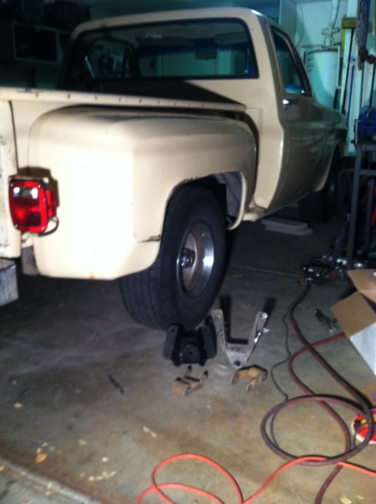

Well, I did 3/4 of the rear drop. Got tired.
Gotta drop the tank to do the last part, and grind a hair more off the bed rails. I took off as little as possible and need another 1/8"
Looks like it's gonna be sittin nice :)

« Reply #8 on: November 16, 2014, 06:35:56 pm »
Got the 4" drop done on the rear.
Now it's an 1.5" lower in rear than front.
Next weekend the 2.5" drop goes on the front so it'll be sittin right.

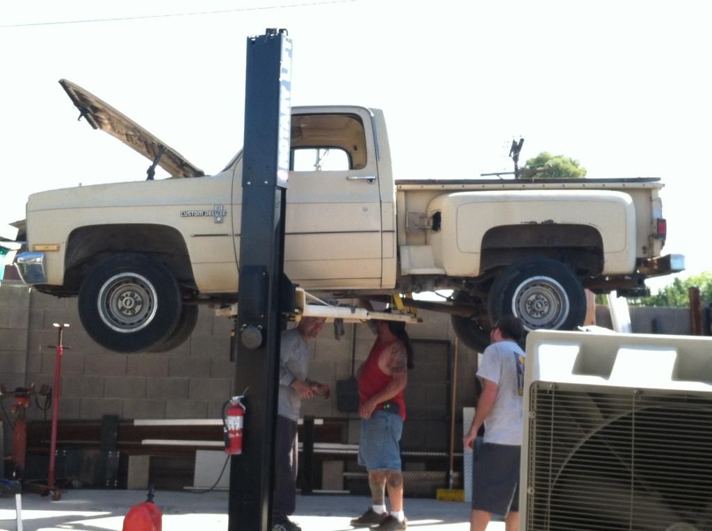

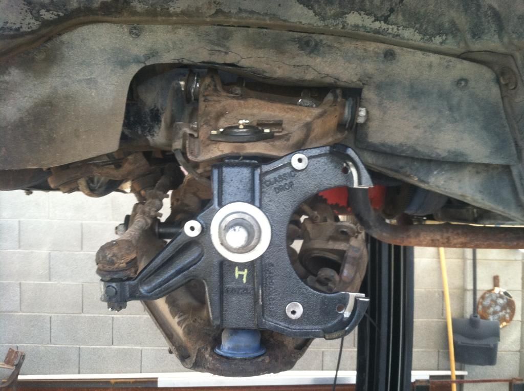

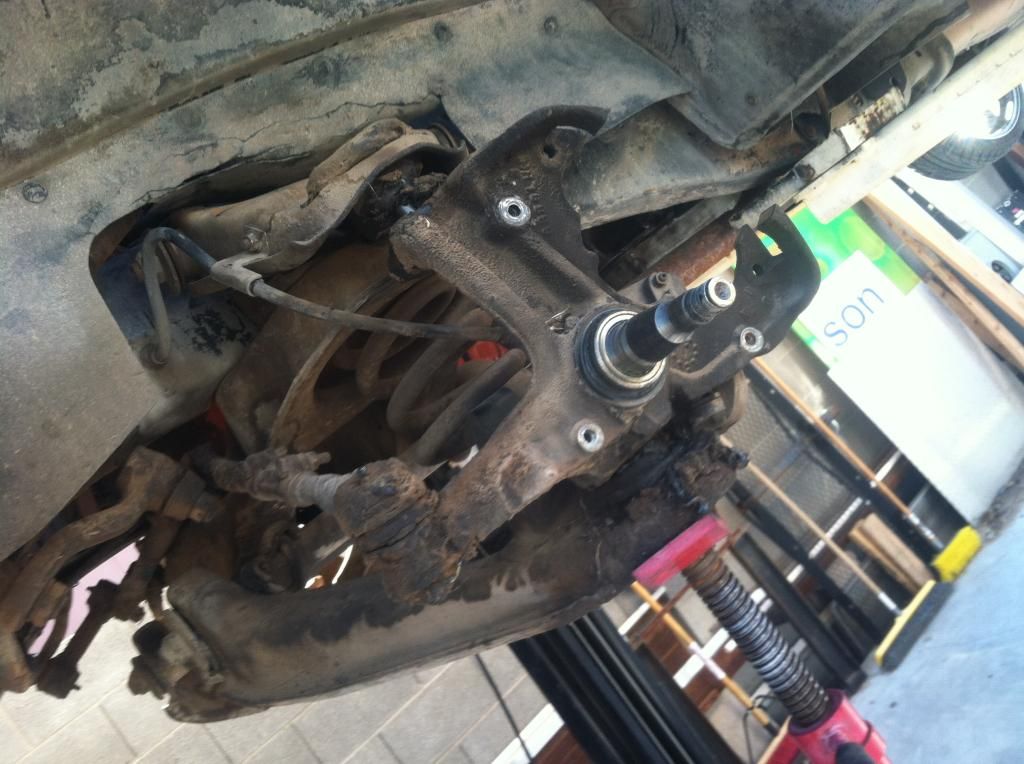

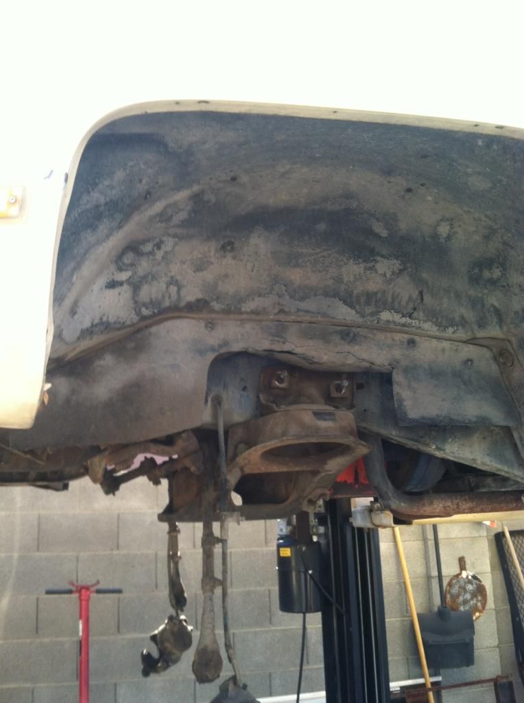

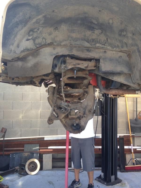

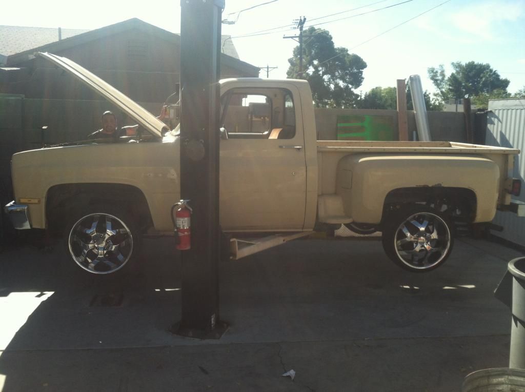

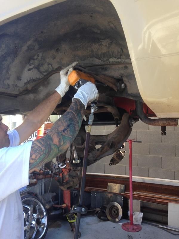

So, I took it Ray's to do the front end drop(2.5" spindle drop).
It's a Summit Racing 2.5/4 drop.
I got all new bushings/balls joints. After we got it together, we put(tried to) the rotors on...the inner bearings were too small(ID).
Found out the hard way that the drop spindles are made for the 3/4 Ton version of 73-87 Chevy Trucks(makes sense)
Had to but the bigger rotor, inner bearing, caliper and pads. It's all good :)
We put it up on the lift...
Tearing it down...
My homie Ray...
Me...
Reassembly...
Done...
Now I gotta measure...so I can see what kinda meat I can get on it. I wanted 4 tires the same size...might have to do bigger rears.
I need a new goat, mine is worn the heck out!

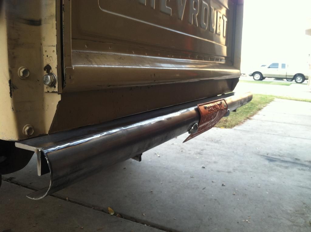

« Reply #12 on: December 14, 2014, 06:32:58 pm »

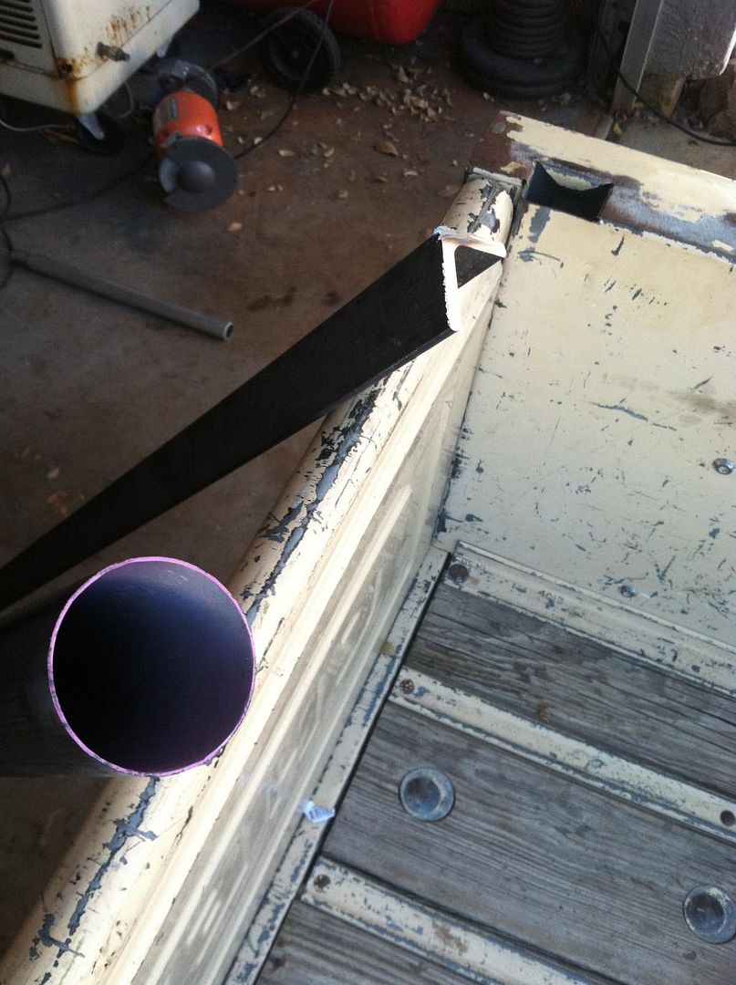

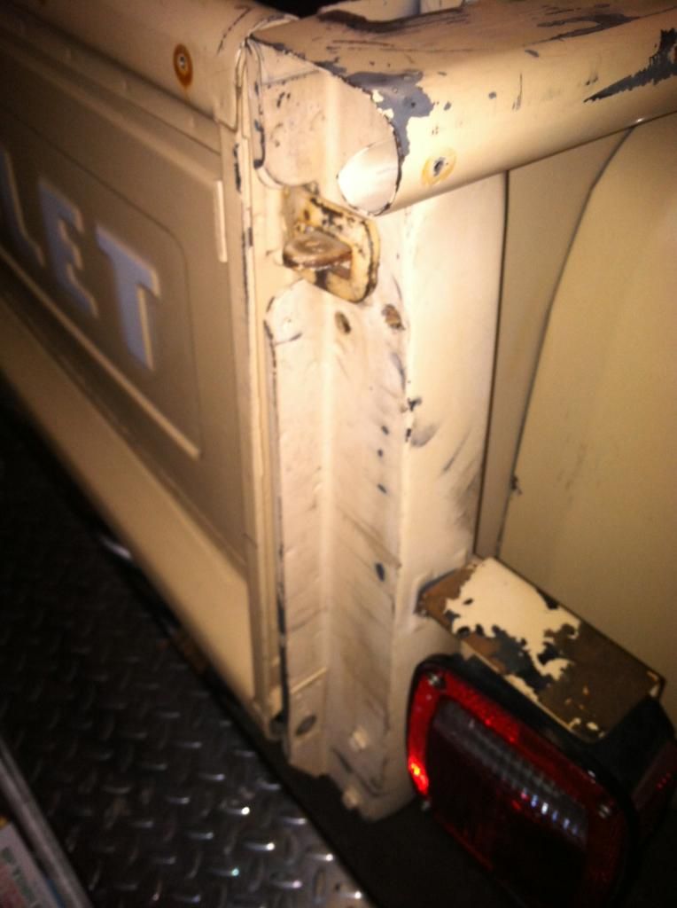

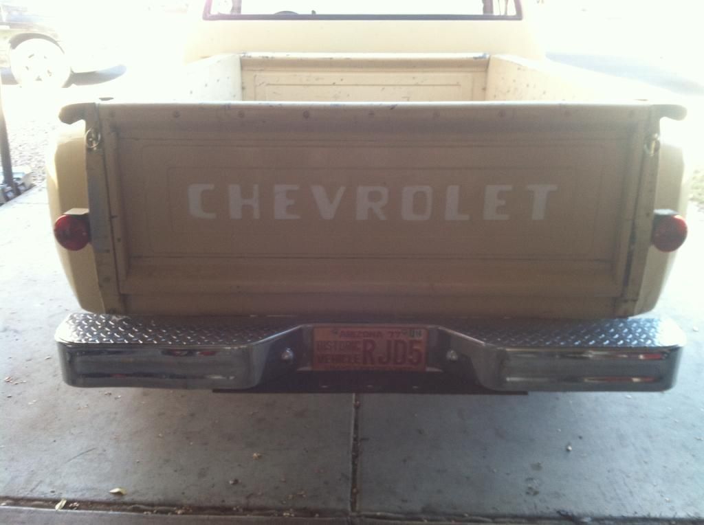

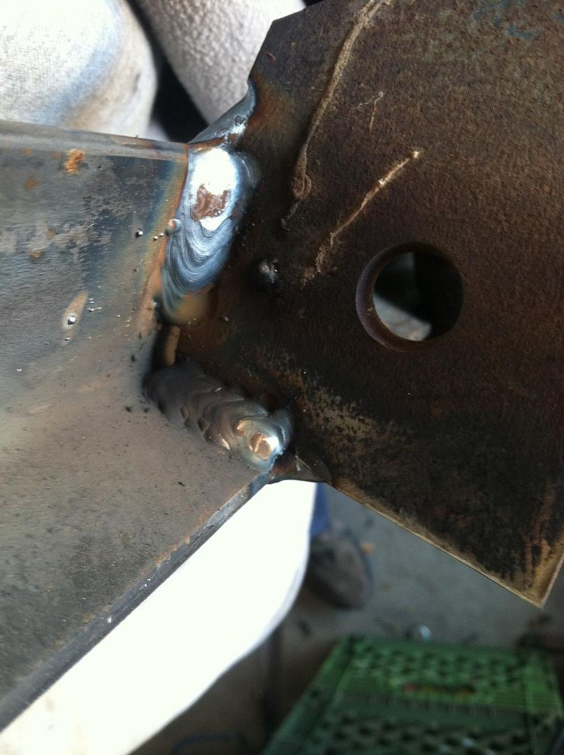

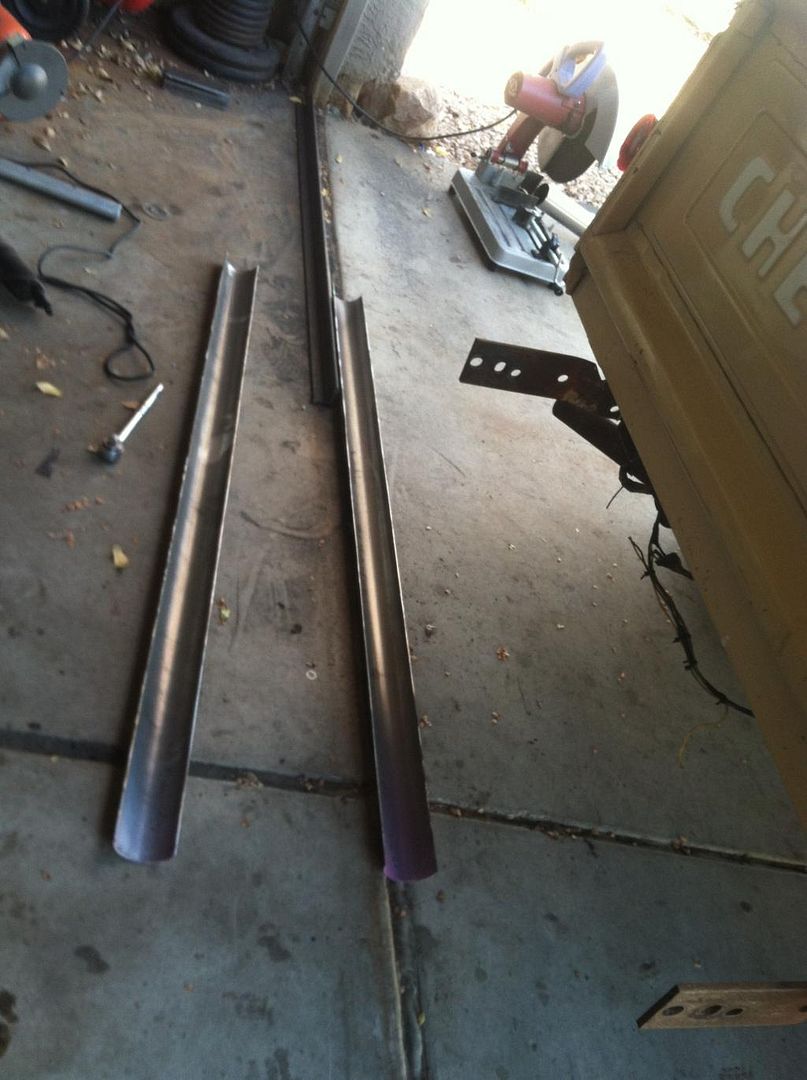

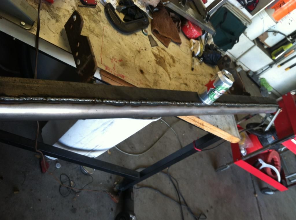

So, I did some temp tail lights. The lights will end up in the bumper.
I got a good start on the bumper, never really found a decent one read made.
I made this one to match the bed rails, and look similar to an extended roll pan.
I'll end up capping the bumper to match the bed rails after I figure that out.
There will be some boxing and capping going on soon lol.
