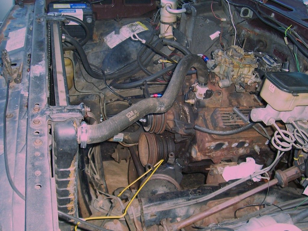

As you can see, the 4.3's radiator hoses do bolt directly to the 8 cylinder radiator:
Thanks for the info about the downshift cable. i'll take care of it later as the truck will run without it.
