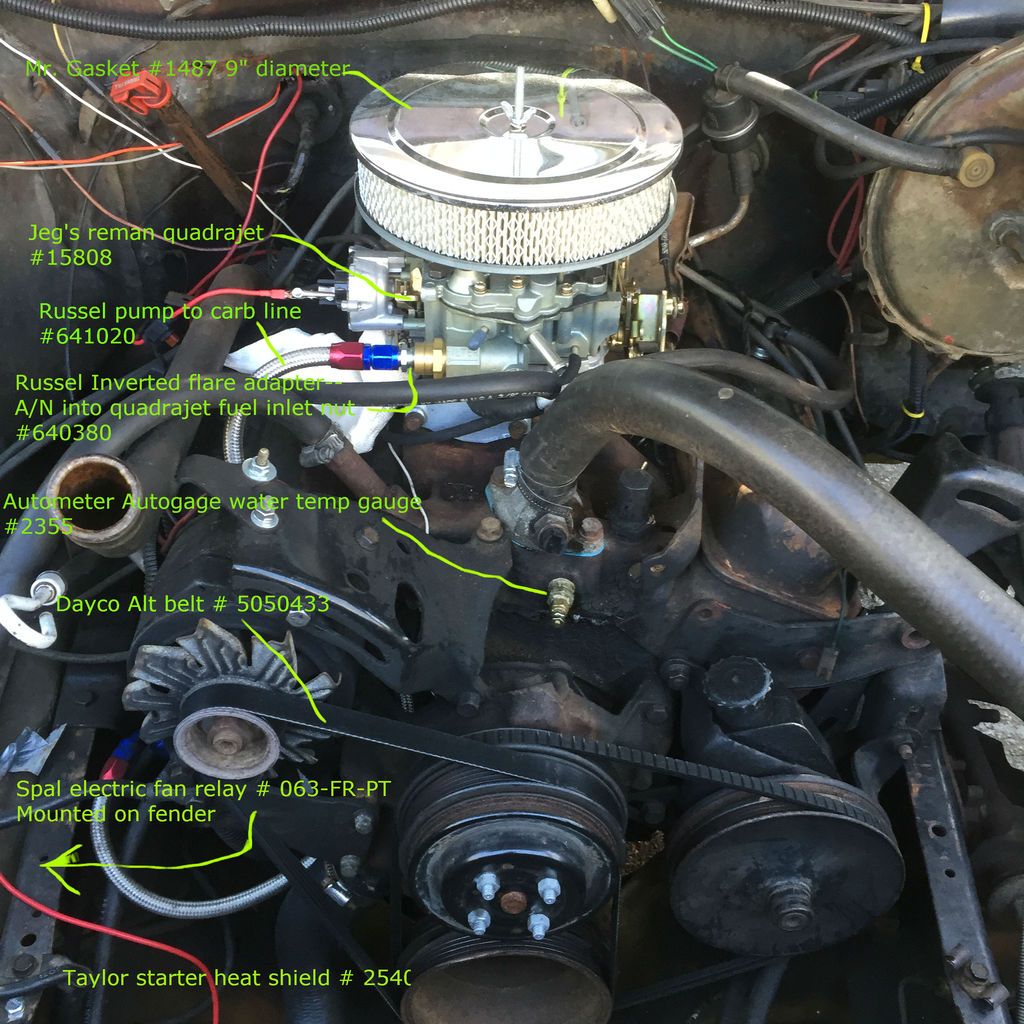

i basically did this diagram for my own reference:
Lotsa room:
Notes: i got the Mr. Gasket air cleaner because i needed the truck running fast and they had them at the local parts store, i am planning on getting a K+N when this one plugs.
i really like the flexible braided pump-to-carb line.  One advantage to using one is i can run many different carbs with it----if i need to run B.O.P. quadrajets, not a problem.  Very easy to disconnect and connect.

So i basically got the thing running in October and i actually had 3 carbs on it before finally getting the Jeg's reman---which runs well.   i actually had a Rochester 2G on there with an adapter and it actually ran pretty good----until it  flooded out and i decided since i didn't know the rebuild history on it, that it would be better not to use it.  The other two quadrajets i had---the one that came with the engine didn't idle very well and the quad that was original to the truck just didn't idle at all----probably sat around too long.   So i decided to try a Jeg's reman.

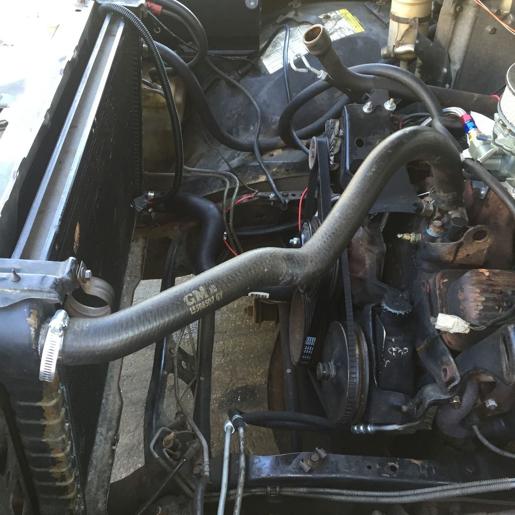

The v-6 radiator hoses bolt right up to the v-8 radiator.   The v-6 mounts were actually pretty easy to put in--- only took a few minutes to drill new holes (3 on each side) in the frame.  It's gathering all the other do-dads that is time consuming for this kind of swap.   The v-8 power steering lines can be used with the v-6 if you take the frame clip off and pivot the lines towards the engine.
