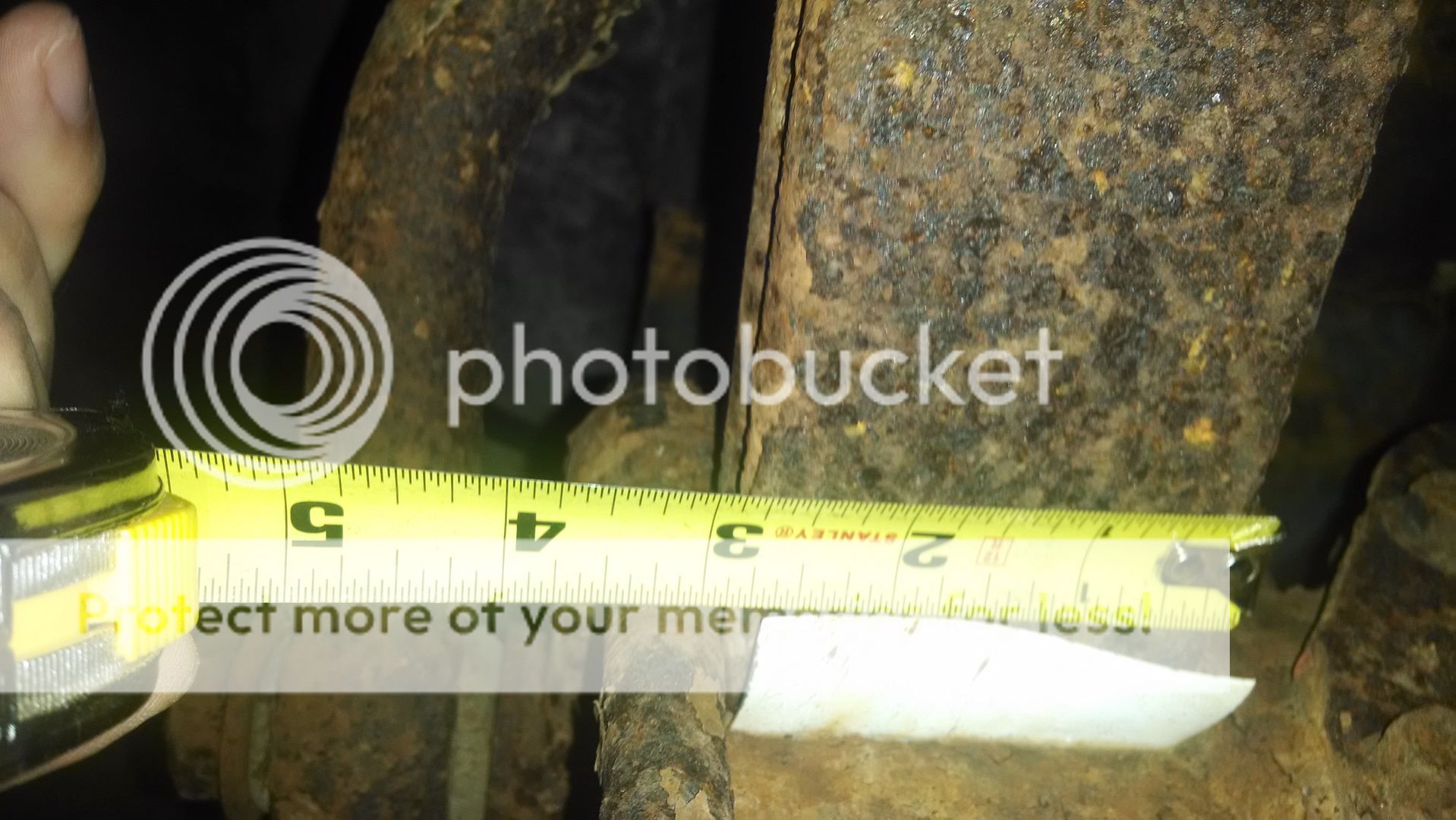

Can't find my pictures right now think I put them on my PC but remeasure the spring as close to the axle as posable my 1 ton is close to 2.5

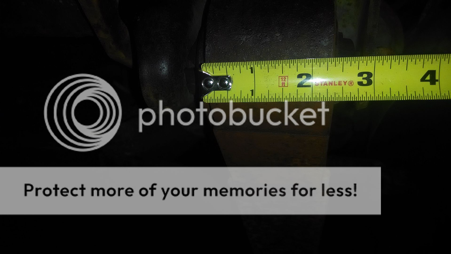

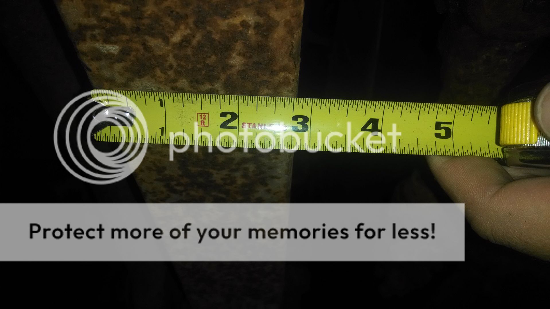

these are of my 1 ton front springs. they are considered 2.5" but i was wrong about being close to the axle thats were its close to 3"
