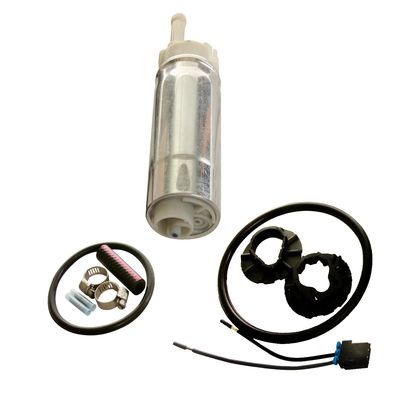

Only issue I have now is that I think that the drivers tank pump is weak. When I select that tank, it slowly starts to spit and sputter and eventually dies. When I select back to the passenger tank before it dies, it picks back up and runs normal. I'm going to make sure I'm getting the correct voltage at the plug going into the valve and if its good I guess its a bad pump, unless you guys have another idea. That pump is less than a year old.

Do a fuel pressure test at the output from the drivers side tank, if it's below spec then your probably right about the pump being weak.

could also be the rubber line that connects the fuel pump to the assembly
it comes with a new pump anyway but it can rot and crack and cause loss of pressure.
