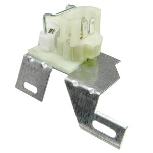

So just an update, I finally tracked down my no headlight issue. I was checking wiring at the column last night and noticed a plug with three wires, two of which being the green and orange that carry the high and low beam from the firewall to the headlights. I pulled the plug off the bottom of the column and used my power probe to find it had a 12v source from the headlight switch. I ran a jumper wire from the yellow (12v) to the green then to the orange and had headlights! So I plugged it back up and noticed when I click the multi function switch on the column like I would be switching from hi to low beam, yhe plasic piece that the plug is attached to moves back and forth at the bottom of the column. My question is what is that piece and do I have to drop the column to get to it or can it be unbolted from the bottom of the column?
Re: No Headlights
« Reply #5 on: March 11, 2015, 12:19:32 am »
does it look like this
if it does its the headlight dimmer switch just click the picture
