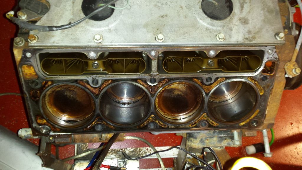

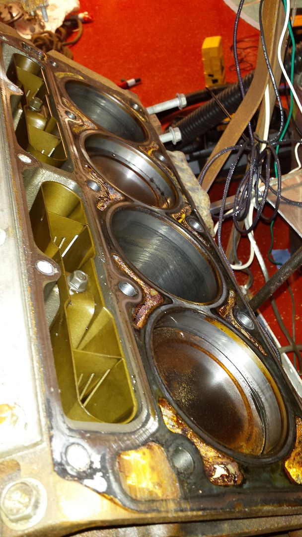

103,000 miles and still looking like a slightly dirty baby..
Look at that cross hatch!

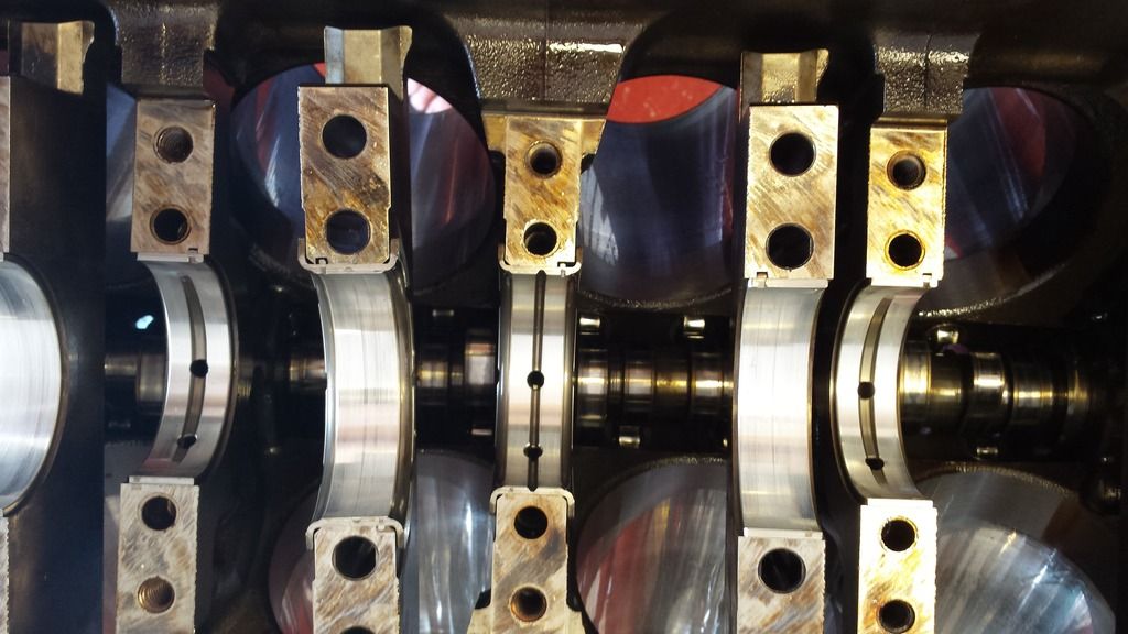

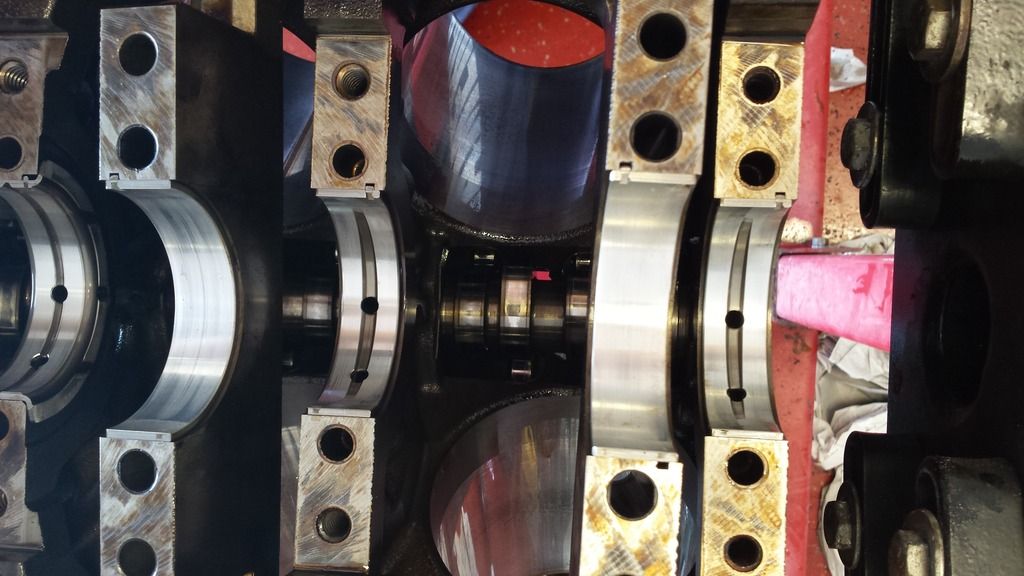

Slight update as well...
Engine is stripped and looking good!
Bearings all look good. No real issues including con rods. That's a relief!

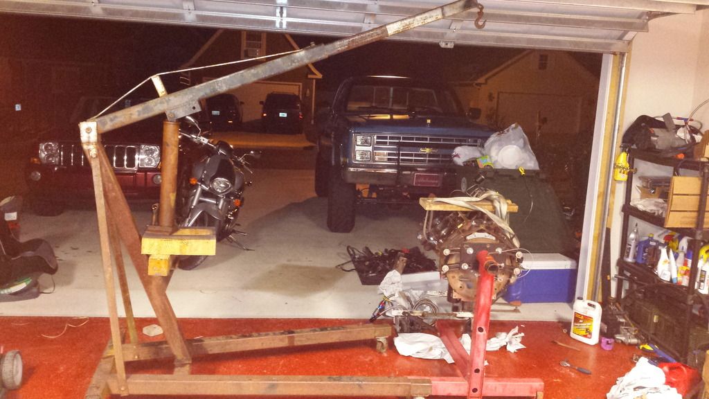

Just add a chain fall. ..
 Not the safest but it's what I had to work with. After this we lifted the 5.3 off my buddies flat bed for his jeep project that I got hooked into..I don't really mind though
