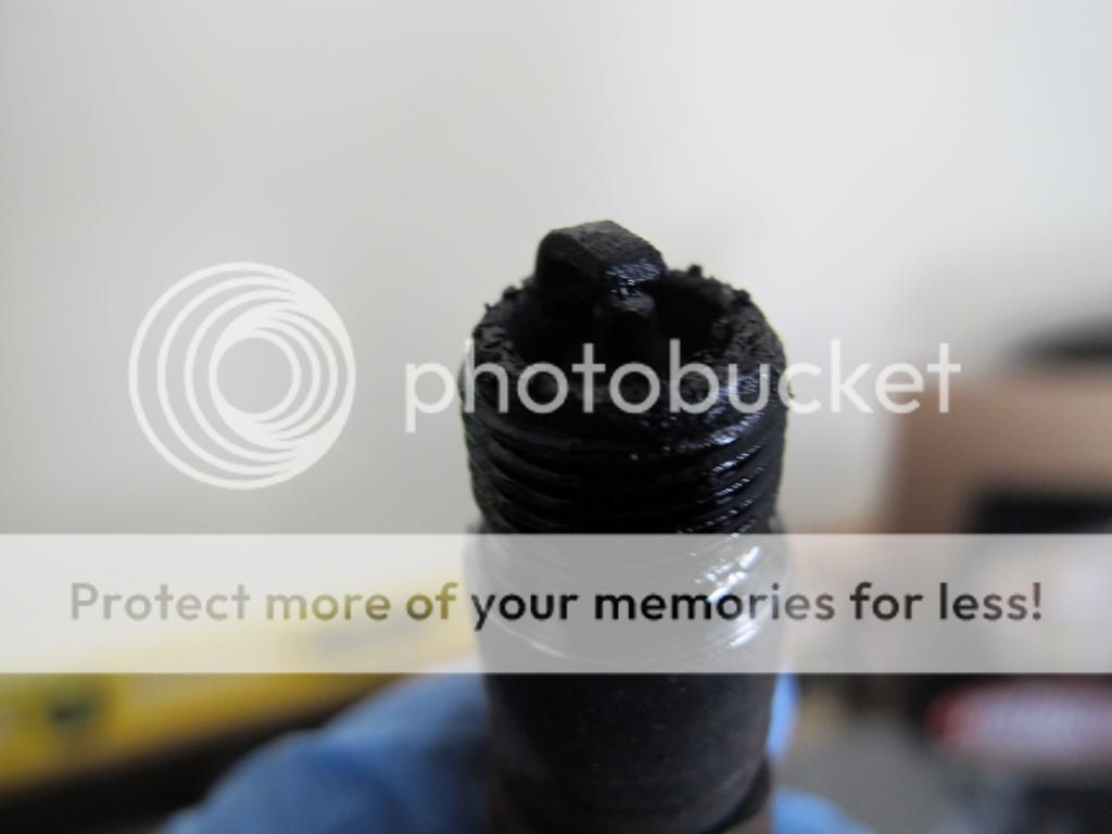

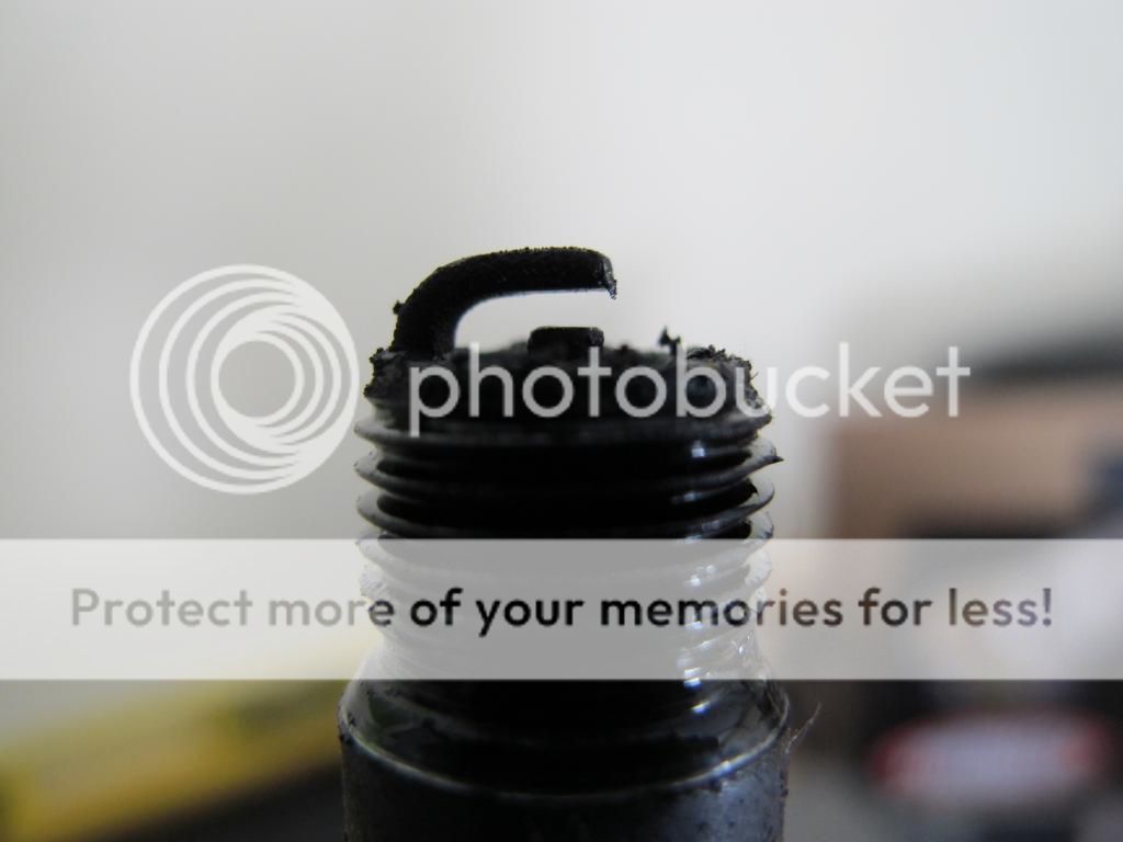

Forgot, these are what the plugs look like.

« Reply #4 on: March 02, 2015, 04:49:47 pm »
Plugs looking like that would cause it to stumble under load.  Clean em or change them and go from there.  Definitely running rich...

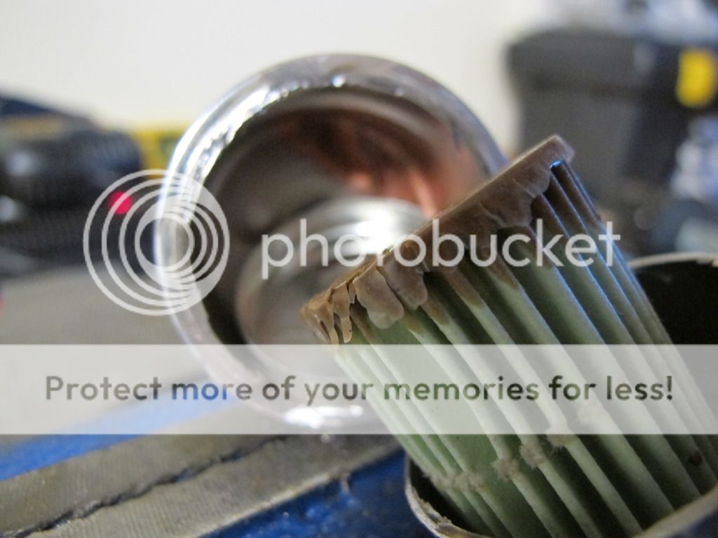

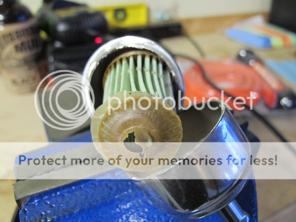

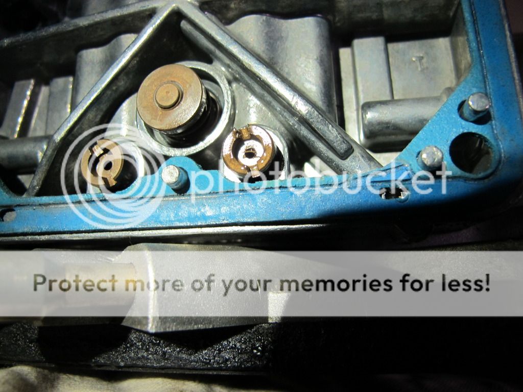

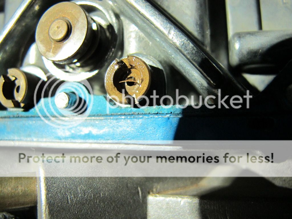

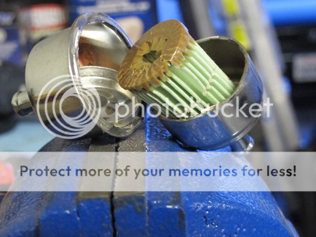

« Reply #14 on: May 10, 2015, 12:48:17 am »
Quick follow-up. I can't call it a victory yet but I'm 98% sure this is the problem. See pics. One picture shows a primary fuel jet blocked off by a thin layer of caramel looking substance. I took off the fuel filter, which I'm guess has only been used 200-300 miles city driving. This caramel looking substance was also found in the fuel filter. When I shake it, it rattles loose. I cut it open and you can see for yourself. I believe this caramel looking substances came from the cardboard ends of the filter element. It just came apart, deteriorated.
What I learned from this:
1. I'm never going to buy these cheapo filters again.
New Wix filter put on, tune for air/fuel mixture screw for max vacuum then will test drive tomorrow.
Also, the hot start issue described above was due to fouled plugs. Ran the R44T and am now running R45T, mostly as I drive city and want the hotter temp for short drives. These were fouled as the float setting was set too high I believe from manufacturer. This has cleared up thus far, starts each and everytime beautifullly now even when hot.
Hope this helps others out there.
