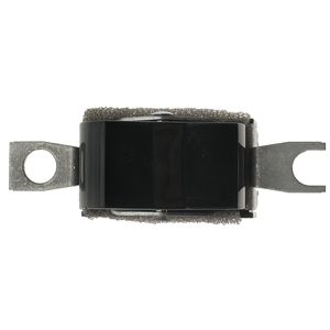

So in case anyone finds their dashboard tank switch to be DOA (see picture for example of switch) it can be replaced with an ordinary "double pole, double throw, MOMENTARY" switch. Examination of the OEM switch reveals that all it does is connect the pink wires to the green wires in one direction (left hand tank) and reverses "polarity" on the same connection in the other direction (right hand tank). Connect pink wires to center pins of DPDT switch, green wires to one pair of "outboard" pins. Make "jumper" wires from other set of "outboard" pins that connect to the pins with the green wires making sure that they CROSS over side to side. Most of you are probably laughing at this simple post, but hey, I had to noodle this up for myself and maybe someone out there is also scratching their cabeza. One more thing, I had to make a cover plate to mount the toggle switch and cover the rectangular hole in the dash, so not for the show crowd...
this whole deal is just to save bucks.
