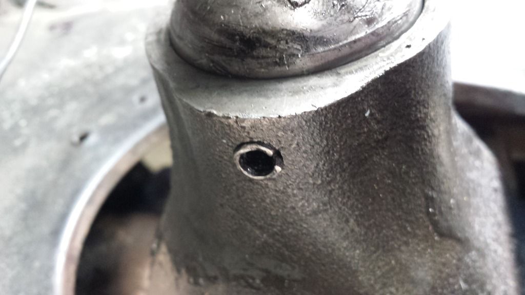

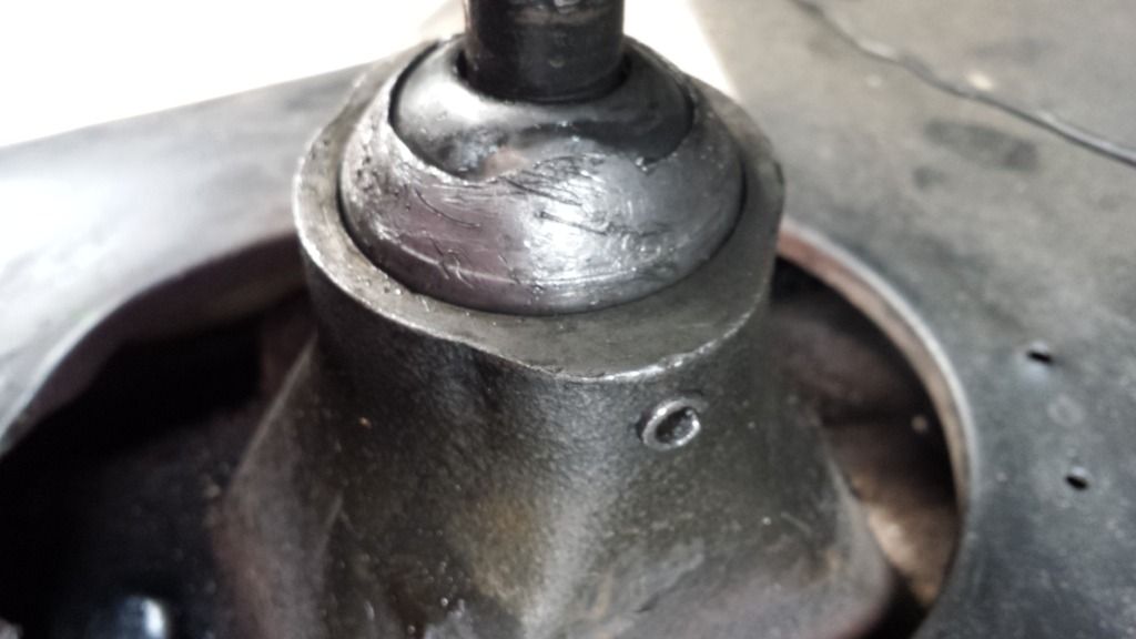

so these pics are showing the pins fully in... when they are like this i cant move my shifter at all...i wiggled the pins out a lil bit cuz thats the only way i could get them to come out...anyways i pulled the pins and put them in only 3/4 of the way and it works fine now. i think i might leave it like this because i wanted to buy a new nv4500 5 speed to throw in this truck...
here the pics

So I came back to this problem the shifter will not shift unless the pins are at least halfway out any reason to why?
Re: shifter problems
« Reply #14 on: June 10, 2015, 12:31:56 am »
Pull the shifter out and see where they are hitting causing it to bind
