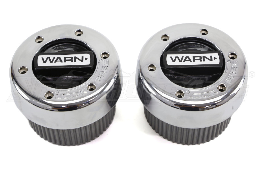

Oh, and a set of these is also on the way.
