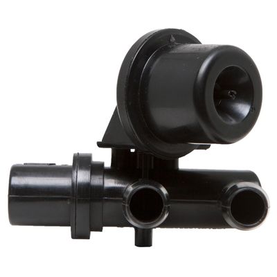

Re: '79 heater hoses
« Reply #8 on: August 02, 2015, 08:48:09 am »
when i worked at autozone i never understood why ford had a heater control valve. but it makes perfect sense
you can either apply vacuum to use the bypass or you can remove the vacuum solenoid and operate it like on on off switch
part number 74809 or 5954
you can find them on many fords but one is a 96 aerostar
if you do it this way you will keep coolant in the heater core and the water pump can still utilize the hose thats hooked up
think the hose ends are 5/8"
