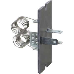

Morning Folks,
I'm looking for the rear blower motor resistor for my 1980 Chevy Silverado Suburban (AC). I've called Napa, Autozone, O Reilly's, so far all the resistors they've got, don't match up with the factory 3 prong connector...

hows this look?
AZ part number
20081 or DR762 these numbers cross to each parts store. autozone list it as for non-a/c but its the only 3 prong i see

I brought the wiring harness to the store and tested that one to see if it would fit, it was a no go. The top flat spade connector it too far up compared to the connector. I'm almost about to just order one, if I can't find one at the junkyard this morning.

It appears as though the factory rear blower motor resister was manufactured by a company called Indak, the part number is 3929051.
For all those who are looking. I found one, I'm currently in the process of refurbishing it before reinstallation.
