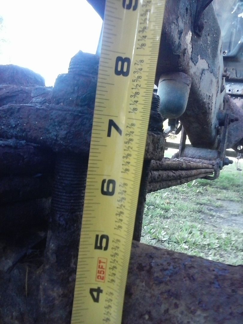

U bolt's should be 5/8"x3"x7 5/8" and one 5/8"x3 1/2"x9 5/8", Also because of how they are tightened, it's suggested to never reuse them.  Cheapest I found when I was looking are these

Offline 1967KaiserM715
  • Posts: 914
  • 1985 GMC K1500 w/ 6.5 TD
Re: Bump steer? 86 K10 with a 4" lift
« Reply #29 on: September 11, 2015, 04:44:23 pm »
Front
http://www.summitracing.com/parts/tfy-17701
Rear
http://www.summitracing.com/parts/tfy-17751
for front yes, my rears(with 4/1 springs) are 8 1/4" tall
and no shims, what I saw was a rubber flap, no clue why it is there, maybe its like some of the teflon sheets some new springs come with
Here you can see that rubber flap between the spring and perch
(Angle is a little off, 7 5/8" is correct)
