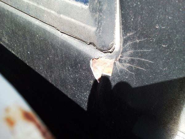

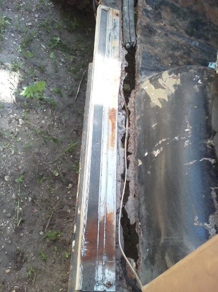

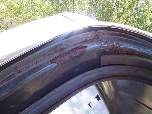

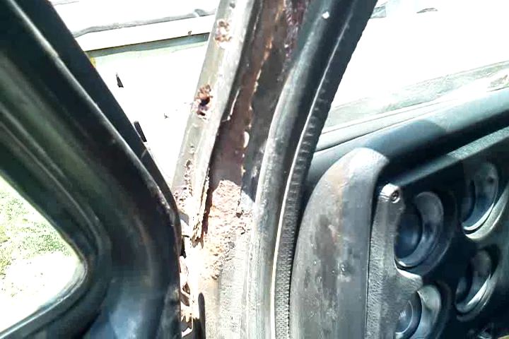

Stewart G Griffin, Good point, I spose I could post some pictures....and videos.
Click on these for video

Judging from the pics and videos ( i didn't see all the videos but some), it's not that bad.  i would paint over all the rust with POR-15 to stop it from spreading.  As far as places where there are massive holes, i would weld those up;   i want to make things as easy as possible and to me it would seem easier than to swap a cab.  Remember you still have to LOOK for a usable cab, bring it home, then take everything off the old one and put it on the new one etc. etc. etc....
The fact that i enjoy welding might have something to do with it, but i do want to make things as easy as possible and if swapping was easier i would do so, since there doesn't seem to be much sentimental value to the cab.
And really if the cab is safe, and it appears basically so, i would just leave it as is and get to welding when i get to it.
But that is just me.  i don't think there are any right or wrong answers here.  IF you're really interested in getting a new cab then by all means proceed.

I completely agree, it's what I have, why be wasteful? They are not built any longer, so fix it. I am not a good welder, I can stick two pieces of 1/4" together reliably with a $5,000 dollar Miller wire welder, sticking two 18 gauge sheets together with a 110volt welder is entirely different. However, I did practice some last summer on my mower conditioner. The knock-over bar (thin walled tubing) had huge rust holes in it and was cracked pretty badly on both ends so I welded them closed. It was good practice. But my new auto darkening helmet kept quitting and I got flashed about every other time I struck an arc. Come to find out the trip from China must have occurred in a submarine because the battery contacts were badly corroded. Scoured them clean and new batteries and it works like it should against the sun, haven't been welding much in the freezing temps we are having now. In the meantime I'm collecting different size wire and tips and other welding accessories like those I used at the shop at work. Now I just need to figure out the best source of/for the best quality parts to weld in.

They can be  expensive, but   has some pretty good stuff. You might even be able to find a new rocker panel for that driver side.
