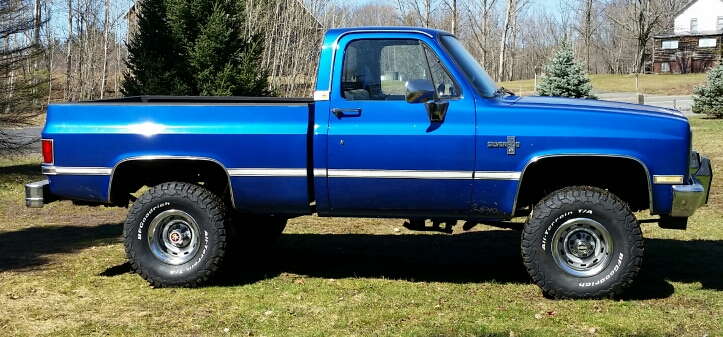

Offline 85K10SB
  • Posts: 39
Re: Rough Country 2" All Spring Lift Experience
« Reply #24 on: March 19, 2016, 09:52:49 pm »

Does that truck have a body lift? That looks far more than just 2"

 I think it's an optical illusion, with the 33's. A 4" looks very similar with 35's, but side by side comparison would probably be noticeable
No it doesn't have a body lift.  Before and after measurements showed that it went up 2 7/8".  Guessing the factory springs were sagging pretty bad as I suspected.
