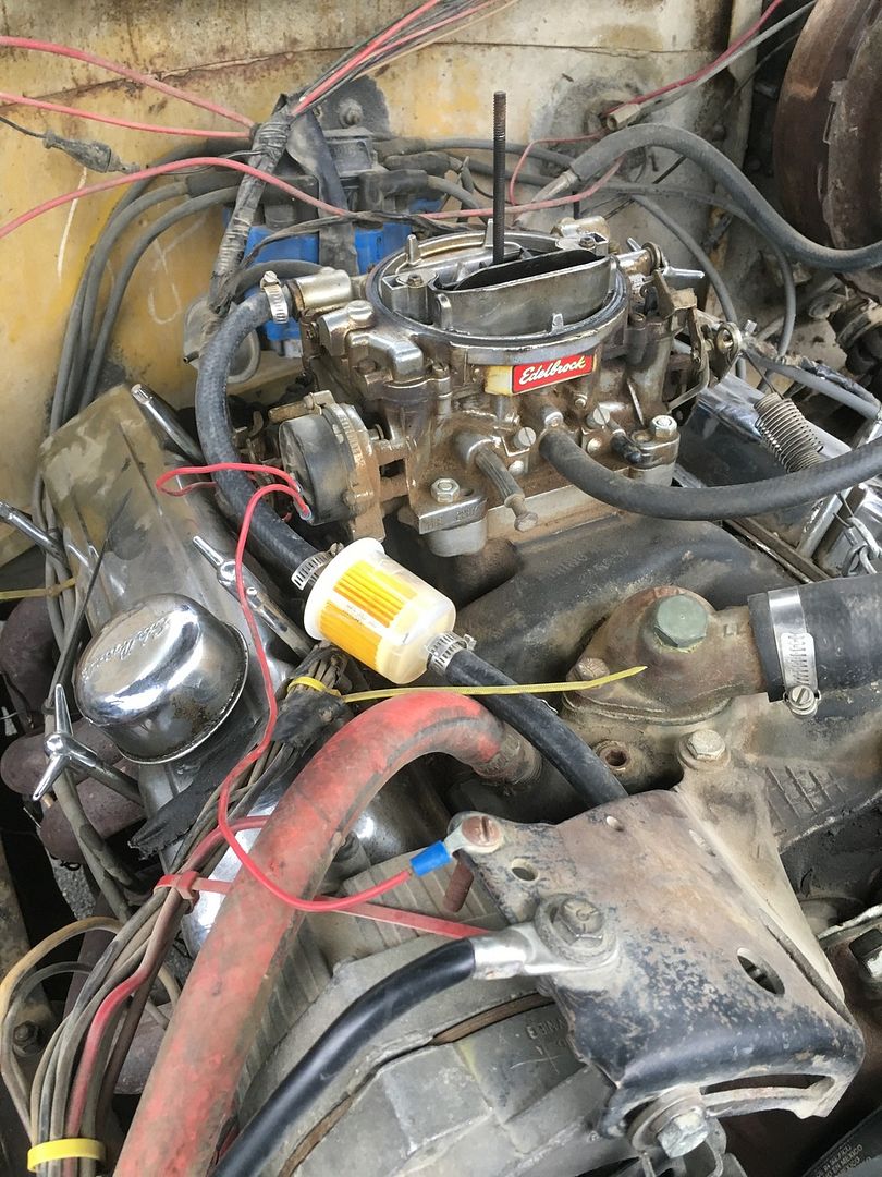

Got 73 k-20 with a 75 Chevy 350. Has an edelbrock carb I don't know much about besides electric choke. Everytime I cold start it, it fires up instantly no problems. Yet when ever i drive it any distance and get it hot and it sits for any period of time I have to crank on it for 4-10 seconds before it will fire up and then when it fires it will run like crap for a second and then clear up and drive fine. I can't figure it out, the choke plate is opening fine when hot. I ahve noticed sometimes the fuel filter will be completely full when I shut it off and other times half full.

Likely heat-soaking the fuel bowl, boiling the fuel, which floods the engine.
Once the float bowl drops, the fuel pump spring begins pushing the next load of fuel through the fuel lines into the carb.  Where it boils, and floods the engine.
When my truck is hot, I start it with the throttle all the way open to flood clear it.
You could try a heat shield, or a wooden carb spacer.
I notice you have headers - I do too.  This contributes to under-hood temps; not helping us.
This is one of the main reasons why I will be fuel injecting the truck this summer.

Looks like an Edelbrock 1406 (there should be a number on the pass front side of it right below the bolt to the manifold.  I run the same carb on mine.  Heat is likely your issue but how does it run otherwise?  Does it seem to run rich when it is running?
Typically those carbs only want 5-6 PSI of fuel pressure coming in and a mechanical pump can put off as much as 14 so a pressure regulator helps.  Also make sure you aren't pushing the pedal down before trying to start it hot, that should only be done cold.
The lighter colored metal peice between the Carb and the Intake is a spacer, and hopefully a squarebore to spreadbore adapter, if it's solid aluminum, changing to a phenolic (plastic) one can help against heat-soak too
I also notice that the Vacuum Advance is unplugged on your distributor, Someone may have changed the timing because of that, which could cause hot start issues.

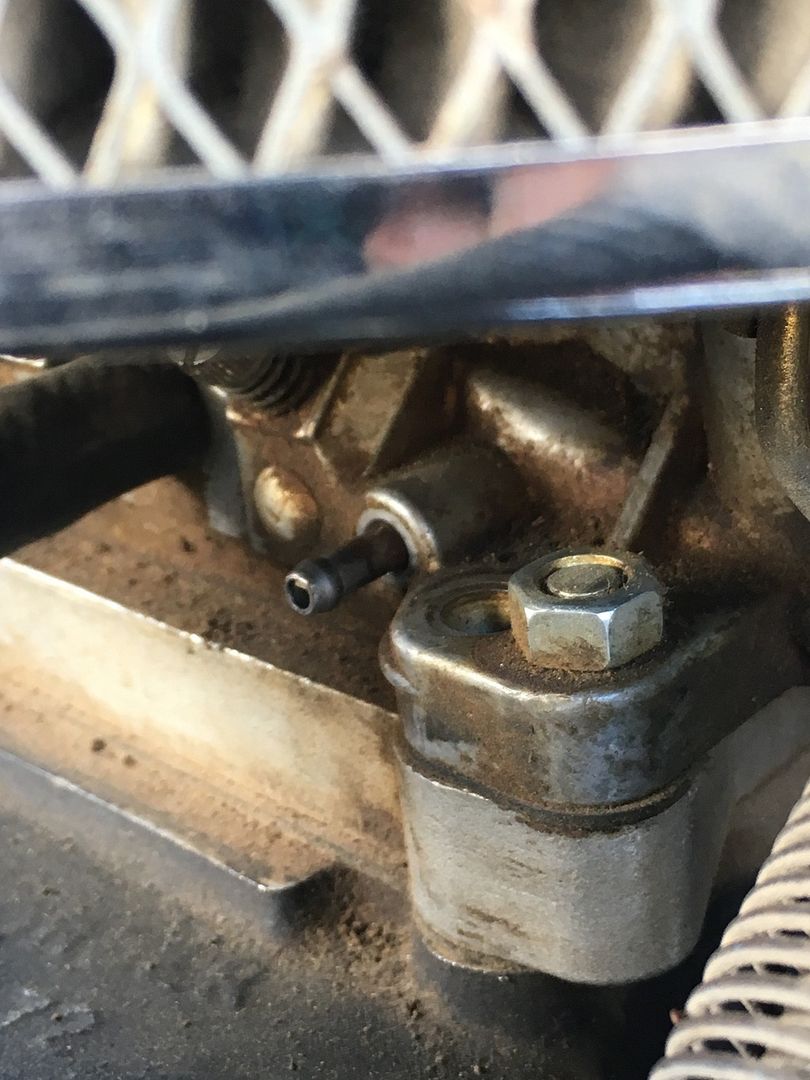

Thanks so much to everyone for the help I think I have enough info to figure it out now, only question I just want to make sure that I would plug the vacuum advance into this port on the driver side bottom of the carb correct?
Re: Hard too start hot sometimes
« Reply #14 on: April 20, 2016, 11:41:05 pm »
usually its at the base of the carb but start the motor and put your finger over the port. if theres vacuum then its manifold if no vacuum its ported
