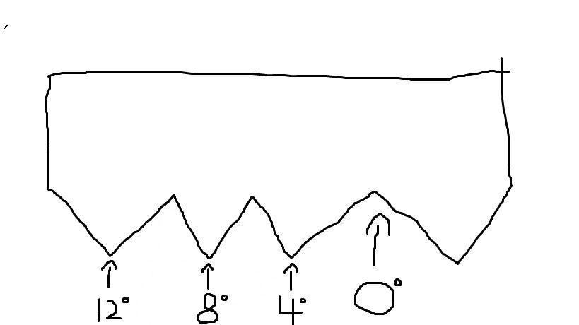

My timing tab and balancer don't have the numbers like what I see on Youtube. This is what I have, and from my understanding the middle of the wide notch is 0, the point of the next notch is 4, and the next one is 8, and so on.

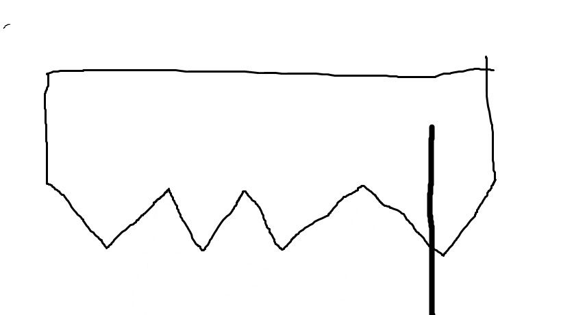

Before I started turning the distributor, this is what it was set at

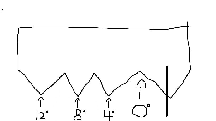

I set the timing to where it was before, for now. Like this:
