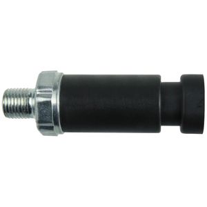

DO NOT CUT ANY MORE CONNECTORS OFF.  It's counterproductive.
This is the drawing from the 1985-1991 parts book showing where these engine senders are located on the 1987 LO5 & LO3 V8
The GM 10069218 gauge sender is just above the oil filter See number 25 in the above parts book drawing.  Number 9 would be in the same location for a base model warning lamp dash.
The GM 25036938 TBI Fuel Pump Oil Pressure Switch is number 22 in the above drawing near the distributor.
Don't throw out the plug you cut off it's OBSOLETE and you can re-use the shell.  If you threw it out you'll get to scrounge one off a donor.
The part # is Delphi 12052384.  Get a wiring guru with the proper tooling, if that's not you, to extract the terminals from your plug, install new Delphi Metripack 150 or 280 terminals & wire seals on 8" sections of 16ga SXL wire, then insert the new terminals into the connector making it a repair pigtail.  They can then solder or crimp and heatshrink the pigtail to the cut off wires on your harness.

I replaced the plug hooked it up and bought a new switch looks like I need to replace the gauge sending unit also because nothing works yet.

« Reply #28 on: December 26, 2016, 06:00:16 pm »
Great day !! The oil gauge is now working and all is well. With the temp and oil gauges working now the amp gauge is left. Hopefully it will be easier than the oil was.
