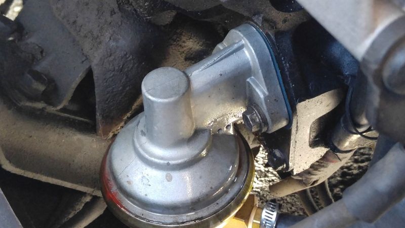

Well i figured out my problem, previously i would check the engine bay when the truck was already warmed up, well i checked on a cold start and i found my fuel pump was leaking at the weep hole. Good thing it has warranty.

I had a feeling that was what you would find.  Let a drop of oil from the engine dipstick land on a clean, dry fingertip and watch it.  If it holds together in a tight circle, it's okay.  But, if it tracks out along your finger ridges, the oil is saturated with gasoline and needs to be replaced, along with a new oil filter, after the fuel pump is replaced.
