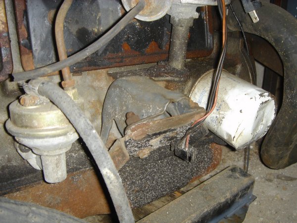

Offline roundedline
  • Posts: 2228
Re: 1980 454 to 292 Engine Swap
« Reply #3 on: December 13, 2005, 09:49:00 pm »

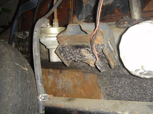

Thanks for the photo Chris but it's the frame side of the engine mount that I'm trying to find the placement of.  Thats the bracket that bolts to the frame and the crossmember on the passenger side.  John.
Offline roundedline
  • Posts: 2228
« Reply #5 on: December 15, 2005, 04:17:00 pm »
