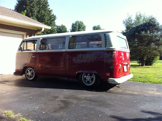

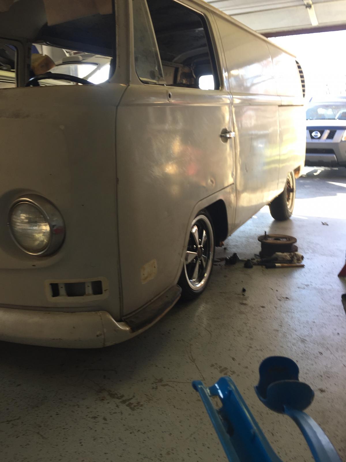

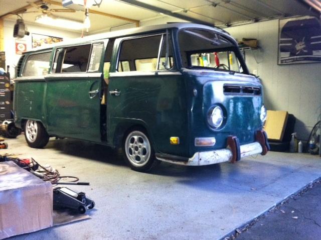

Btw here is a few pics of what I do in the vw world

I have 4 squares, 81 C30 Cab and chassis with a steel flat bed, 85 C20, 85 C30 in my picture and a 86 C10

This Is my current project but I don’t have any recent pics 70 panel these are kinda rare because of the chicken tax. I am building a small mini stroker for it now. 74mm forged crank and 88mm forged pistons with a very mild street cam. FYI a stock crank is 69mm and stock pistons are 85.5mm also using shorter rods so it will be the same length as stock without shims.
