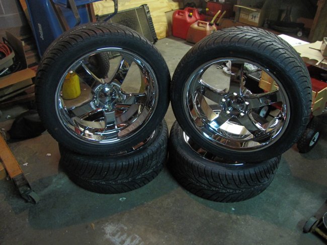

Tuesday, Dec 14th, 2010:Ordered some 275/40/20's for the Boss Wheels that came in.  Hope to pick them up this week.

Thursday, Dec 16th, 2010:Picked up the wheels and tires.
These will probably end up on the Wifes K5 when it is ready though...

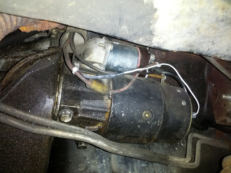

Saturday, Nov 19th, 2011: Had an issue with a loose connection on the starter solenoid and when I went to fix it I found the Knock sensor wire was rolled up around the transmission lines from the Previous Owner.  I haven't ever been under this thing to "inspect" thoroughly it but the connector was broken/melted and the sensor is toast.  Plans to splice a new connector one if it stops raining here...

Monday, October 8th, 2012: Haven't been driving this as much, but recently took it for a drive and had the power die, crawled under to see what was wrong and the power wire was loose.  As I was tightening it I noticed a wire twisted around the transmission lines.  I found that it was the Knock sensor.  It has always been throwing codes and the SES worked intermittantly.  I finally got to repairing it after getting a new connector.

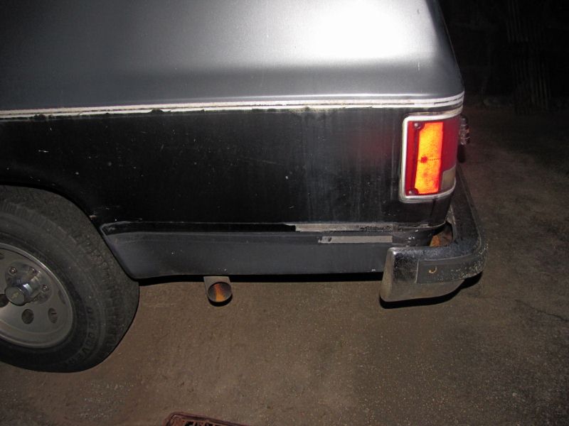

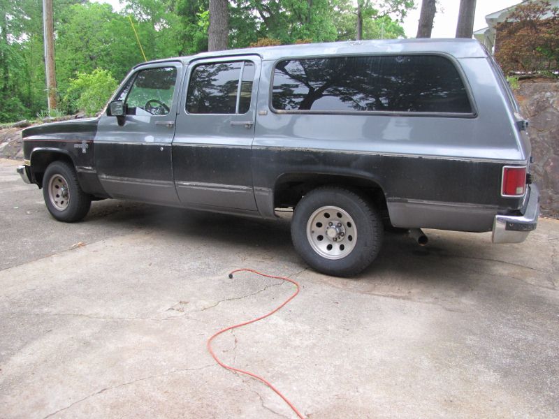

Saturday, April 27th 2013: Removed the bend up rear bumper and put one on there that was in a little better shape.  Then proceeded to pulled all of the side molding off.
Sunday, April 28th 2013: picked up an eraser to remove the residue from the side molding removal got started but didn't get far.

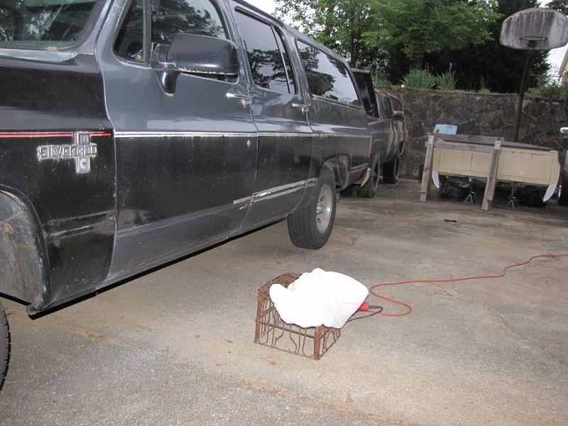

Wednesday, May 1st 2013: Started back on removing all the glue from the side got all done but a littel before it got too late

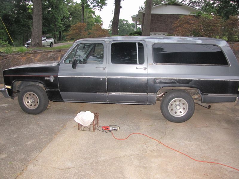

Saturday, May 4th,  2013: Finished the Drivers side removal, started  on removing all the glue from passenger side.
Sunday, May 5th,  2013: Finished the passenger side. and pulled the rear door panel on the cargo door to fix the hit or miss lock mechanism for the rear doors.

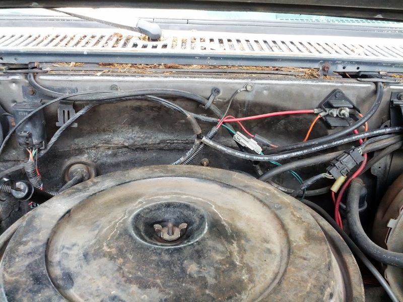

Monday June 3rd, 2013: After a couple years and not driving it as much the AC finally ran out of cool.  Added about a 1lb of 134A to it and it is working much better.  Also during a stint in some routine maintenance during the winter I found that the Vacuum hose for the AC was missing and the source capped off.  This ended the mystery on why the AC was not working and blowing everything down to the floor.

Sunday, June 16th, 2013: Got all the vacuum hoses sorted out and now the AC is blowing on both upper and lower levels and is blowing around 60 degrees.  You can see where it tees in the below pic.
