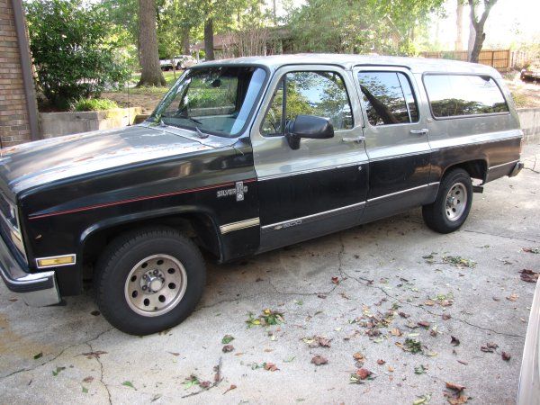

After our initial bout with the TBI on the Burb, we moved to the next project:  Exhaust
Sunday July 1st: we removed the rotted tail pipe, muffler and what appears to be the original AC cat.
Monday July 2nd we started piecing together a replacement exhaust.  I used one of the 3" tails from a leftover X pipe kit, the Magnaflow muffler off my Jimmy that is currently undergoing a TPI conversion and a portion of the 6.0L LS motor with the cat.  We completed the system that evening.
Then we moved to the next project:  Air Conditioning
We converted the Burb over to 134a over the past week.  Last weekend we found out why the AC wasn't working.  We dyed the system and immediately found the compressor was leaking out of the housing, so we picked up a new compressor.
Tuesday evening I removed the old compressor, cleaned up the Sepentine brackets and the front AC lines components were flushed out.
Saturday July 7th I reinstalled the compressor and pulled the rear portion apart and flushed the rear portion out.
Sunday July 8th we pressurized the system and found a leaky O-ring/seal replace it.  Vac'd the system and installed the 134a.  The rear system is Seriously blowing cold air, but it appears there is some clearance issues with the fan as it is grinding some (no headliner right now)
The front of the system appears to have some vacuum issues as half the cold air is going to the floor vents.

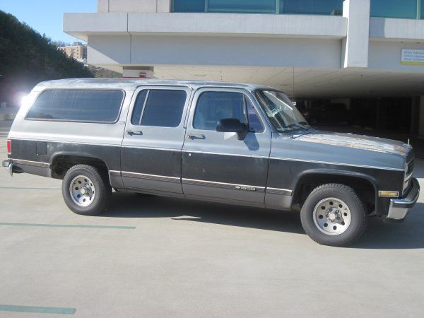

Bringing this one back up.  Within the last month I put the factory aluminum rims back on the truck and started driving it.  Also replaced the fuel pump and sending unit (with pics).  Also talked to a buddy about painting it this winter.  Gonna try and knock out some of the small issues off the list.
Broken ash tray, non working fuel gauge, removing old tint of the front windows, charging the AC again (not sure how far this will get with winter approaching), installing new carpet, more to come.
