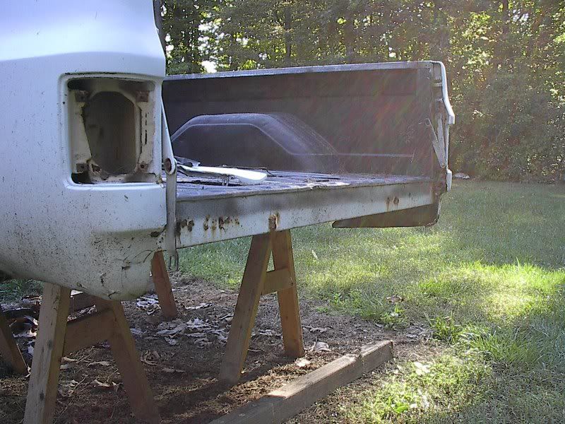

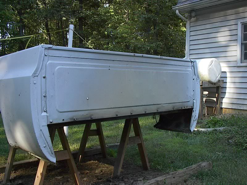

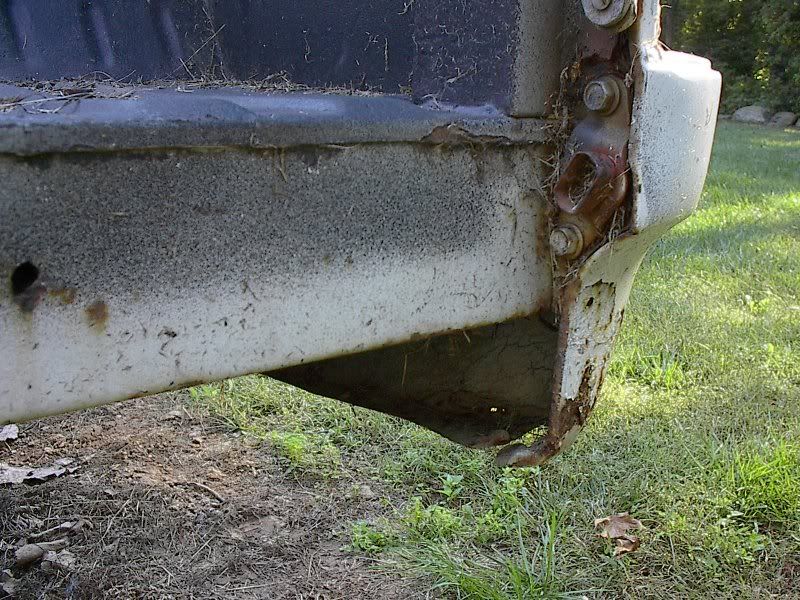

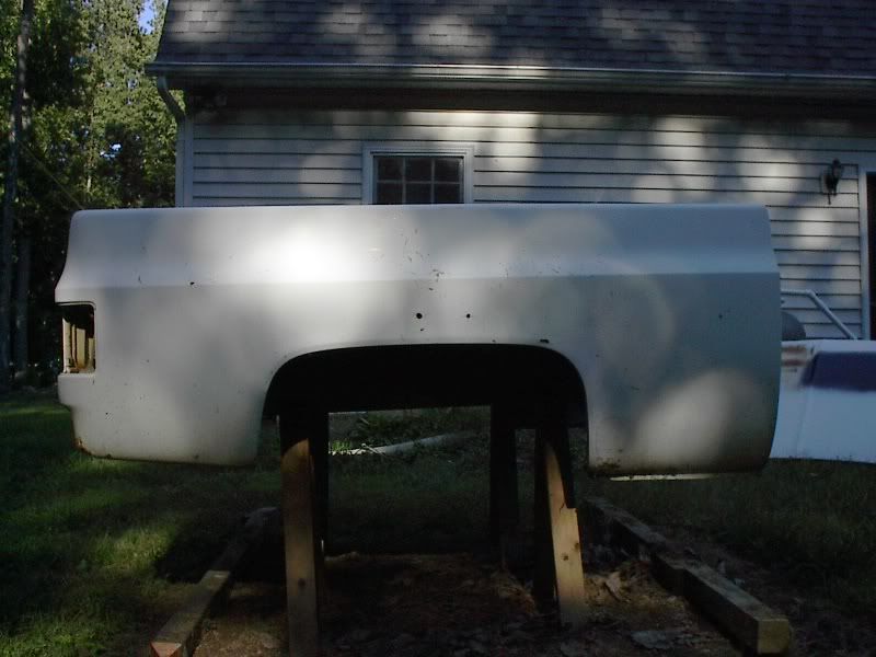

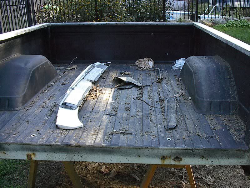

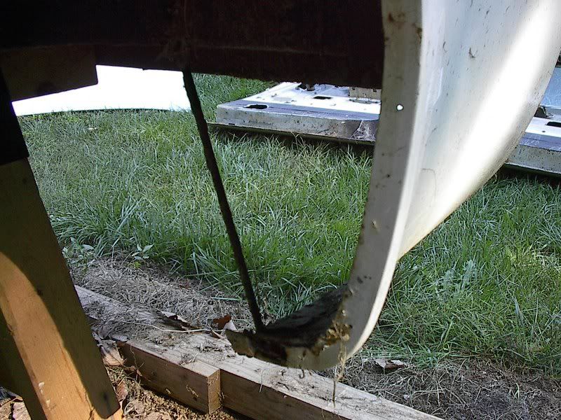

Ok - Here are some pics of the bed (I had to wait till I got home to get the pictures)
Here is the bed front many dents and dings:
Bed side - passanger with small holes above wheel well:
Rear pan with many rust holes:
The bed floor - dents and waves:
other photos:
Buckets and buckets of body filler used inside the wheel wells.  I could rebuild her, but it would take alot of panels and many hours of work.  What do you all think?  Is she worth it?
Does anyone know where I can get a short bed - fleetside or stepside - that is within 150 miles of Frederick, Maryland?

I'd be looking for a southern bed. If there's buckets of bondo inside the well wells, there's probably a bunch of bondo and rust under the paint as well. :'(

« Reply #8 on: September 20, 2007, 07:43:54 am »
Thats in good shape compared to some I have saved! Why do you want to replace the front panel? It looks pretty solid to me. You don't need to mount the bed to anything to take it apart. As far as bolting it together you could leave the front panel to the side panel bolts a bit loose for a little adjustment to match the cab. As far as the bottom to side bolts there is really no adjustment. As for your rear crossmember I would cut out the couple bad spots, sand blast it inside and out, and weld some patches in. Your quarters do look a bit shabby. Allot less work but more $ to just replace them. Haven't priced any out recently but last time I did they were going for about $400 to $600 each for after market ones.

 Yes those panels will work but you will need to get the ones for in front of the wheel and over the arch as well. You are looking at three panels per side $200 to $300 in patch panels give or take, plus allot of welding and a whole lot of body work on top of the patching you need to do on the rear cross member. Plus if the outside above the wheel is rusty I would put money on it that the inner arch is shot too. I would take the money you plan on spending on a new front panel, live with a few dings in it and put it toward some new rear quarters.

You could always spray a liner in the bed to cover up the dents inside.
