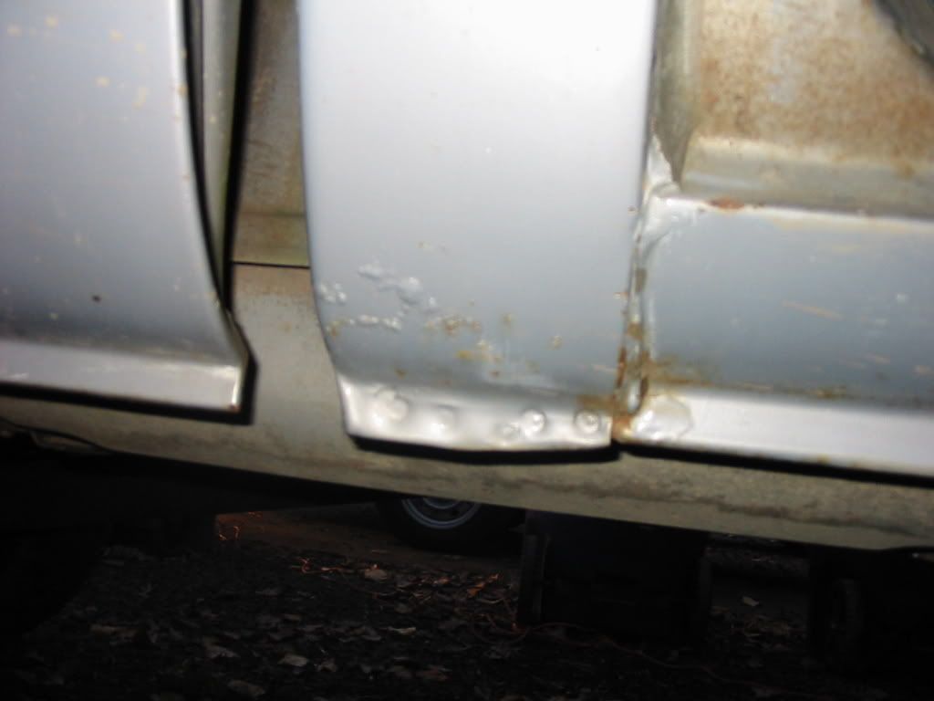

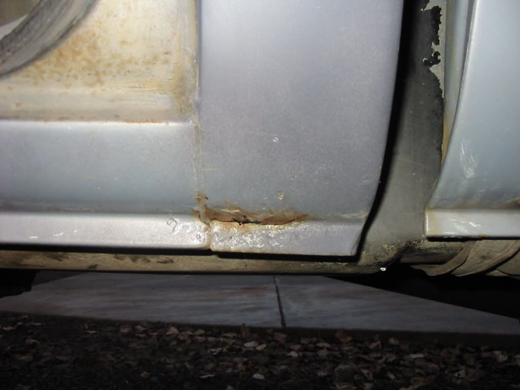

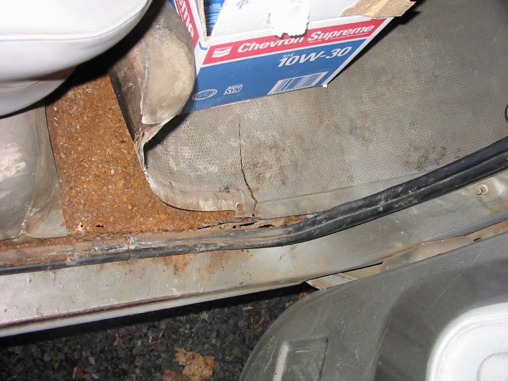

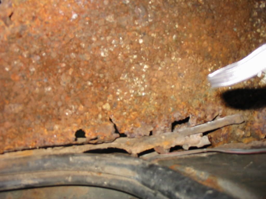

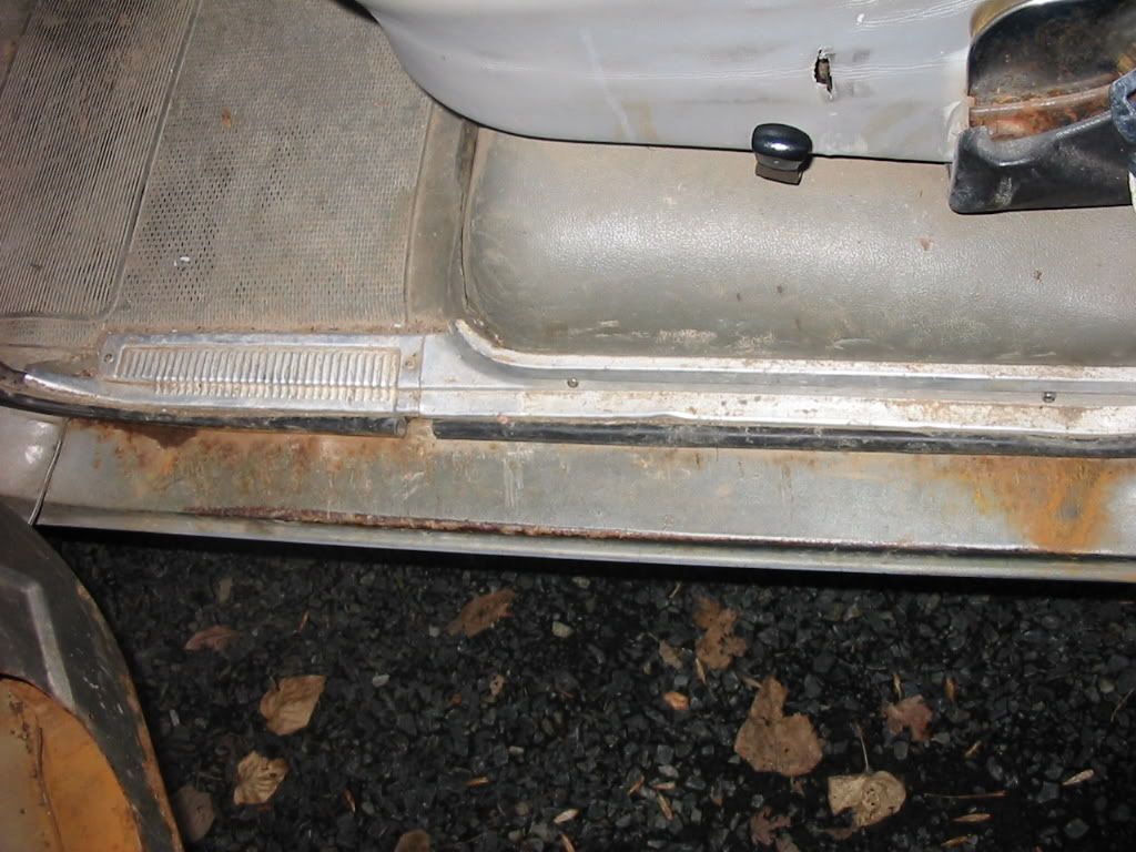

Both driver and passenger side floor boards need to be replaced.  But, the question is, do I need the whole cab kit?  I don't think I need the cab corners but I will let you decide.  Thanks
Driver side...not too bad.
Passenger side....ewww
Passenger side fender
1975 Chevy k20 6" lift 35" BFG MT's True Dual Exhausts Radical Cam
1980 GMC 2500 Parts Truck
Re: Need some body suggestions!!!
« Reply #37 on: November 24, 2007, 07:20:21 am »
If I were to look at this as a job, I would tell the customer you need cab corners, rockers, inner rockers, floor pan, possibly inner cab corners, or some sort of patch & possibly floor support.
Once you cut into it I would bet $ it will need everything.
 I think you will find that your cab corners have already been done once.

« Reply #38 on: November 24, 2007, 01:17:05 pm »
Quote from: Blazin link=topic=6474.msg35106#msg35106 date=1195910421
[/quote
yea those pinch welds look pretty messy to be factory, even for GM haha.

So, you think I need rockers for both sides?  The driver side looks fine to me, only looks like surface rust.  Anyway.  So, I pretty much need the cab kit (left and right) from this site?  Thanks

yea man, you need to get everything for both sides.  that truck has been repaired before and it really doesn't look to have been done right...you need to find someone who is good at welding in new panels and have it done right...
